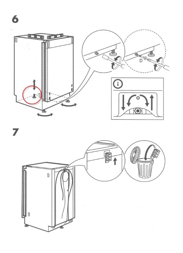

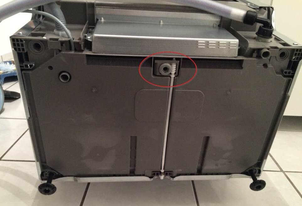

Does the red-marked part need to be pulled out, or is something else supposed to go there? I've already tried turning the front, but nothing happens.
According to the diagram, a leveling foot like the two at the front should be attached there. But there definitely wasn’t anything included.

zetterberg5 Dec 2014 07:53The base is missing; the screw adjusts the height. Was it missing?

IKEA-Experte5 Dec 2014 11:34Isn't the gray part the foot? The worm gear engages there, right? What do you observe when you turn the worm gear? Does it turn freely without engaging? Or does it skip, possibly because the foot was screwed in too tightly during installation?
WockBürste8 Dec 2014 11:18Hello,
The part can be unscrewed from the front side using a Torx screwdriver, which then releases a support foot at the spot marked in red. However, in my case, this support foot was very tight, so I first had to loosen it with pliers. After that, everything worked without any issues.
