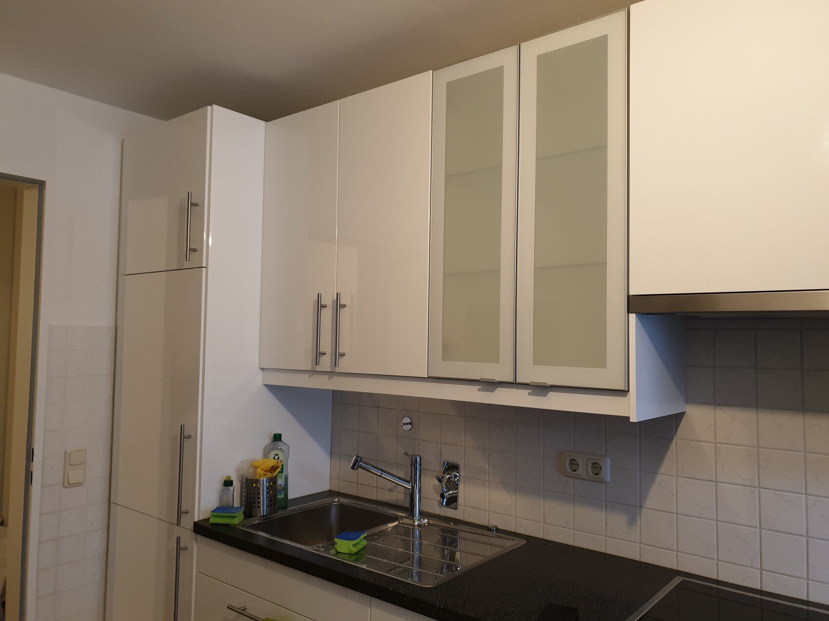

Unfortunately, I don't know if the kitchen is from Faktum, but I took a picture in case someone recognizes it.
Modern white kitchen with sink, glass fronts on upper wall cabinets, and tiled backsplash.
