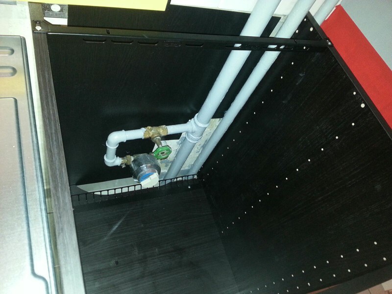

robi_aus_ffm20 Jul 2015 17:02hello,
I also had the "pipe issue" and built the cabinet around the pipe; with a bit of cutting, it was no problem. See the picture.
The countertop above was cut accordingly, and this way you save space.
The rear legs are not the black "Metod" ones but the screw-on type.
For the interior, you can either use Maximera drawers with reduced depth or cut the shelves to size.
Best regards, robi
Best regards, robi
Schmidti8220 Jul 2015 17:54@Sektionchef,
Thank you, now I at least have a rough idea of the cost and don’t have to calculate it manually.
I assume I can discuss this with the consultant when I order the kitchen.
@Robi
Thanks for the suggestion, but the water pipes in my case run horizontally along the wall, about 10cm (4 inches) above the floor.
I’ve even moved the base cabinets further forward in the planner so I don’t have to install any panels.
