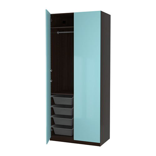

For my new apartment, I bought two Pax systems (2.36 m) (7 ft 9 in). All the carcasses are already assembled; the interior fittings are still beside them, and I’ll get the doors sometime next week. However, I would like to install the interior fittings already.
Now to my question:
I assume that the doors require specific holes in the carcass for mounting. However, I haven’t been able to find exactly which holes are needed. Specifically, it concerns the Fardal doors on one carcass and the Vikedal doors on the other. Can someone tell me which holes I need to leave open in the carcasses?

IKEA-Experte18 May 2016 12:29Hello, you can use the zoom function on the images as a reference (and hope that the measurements are correct):
