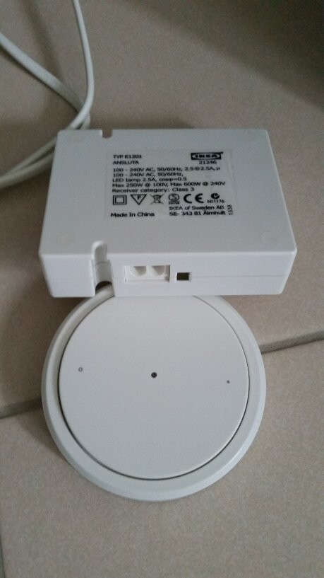

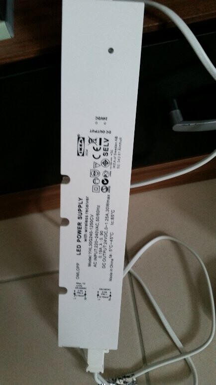

I found a kit for my kitchen in the basement. It includes
- Omlopp Power Supply
- Ansluta Remote Control
I connected the Omlopp power supply and lights as usual, and they work fine. Now Iâm unsure how to integrate the remote control into the system or if Iâm missing something.
Here are some pictures
In picture 1, the remote control and a receiver that doesnât have a cable. Picture 2 shows the power supply with a button that can be pressedâI think itâs for calibrating the receiver. But how do I get everything to work?
Thanks a lot for your help

Steve_29738 Jul 2016 17:12The small Ansluta box has an input for power.

That was my idea, but I still donât understand the purpose. The small box would turn the large one on and off if I connect it before.

IKEA-Experte8 Jul 2016 17:39That was my idea too, but I still donât understand the purpose. The small box would switch the large one on and off if I place it in front of it.Yes, and with that, you switch everything on and off. If you want to control the transformer directly, youâll need to buy the new remote control.
The holes are closed for safety. The plug of the Ansluta connection cable presses against them.
Steve_29738 Jul 2016 17:40Okay. So I still need to buy the cable. Or alternatively, a different remote control.
I
IKEA-Experte8 Jul 2016 17:42Buy both, try them out, and then return one of them.
I
IKEA-Experte8 Jul 2016 17:44If you still have the receipt, try returning the ANSLUTA combination.
Steve_29738 Jul 2016 18:00Ok.
Thank you very much for the help. I'll see what I can do. Unfortunately, I no longer have the receipt.
