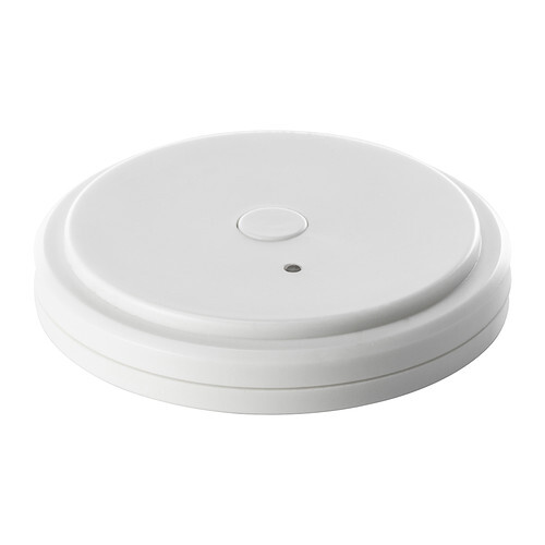

I found a kit for my kitchen in the basement. It includes
- Omlopp Power Supply
- Ansluta Remote Control
I connected the Omlopp power supply and lights as usual, and they work fine. Now I’m unsure how to integrate the remote control into the system or if I’m missing something.
Here are some pictures
In picture 1, the remote control and a receiver that doesn’t have a cable. Picture 2 shows the power supply with a button that can be pressed—I think it’s for calibrating the receiver. But how do I get everything to work?
Thanks a lot for your help

IKEA-Experte8 Jul 2016 16:05S
Steve_29738 Jul 2016 16:07I found the same information, so only the name was changed.
According to that, it should work.
But what do I want with the box that only has one power connection? This system is confusing.
I
IKEA-Experte8 Jul 2016 16:14So, it does not have to work.
First, there was the Ansluta remote control with the box.
Then, the UTRUSTA remote control was added.
After that, only the UTRUSTA remote control remained.
Later, it was renamed to ANSLUTA and is different from the original ANSLUTA.
Steve_29738 Jul 2016 16:28But then it’s also not correct to have a new name with the old function.
And the small box? Its purpose is still a mystery to me. It’s a connection for electricity. Nothing else, except for the button.
I
IKEA-Experte8 Jul 2016 16:39Same function as UTRUSTA, but not like "Ansluta alt."
With the box, you connect the Grundtal or RATIONELL lighting using the ANSLUTA connection cable. Back then, they should have sold you the UTRUSTA remote control for the Omlopp transformer.
I
IKEA-Experte8 Jul 2016 16:45You can try connecting the OMLOPP transformer to the box using the ANSLUTA connection cable so that the box controls the power supply to the transformer.
