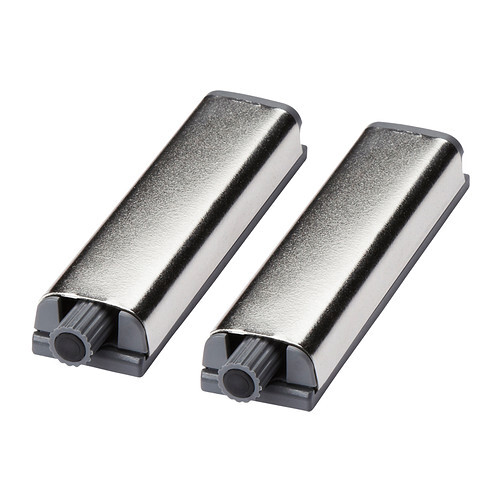

robi_aus_ffm26 Feb 2017 20:22You can also leave out the handles entirely and use push-to-open mechanisms.
I used these on the bottom drawers because our cat otherwise opens them ☺.
However, you will need to push the last few centimeters (inches), since the soft-close function only works up to the push-to-open device, which then needs to be reset.
Best regards, robi

IKEA-Experte26 Feb 2017 21:41Is there still space for fastening with 10cm (4 inch) high drawers?
R
robi_aus_ffm27 Feb 2017 09:04I just took a look at my 10cm (5 inches) internal drawers. The space is really tight, but above the drawer there is just enough room on the left and right sides for it to fit.
