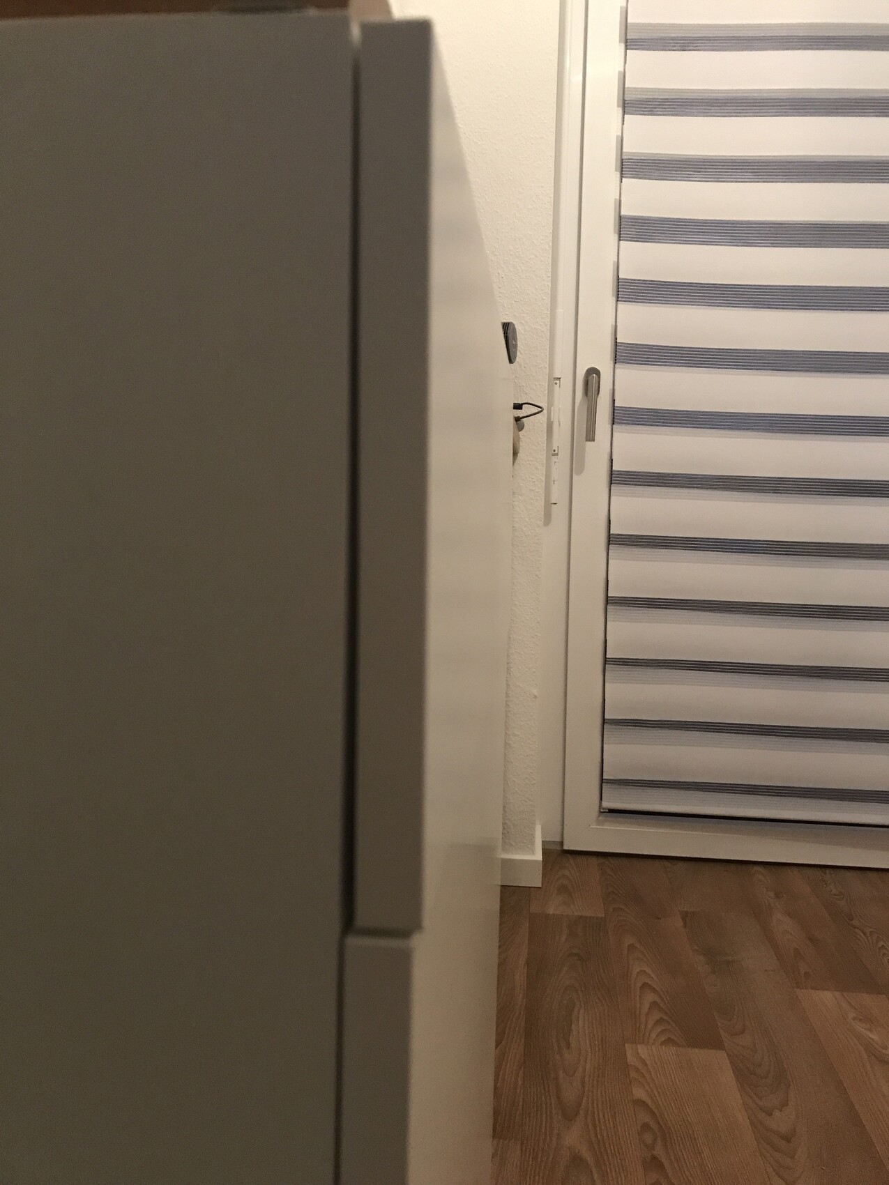

I think I’m going crazy. Can someone help me understand why this drawer fits almost perfectly at the top but gaps at the bottom? I can’t figure it out.

Do the drawer slides on the cabinet seem slightly angled? Try loosening all the screws and push the rail up at the back and down at the front while fastening it. Alternatively, tighten the screws on the bottom of the drawer a bit more. The drawer might also not be properly engaged with the tracks at the back. To check this, open the slider and press something sturdy against the metal hooks of the rail from behind while gently trying to push the slider forward...

I would guess that you didn’t properly snap the front into place during assembly.

Could be that way too, yes

Take the drawer out again, check if the runner is properly positioned and if the front panel is securely locked in place – but I suspect that you can easily adjust this using the small adjustment screws on the drawer itself.
