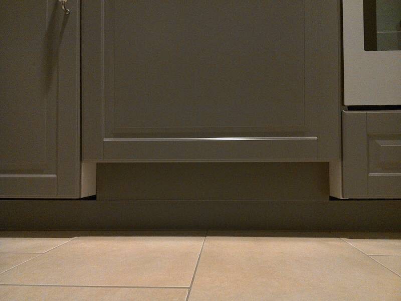

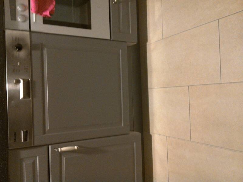

Unfortunately not, but when I got home, I remembered where the problem with our solution lies. Since the control panel for the semi-integrated model is mounted on the outside, we have a 60 x 60 cm (24 x 24 inches) blank panel attached. However, because the control panel is not 20 cm (8 inches) high, the front panel does not extend all the way to the bottom. The "missing" 8 cm (3 inches) is actually what allows the door to open at all. Otherwise, it wouldn’t work!
Haha, tablet! So, here are some pictures:
Eric
Eric

IKEA-Experte29 Apr 2015 13:50Thank you for the pictures. Personally, I would prefer ERSÄTTARE for the semi-integrated model.

IKEA-Experte29 Apr 2015 15:29The front would align at the bottom with the neighboring fronts.
