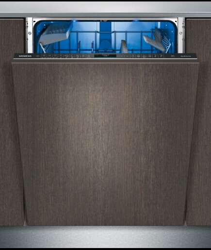

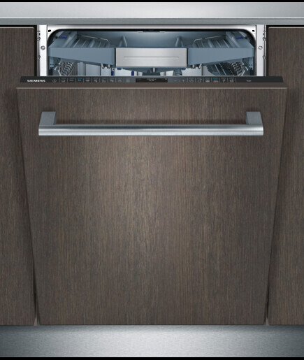

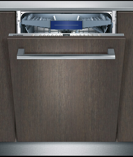

Regarding dishwashers, I did a bit more research on the Siemens website (maybe interesting for future reference).
The following three dishwashers are XXL models with variable hinges:
I have now decided on this one:
SX758X06TE
SX878D04PE
SX736X03ME
Thank you, IKEA expert, for your patience and valuable tips!
SX758X06TE
- Energy efficiency rating: A+++
- Energy consumption 237 kWh/year based on 280 standard cleaning cycles with cold water filling and power consumption in standby modes. Actual energy consumption depends on how the appliance is used
- Water consumption 2660 liters/year based on 280 standard cleaning cycles. Actual water consumption depends on how the appliance is used
- Energy consumption in Eco 50°C (122°F) program: 0.83 kWh
- Power consumption off / standby: 0.5 W / 0.5 W
- Water consumption in Eco 50°C (122°F) program: 9.5 liters
- Energy consumption with hot water connection in Eco 50°C (122°F) program: 0.60 kWh
- Water consumption in Auto 45-65°C (113-149°F) program: from 7 liters, depending on soil level
- The data sheet values refer to the Eco 50°C (122°F) program. This program is suitable for normally soiled dishes and is the most efficient in terms of combined energy and water consumption
- Program duration in Eco 50°C (122°F) program: 195 minutes
- Drying efficiency rating: A on a scale from G (lowest efficiency) to A (highest efficiency)
- Noise level: 42 dB(A) re 1 pW
- Noise level in Silence program: 40 dB(A) re 1 pW
- Capacity: 14 place settings
- Duration of the non-off state: 0 minutes
SX878D04PE
- Capacity: 13 place settings
- Energy consumption 234 kWh/year based on 280 standard cleaning cycles with cold water filling and power consumption in standby modes. Actual energy consumption depends on how the appliance is used
- Energy consumption in Eco 50°C (122°F) program: 0.82 kWh
- Noise level in Night program: 40 dB(A) re 1 pW
- Fully integrated
SX736X03ME
- Energy consumption 266 kWh/year based on 280 standard cleaning cycles with cold water filling and power consumption in standby modes. Actual energy consumption depends on how the appliance is used
- Energy consumption in Eco 50°C (122°F) program: 0.93 kWh
- Power consumption off / standby: 0.1 W / 0.1 W
- Energy consumption with hot water connection in Eco 50°C (122°F) program: 0.70 kWh
- Program duration in Eco 50°C (122°F) program: 210 minutes
- Noise level: 44 dB(A) re 1 pW
- Noise level in Silence program: not available (A) re 1 pW
