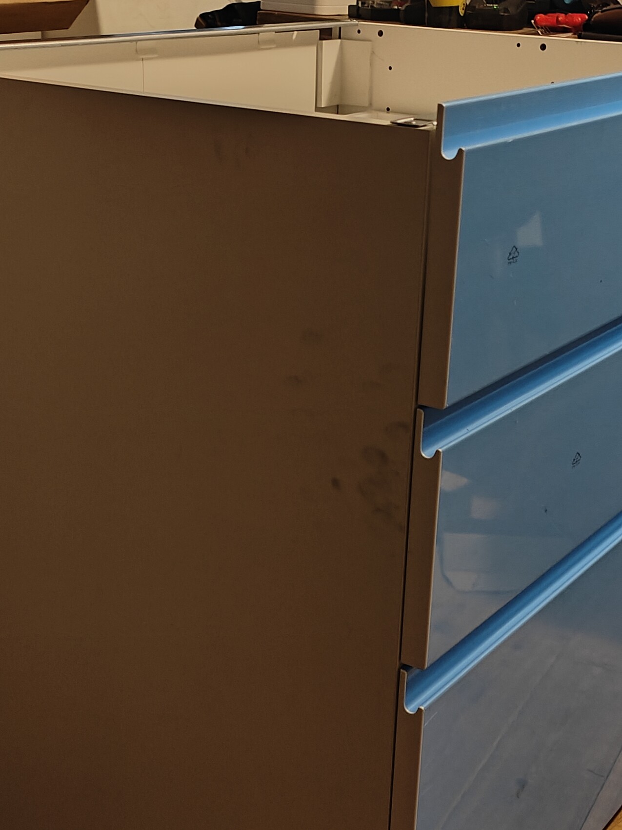

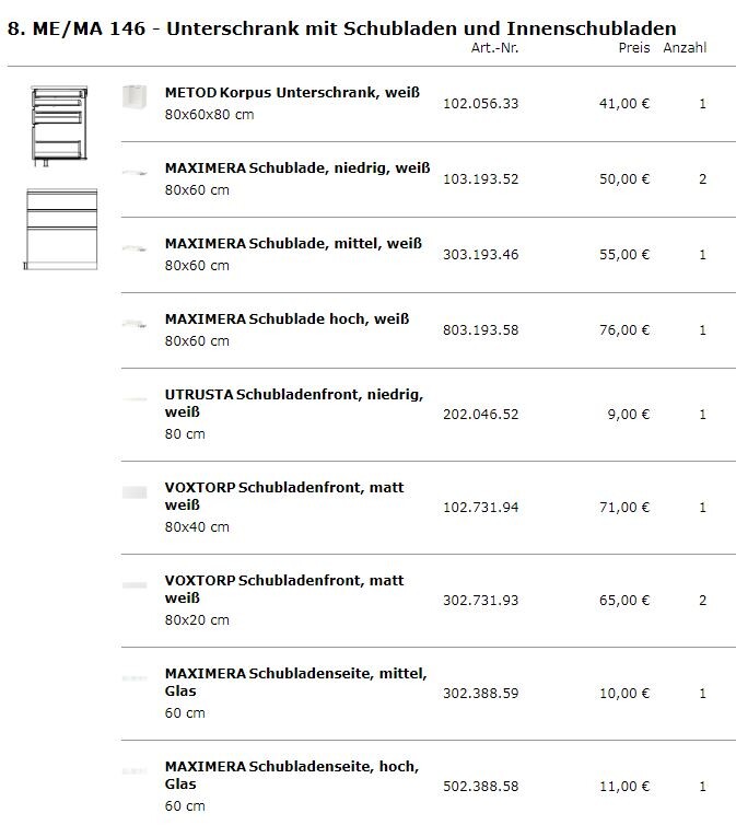

I have assembled the Metod frame ME/MA 146. I’m currently struggling with installing the drawers. They are the correct drawers, but they don’t fit properly; they stick out at the top. I don’t know what I did wrong. I can’t push them in any tighter or deeper. See the picture. The parts list provided by Ikea is also included.
Can someone help me with this? Thank you very much!

Bertram10019 Apr 2024 22:35mientje schrieb:
I have assembled the Metod carcass ME/MA 146. I’m struggling with installing the drawers. They are the correct drawers, but they don’t fit properly; they stick out at the top. I don’t know what I did wrong. They cannot be moved closer together or pushed back further. See the picture. The parts list provided by Ikea is also included.
Can someone help me with this? Many thanks! This is probably a common issue: the bottom drawer is installed differently than the others. The drawer slides are attached using a different set of holes. The instruction manual includes a separate page for this.
