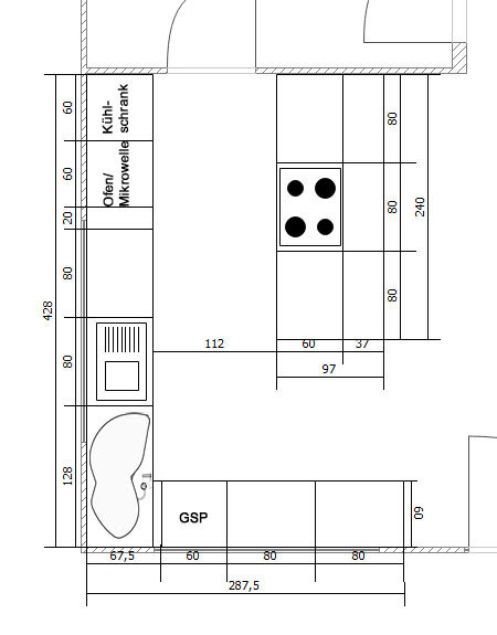

daniels87 schrieb:
And that is less wasted space then?
Just try googling "Why blind corners are good corners."
I also chose blind corners simply because the corner base cabinets are so bulky (especially with a carousel). While they may be slightly better for space utilization, they are expensive and delicate.
daniels87
14 Apr 2016 14:03
Neige schrieb:
You can definitely fit what’s stored in the corner carousel of pots and pans into one, max two drawers of an 80cm (31½ inch) pull-out cabinet. Plus, it’s more convenient to take items out of a drawer. The mechanisms of carousels, magic corners, and similar systems are expensive and quite delicate.
For me, that’s a reason to avoid these cabinets and instead prefer a blind corner cabinet.
I also trust the IKEA carousel mechanisms the least. The low price of these base cabinets doesn’t come without a reason. I have already converted several of these into standard cabinets because replacement parts for the mechanism were just too expensive for customers.
A blind corner plus an 80cm (31½ inch) base cabinet is also wider than a corner base cabinet.
That would be the combination of a blind corner plus a 60cm (23½ inch) base cabinet.
In what way are they delicate? Do they break easily?
Caspar2020
14 Apr 2016 14:12
For a blind corner, I need 10cm (4 inches) on each leg side.
daniels87 schrieb:
Blind corner + 80cm (31.5 inches) base cabinet is also wider than a corner base cabinet.
It depends. If we're talking about a corner cabinet with a 3/4 carousel, the corner cabinet extends easily another 30cm (12 inches) around the corner.
If you choose the ones with pull-outs, you only get a 1/2 carousel. And that is even less practical.
daniels87
14 Apr 2016 14:20
just like in the picture.
Kitchen floor plan with sink, oven, microwave, stove, refrigerator, dishwasher, cabinets.
