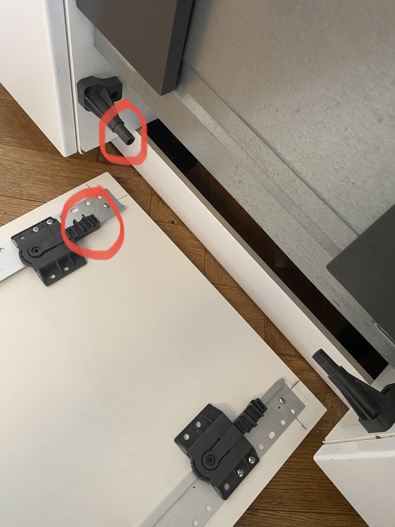

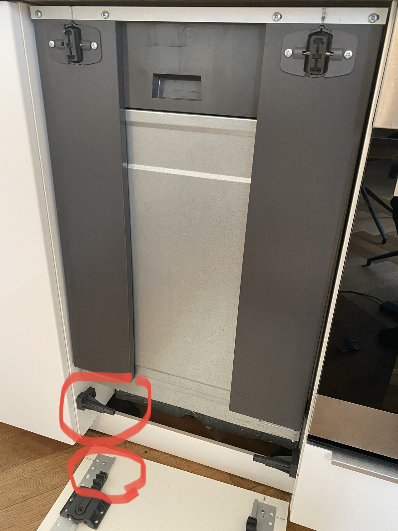

the front panel of my IKEA Hjälpsam dishwasher suddenly comes off the lower hinge of the Behjälplig rail every time I open it (see photos). First on the left side, then on the right.
While researching my issue, I read several times that this rail (and apparently I also have the previous model) is not very good, or in some cases possibly even a design flaw. Unfortunately, I still haven’t found a solution to my problem.
Does anyone have any ideas on what I can do? I would appreciate any advice.
Max

i_b_n_a_n16 Sep 2021 17:41
Hi. Possibly the front panel hits an edge at the bottom when pivoting and is thus pushed out of alignment? I noticed this during the installation of the last Ikea dishwasher front.
max1904
16 Sep 2021 17:50
No, there is no edge pressing – I have already checked.
max1904
17 Sep 2021 09:56
Hello Steffi,
WOW, that really looks like a suitable solution. The clips actually encircle the axle, unlike my "old ones." I’ve just ordered them and will try them out tomorrow. Thanks!
Max

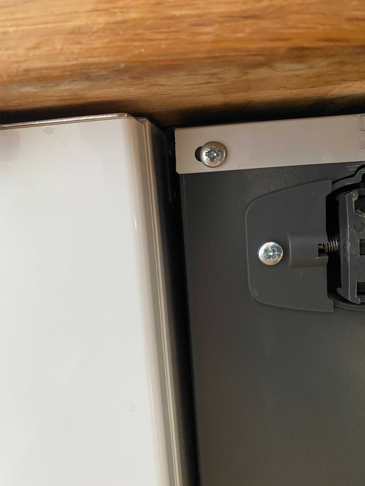

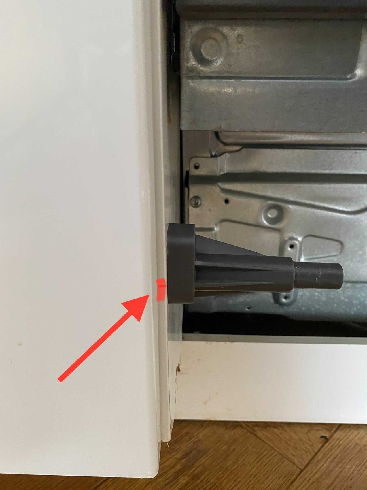

max1904
21 Sep 2021 13:03
Unfortunately, that was not the solution to the problem :-( Upon closer inspection, I realized that the edge on the left is actually pushing the front panel out. However, why this suddenly started happening from one day to the next is a mystery to me. Unfortunately, I also don’t know how to fix this issue. Does anyone have any ideas?
