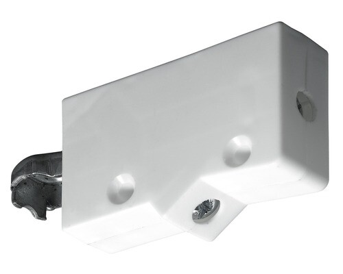

From the hardware store, I only know
together with
Overall, this tends to be more expensive, but using the METOD rail requires that you can get the METOD hangers as spare parts. Other uses, meaning not as spare parts, are not intended, so a furniture store may not want to order these parts and might refer you to an outlet or the hardware store.
together with
Those are exactly the ones I looked at in the hardware store as well.
The problem is that the wall is 1. uneven and crooked, and 2. the pipes aren’t clearly detected even with a stud finder (old building). To get a good result, using a rail like that is the most practical option, and it gives me more flexibility when drilling the holes. I’d rather invest the 30€ (about $32) than risk drilling into a pipe or having the cabinets hang crooked on the wall. 😉
