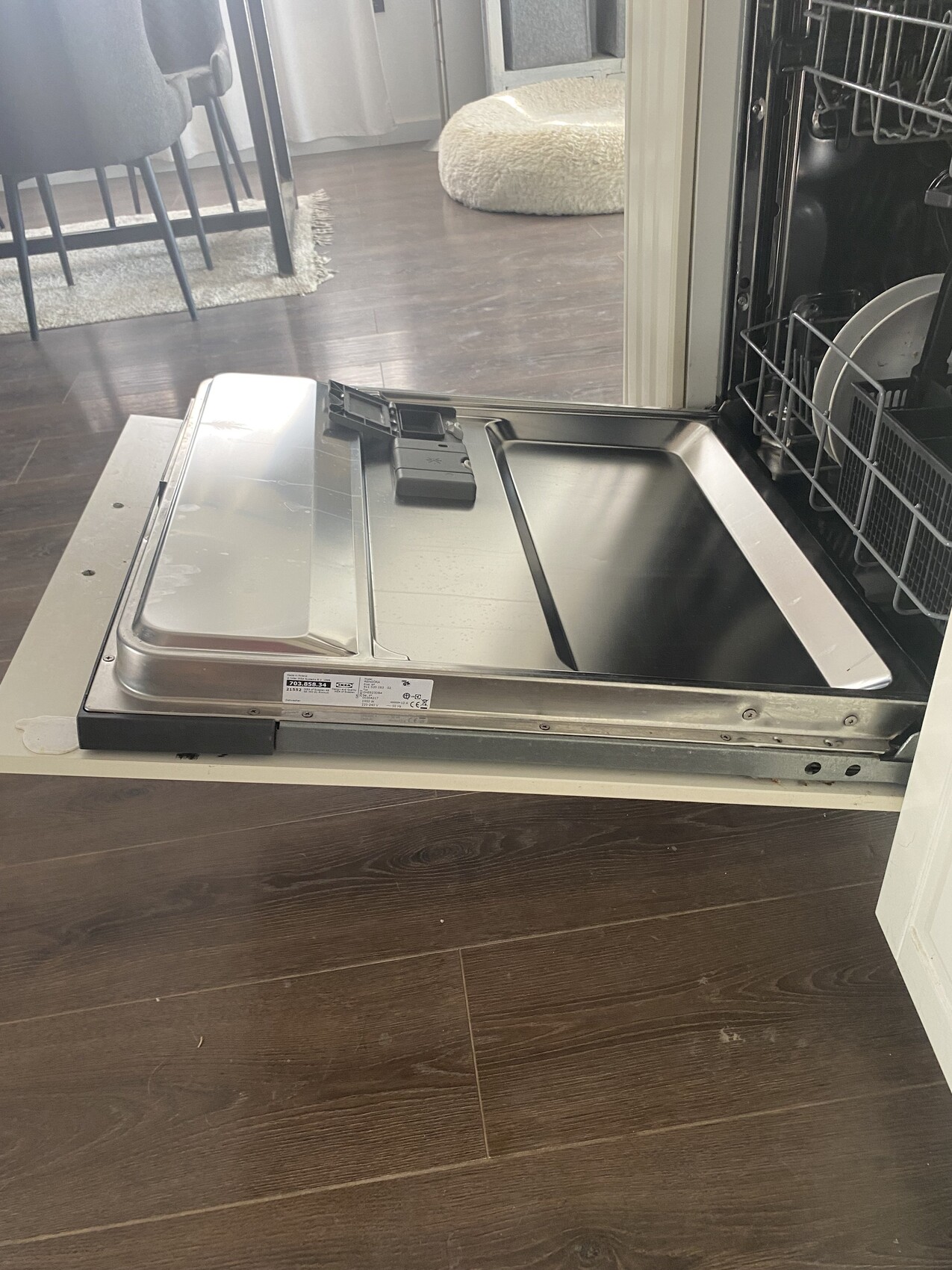

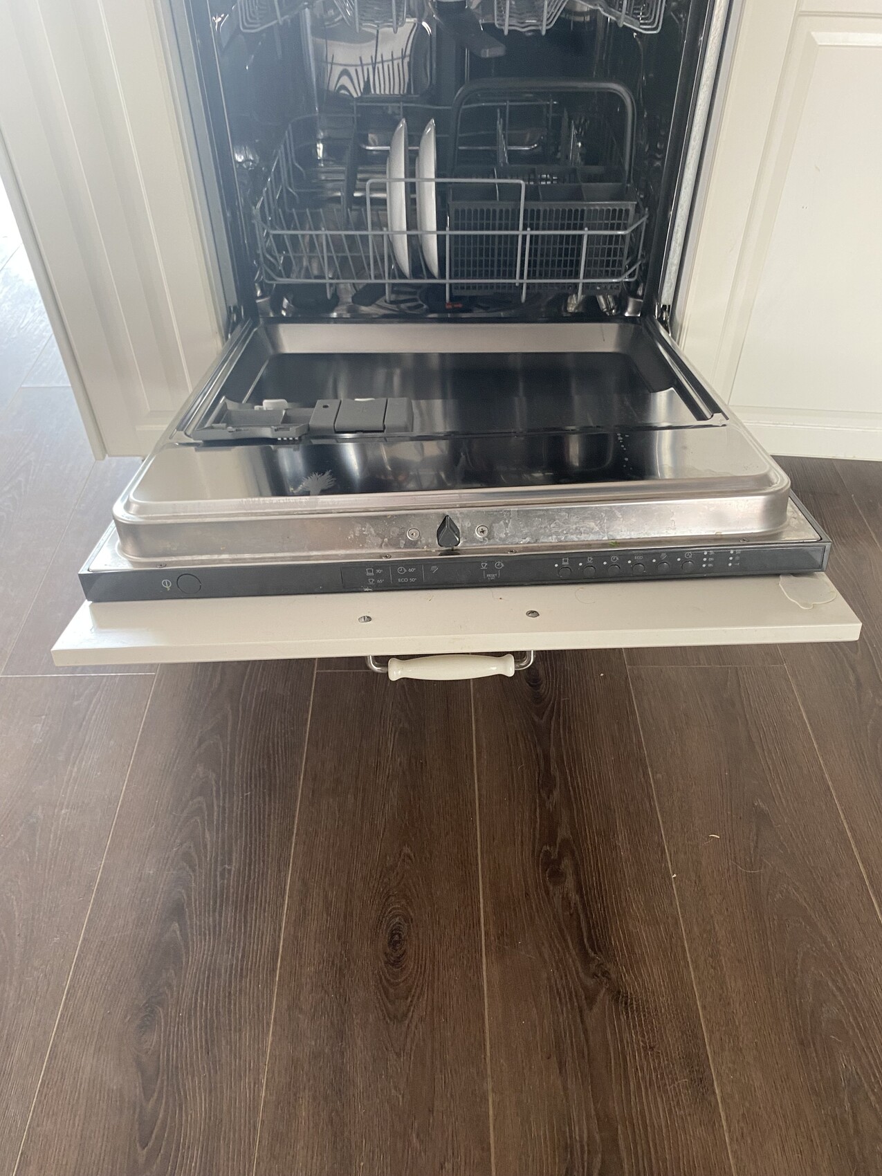

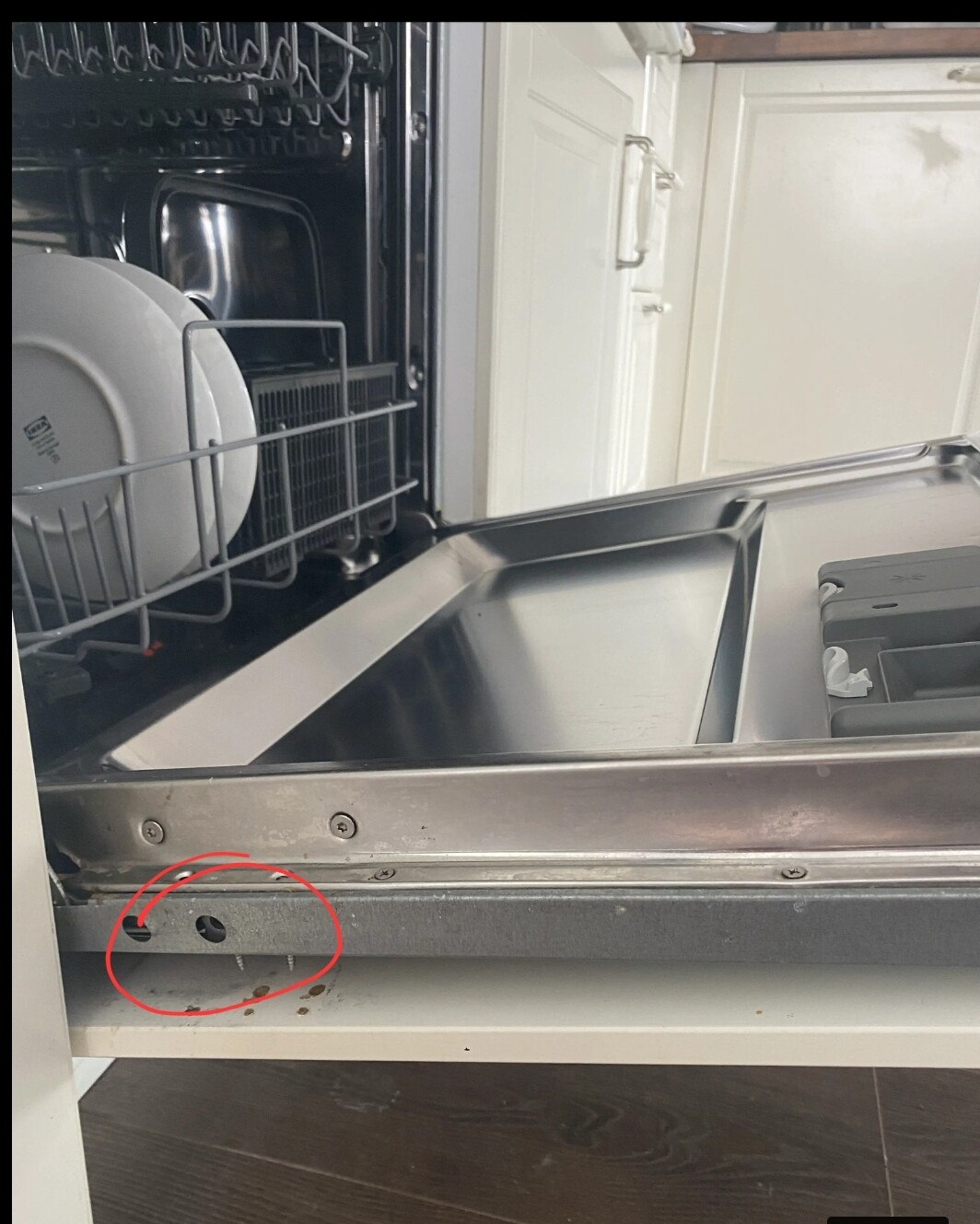

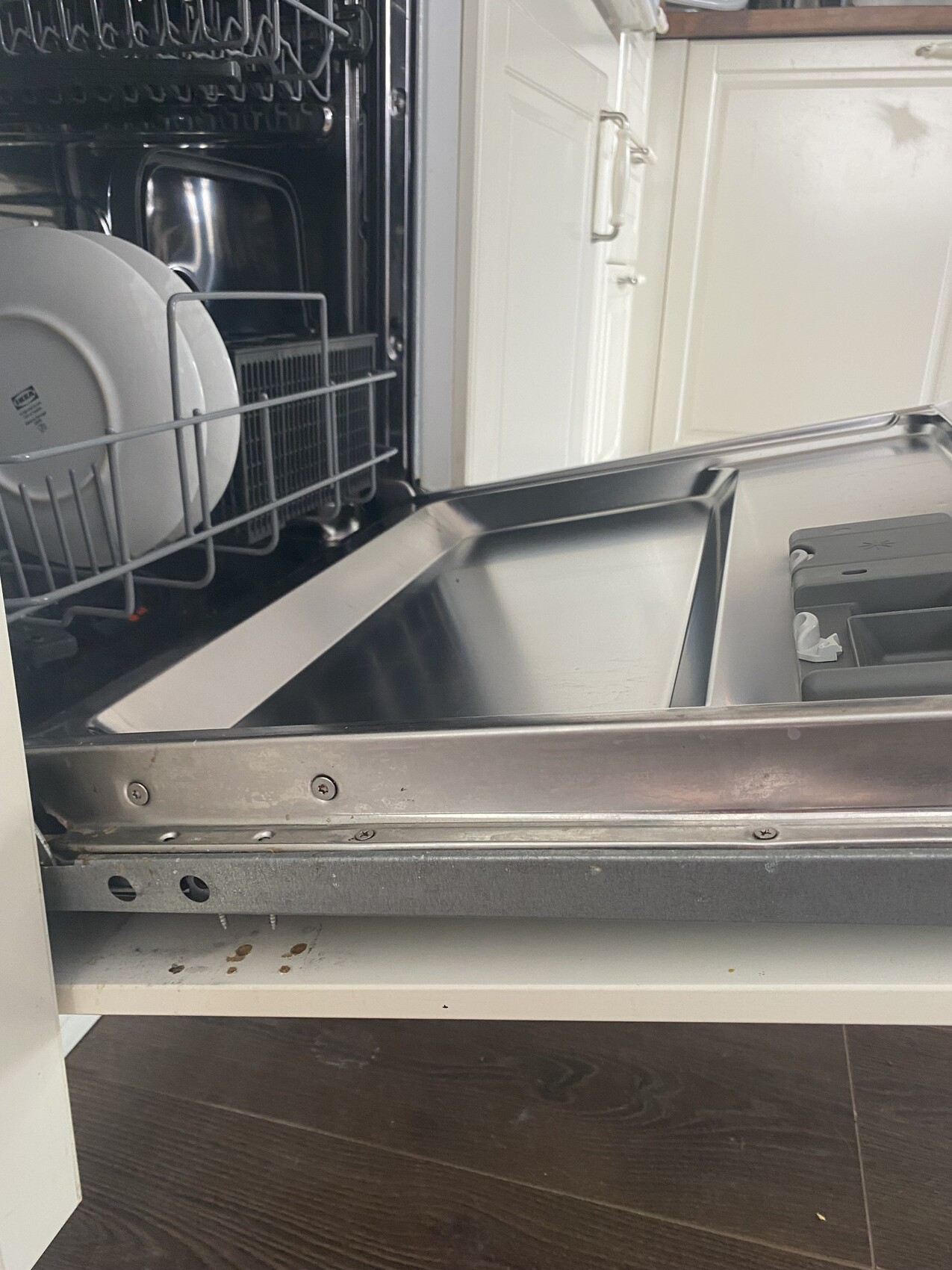

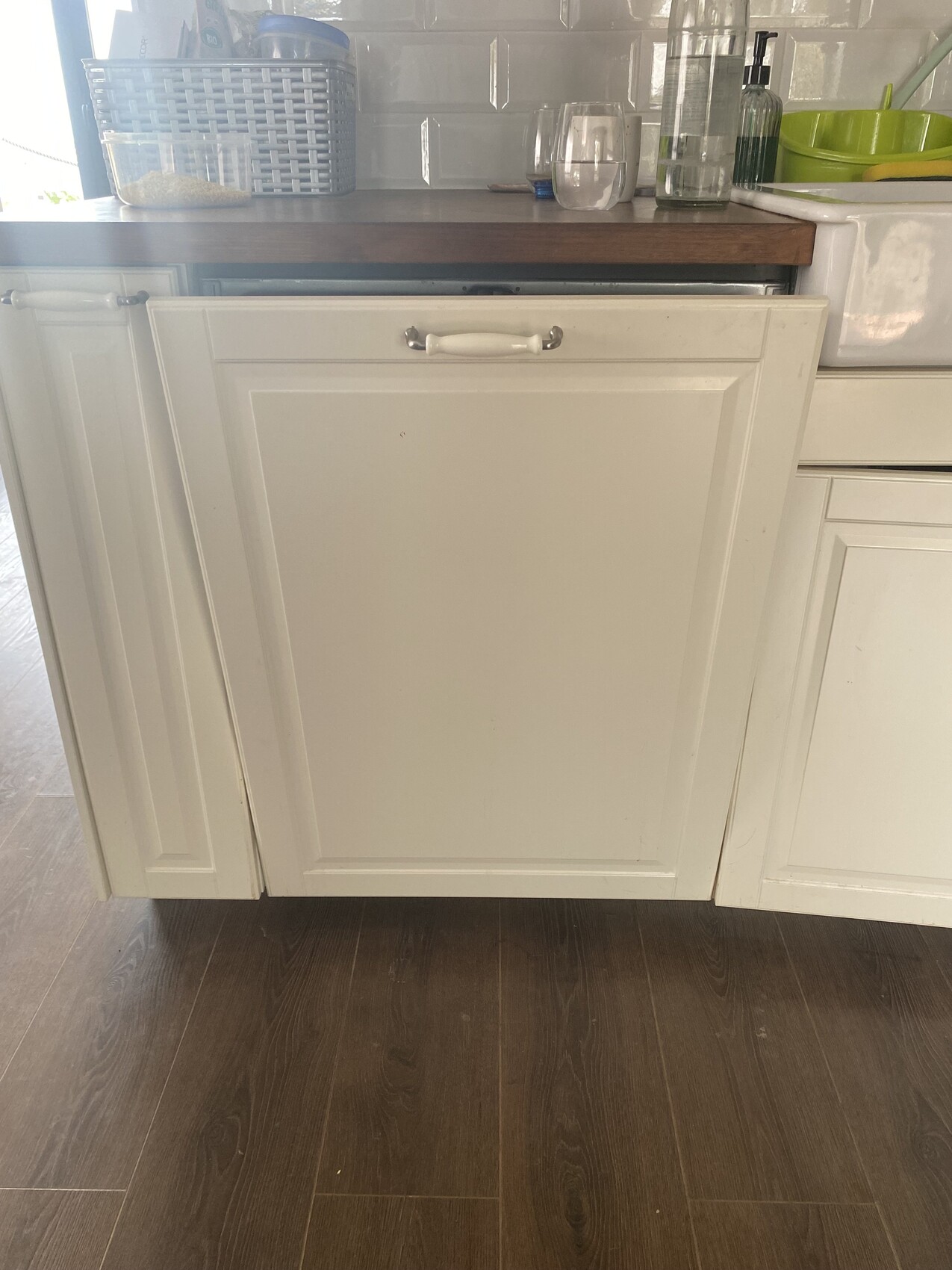

the front panel of my Ikea Rengöra dishwasher has come loose. I would like to remove the front panel and reattach the screws.
Unfortunately, I no longer have any instructions for this.
Maybe someone can give me some tips on which screws I need to loosen to take off the front panel.
Attached are some photos!!

Hello...
When the front door is properly tilted, position a screw through the small hole at the bottom side (left and right) so that it can be loosened through the hole.
Open dishwasher in the kitchen with dishes in the upper rack and stainless steel interior
Kentrat
23 Oct 2023 14:39
Good morning,
it worked perfectly, thank you very much for the tip.
