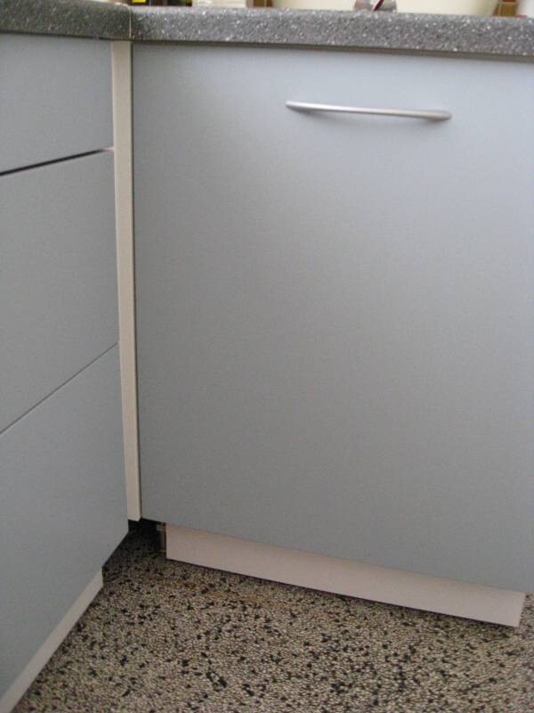

However, our country is not very large, and sometimes kitchens are very small where every centimeter (inch) counts. So, I couldn’t install the corner cabinet with the recommended spacing. With the door and the corner cabinet fittings, everything still worked fine, but when I replaced the corner pull-out mechanism with drawers, I had to come up with a solution.
Problem:
Solution:

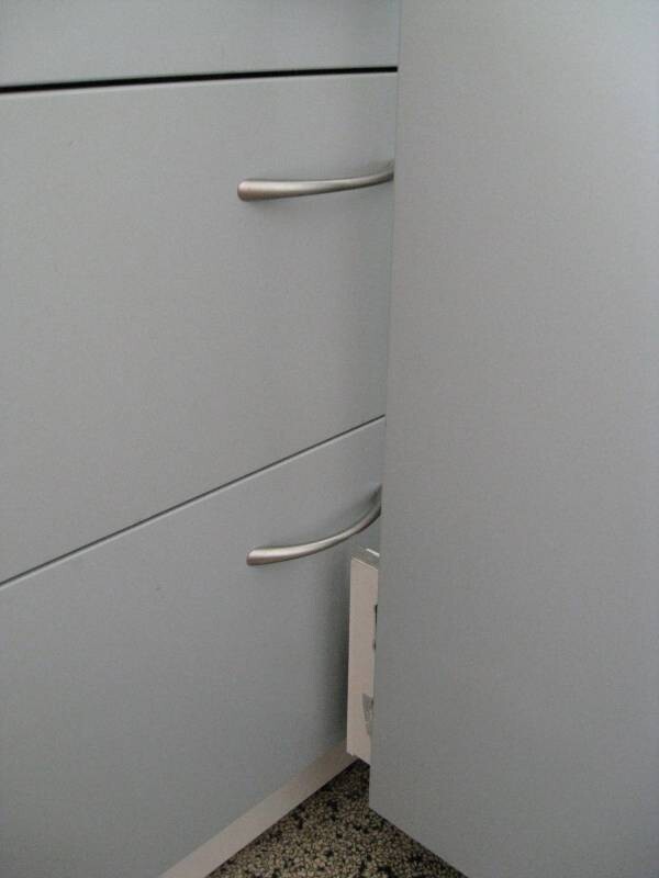

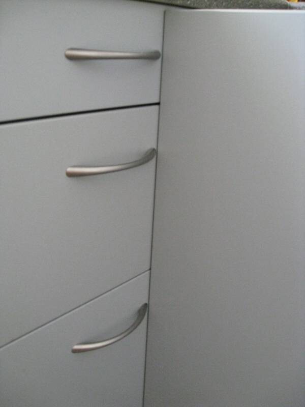

I attached a board to the drawer, into which I installed two ball-bearing slides. I then attached the front panel to these. This way, the front can now be slid to the side:

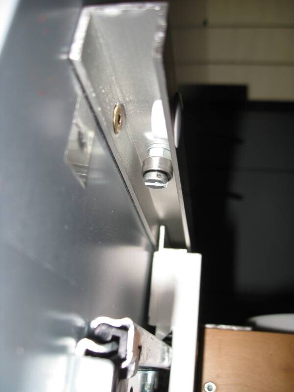

Since ball-bearing slides are not designed to withstand forces perpendicular to their direction of movement, I also installed a guide for stabilization. This consists of an aluminum angle profile and a U-profile, into which I mounted ball bearings.
With little effort, this pull-out solution allows for an efficient use of space at a low cost.
