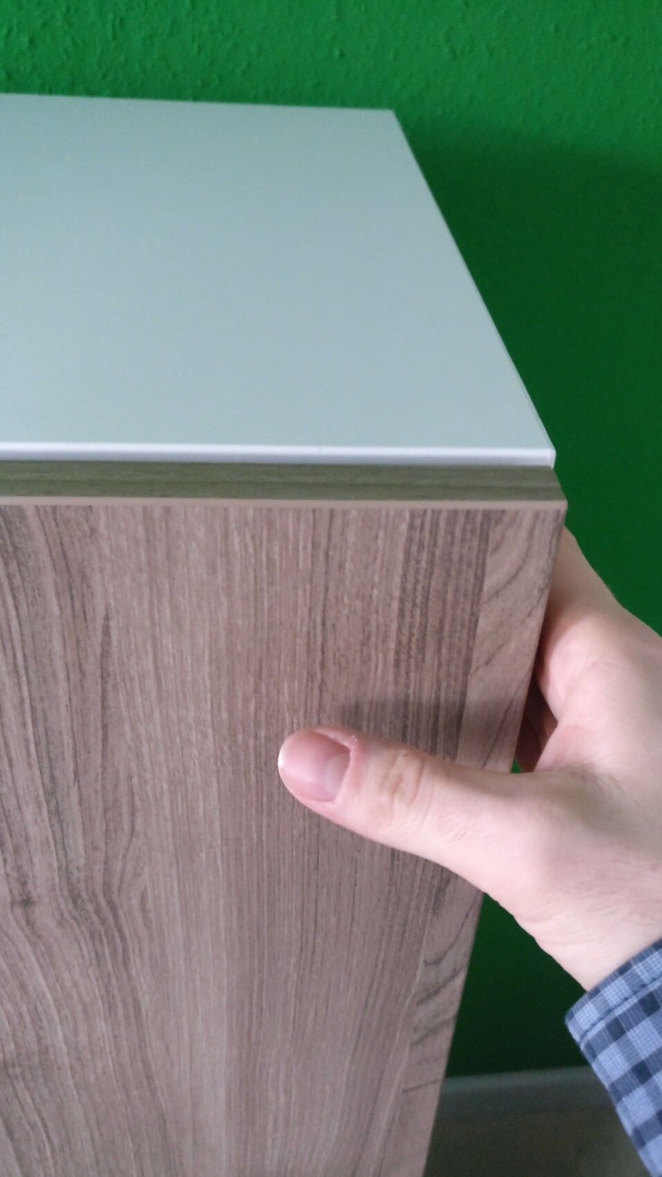

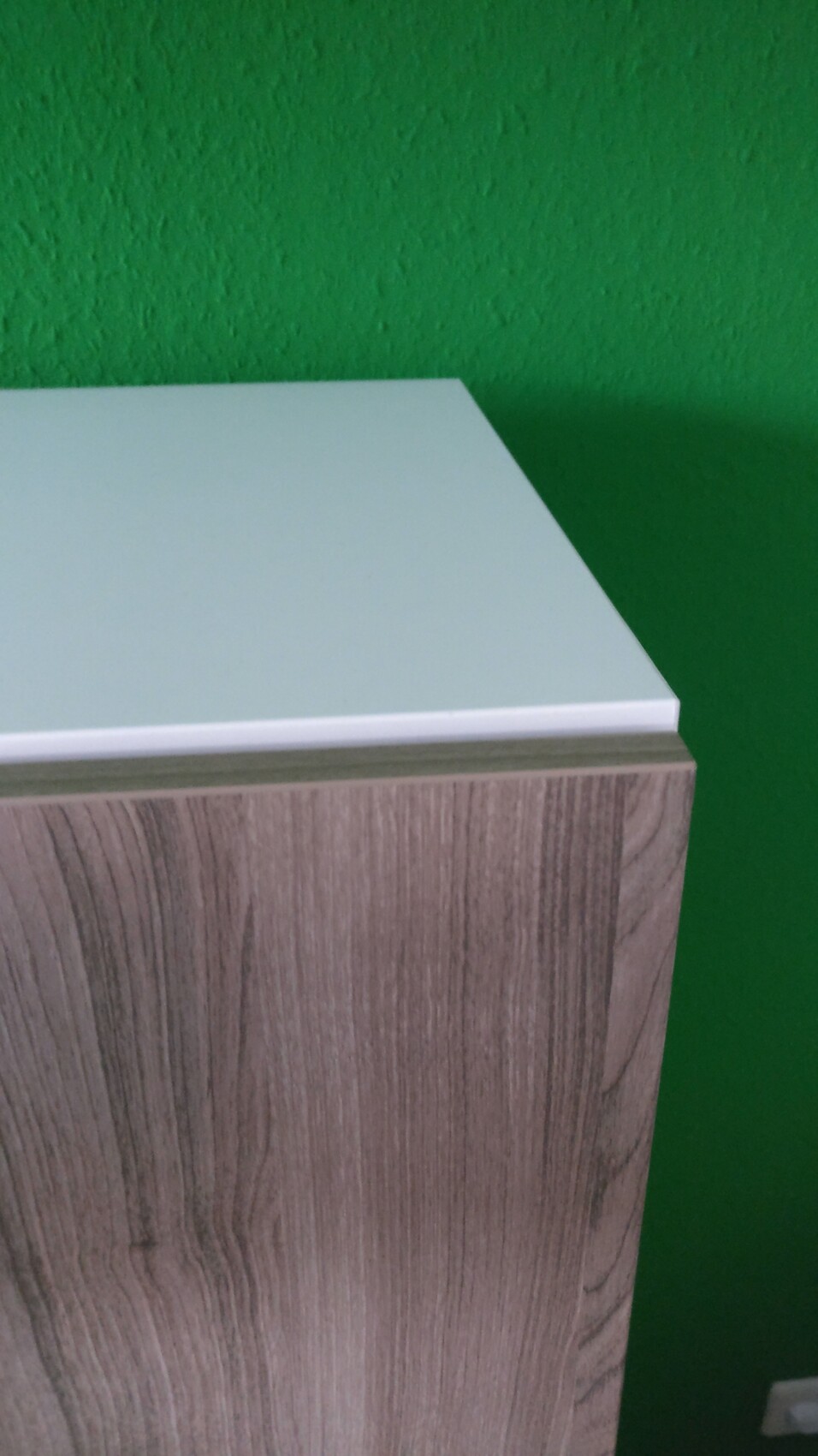

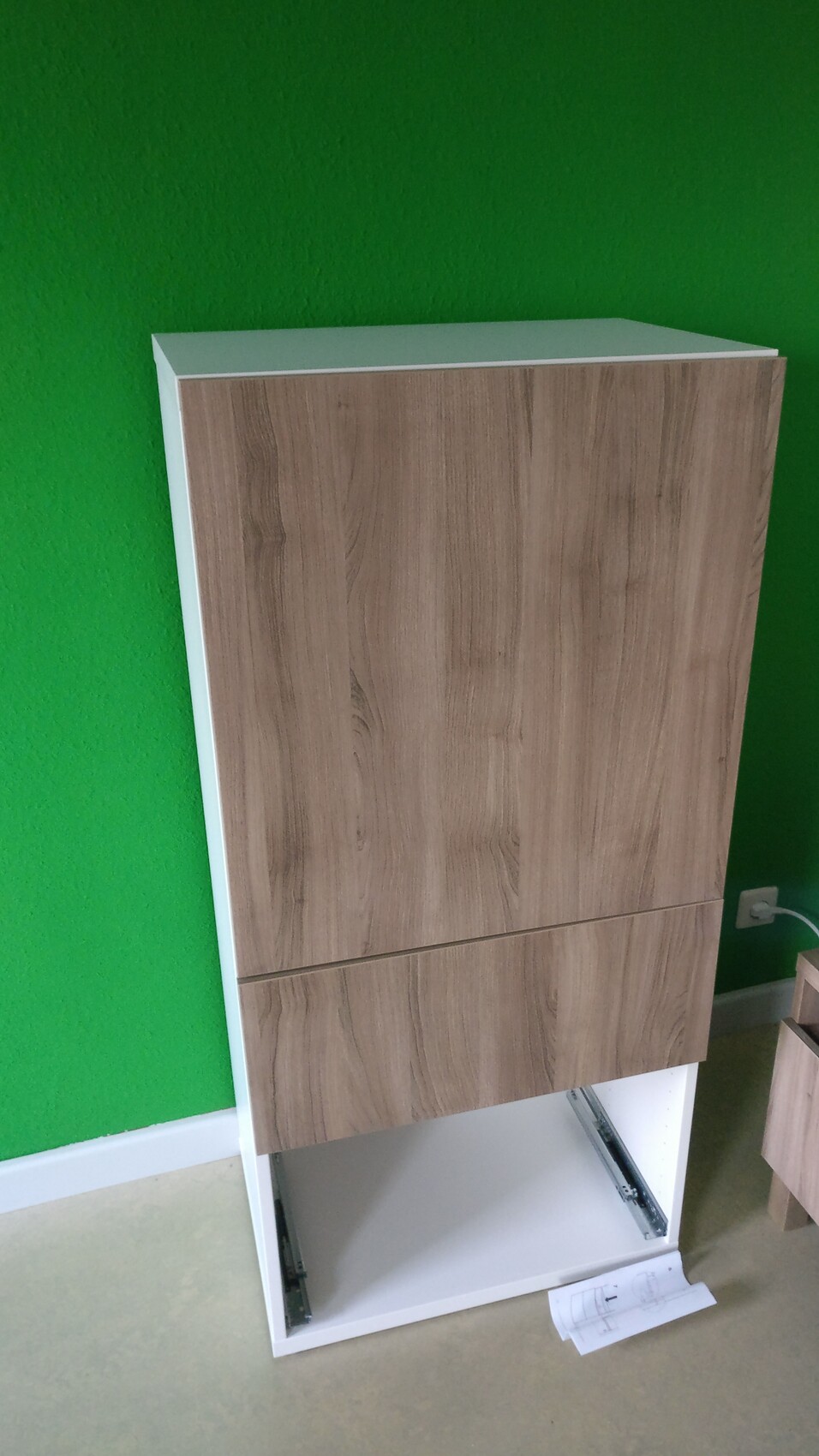

My apologies, here are three pictures attached. I hope it’s clear what I mean. By applying slight lateral pressure, the cabinet carcass can be moved into the correct position, but unfortunately it doesn’t stay there. Does anyone have any ideas?

Did you use a spirit level to align the feet?
Mycraft4 Mar 2019 09:14
Most likely, it is not the cabinet that is warped but the floor, and since Ikea products often have only minimal rigidity, the entire unit warps to match the shape of the underlying surface.
Simply screw it straight to the wall.
