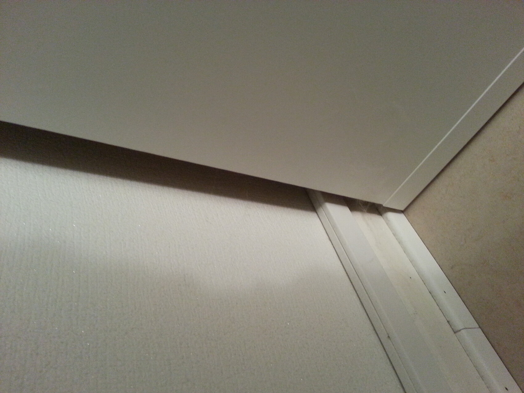

robi_aus_ffm9 Sep 2015 18:46I still have the system without a wall rail, with anchors at the very top. Rails were added only later. However, it also worked well in the kitchen with rails. So it doesn’t really matter...
best regards, robi_aus_ffm

robi_aus_ffm9 Sep 2015 20:43I also have a base,
but I left about 3 cm (1.2 inches) of space at the bottom from the wall. Depending on how you turn the small adjustable feet at the bottom in or out, you can create a slight backward tilt so that the cabinet is closer to the wall at the top. At the top, I left about 1 cm (0.4 inches) of space. Besides the wall plugs, this acts as additional protection against tipping over.
Best regards, robi
