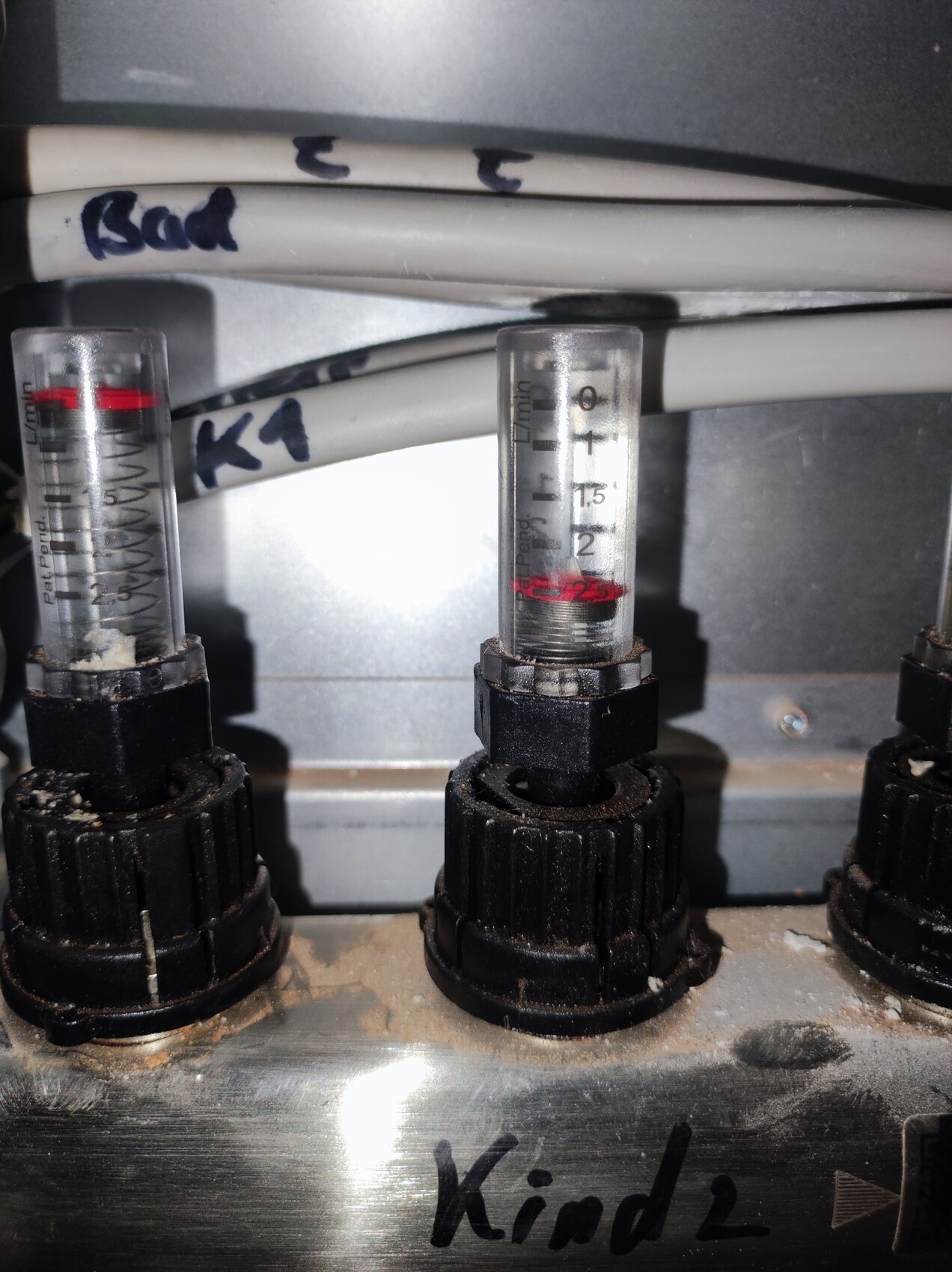

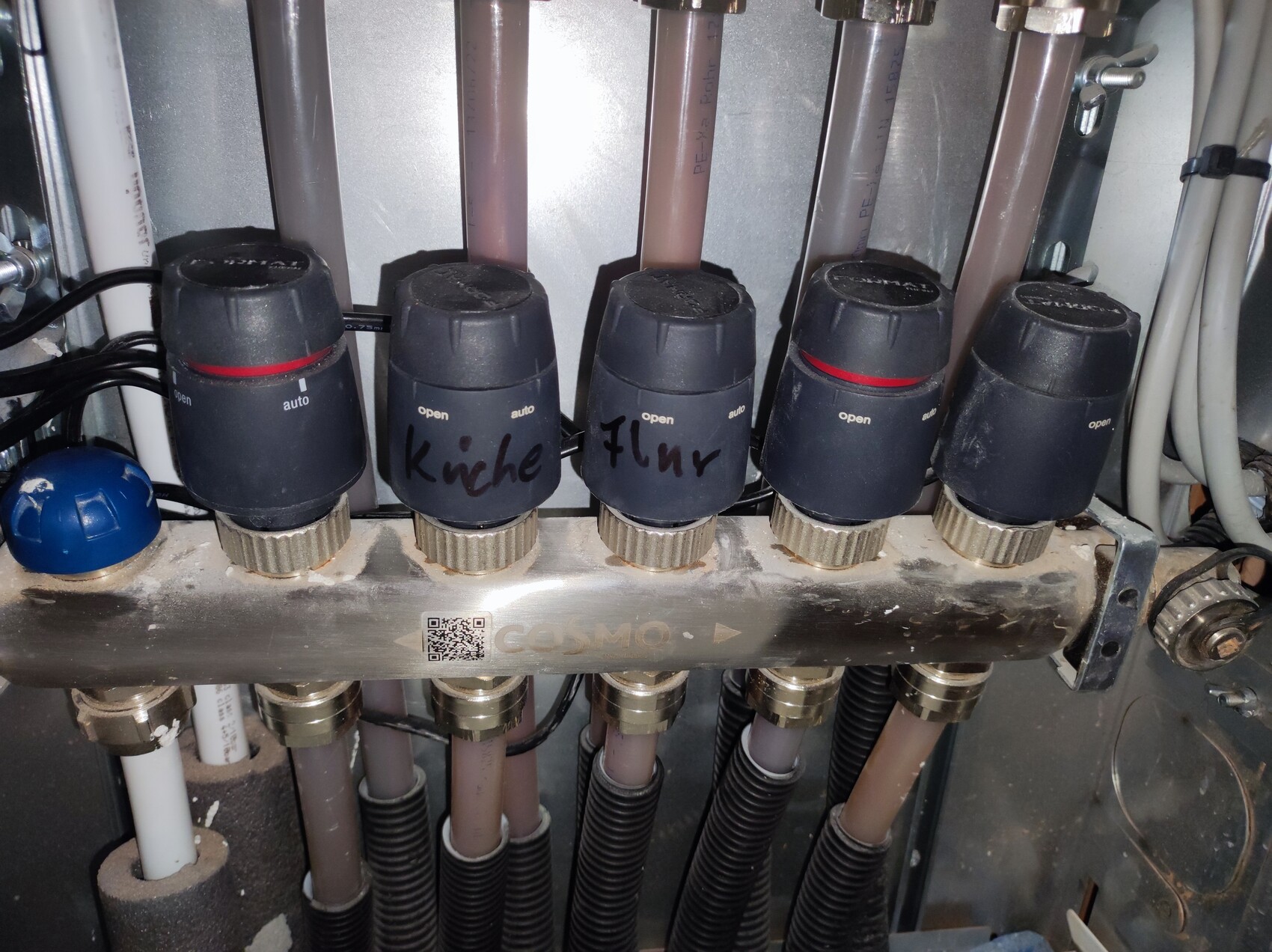

OBpunkt
13 Jan 2024 15:20
Here are the photos from the distribution box on the first floor.
Three transparent measuring tubes with scales and red liquid, mounted on a black base part
Five black rotary knobs with red rings on a metal block, hoses behind.
On the left is Child 2’s room, the affected bedroom that is not heating properly. The second open valve is the bathroom; it does get warm there, but in my opinion, it does not reach the 23°C (73°F) target temperature. I haven’t placed a thermometer there yet.
