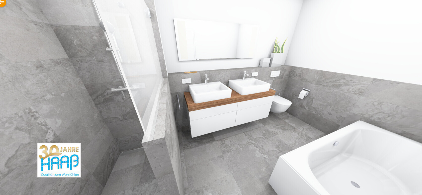

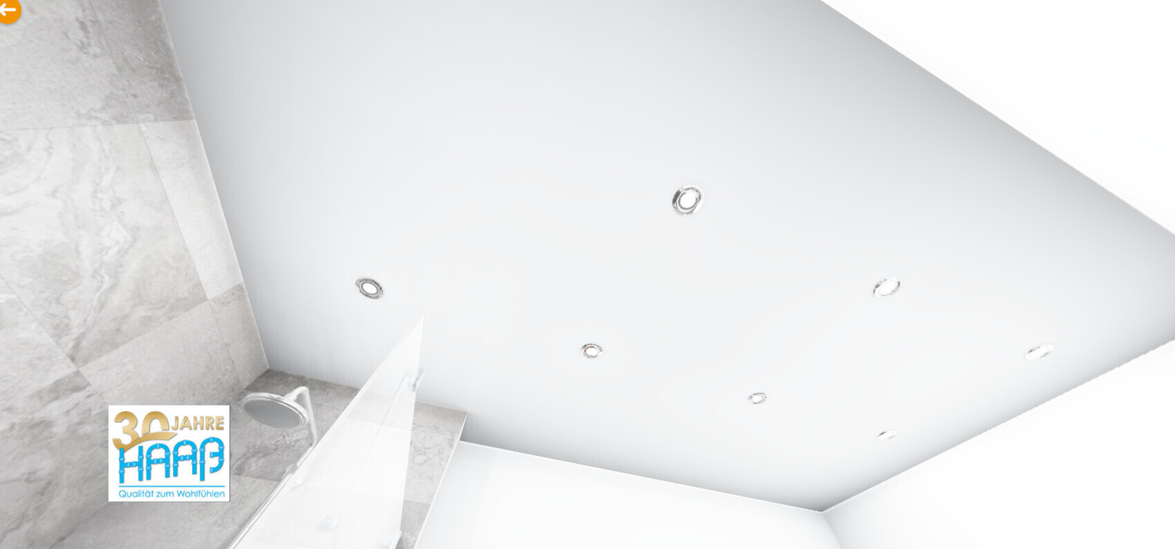

We are looking for tips or suggestions for the ceiling lighting in our bathroom. The bathroom planner included a suspended ceiling with recessed spotlights in the visualization. We don’t want that, partly because we don’t want to reduce our ceiling height of 275cm (9 feet). Of course, we can define additional ceiling light points in the electrical plan for the electrician. What would you do? For example, I once saw a bathroom light from a well-known smart lighting system brand that allows you to switch between warm and cool white light.

Myrna_Loy7 Jun 2021 16:00There are countless options – but why are you stressing over saving just 10 cm (4 inches) of height in such a small room? With ultra-thin recessed lights, even 5 cm (2 inches) clearance is enough. A slightly lower ceiling might actually benefit the room, preventing it from feeling like a shaft. Ceiling fixtures can sometimes make the room feel lower than recessed lights do.

When thinking about the design of the light fixtures, consider two categories:
- Task lighting (illumination, light at the mirror, cleaning light)
- Ambient lighting (comfort, aesthetics)
There are certainly fixtures with adjustable color temperature or dim-to-warm features – but besides the color temperature, other factors are important for good lighting.
I would position the ceiling light sources to fulfill their functional roles, taking the mirror into account as well.
The light sources for ambient lighting could be placed more on the walls, for example, indirect lighting.
