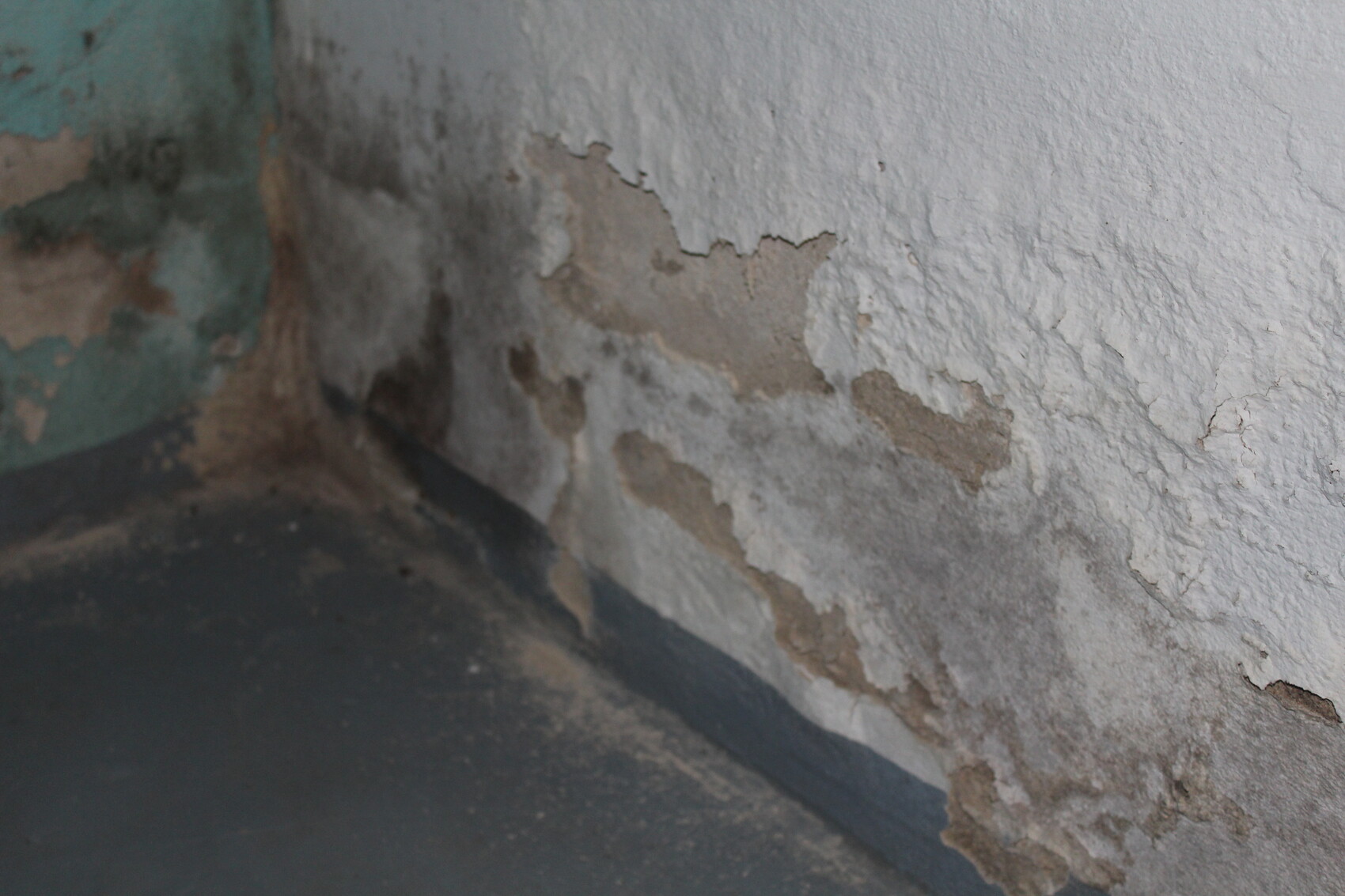

buonappetito2 Jan 2017 08:42Here are two more pictures from the newer basement of the existing building.

Even if the photos are sharp and taken with a scale, they do not provide a reliable basis for assessing the condition of the structure. Real damage or its extent is usually not obvious.
Invest some money and have a professional take a look before you end up regretting your decision—whether it’s purchasing a fixer-upper or missing out on a bargain.

For rental purposes, as mentioned above, I would weigh the options carefully. However, it’s important to consider that an old house is a “mystery box.” You won’t avoid a full renovation—drying out the basement, for example—and during such a renovation, problems often arise that couldn’t be anticipated beforehand. This can even happen with experts involved. WITHOUT a specialist, I wouldn’t make any decisions at all, because it’s not just about the basement here. Obviously, a complete heating system will need to be installed, probably all plumbing will have to be redone, and in the process, the electrical system will also need to be updated to the latest standards. Energy efficiency must be considered, so it might be necessary to insulate the entire building, etc. Room layout and expectations today are completely different than when both houses were originally built. So, adjustments to the rooms will likely be needed.
Therefore: first consult with a specialist to determine whether a renovation even makes sense given the current building condition. No one here can provide that assessment. Even a building expert active in this forum couldn’t do this based on just a few pictures. That would be highly unprofessional.
If you are already leaning toward a new build, you can skip this step and simply demolish the buildings right away.
I don’t know the total footprint of the two combined houses, but my parents’ house (built in 1973) is about 140sqm (1,500 sq ft) and unfortunately has a damp basement. Initial inquiries about the cost of drying out the basement came in with a rough estimate of €80,000. And that basement doesn’t look nearly as bad as the two houses in the pictures above, and there is no mold. Just to give you a rough idea of scale.
So: such a renovation is never cheap. It really has to pay off in the end if you want to keep the house.
If there are also emotional reasons for preservation, one may be more willing to invest in a renovation.
But only you can decide that.
Either way: I wouldn’t start without a specialist...
