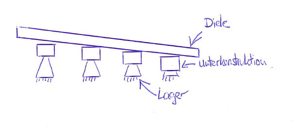

30156030 schrieb:
Does a slope of about 2% (4m length) really have such a drastic effect?No.
2% over 4m (13 feet) equals 8cm (3 inches).
The slope in the sketch is probably around 20-25% (does anyone have a protractor?).
