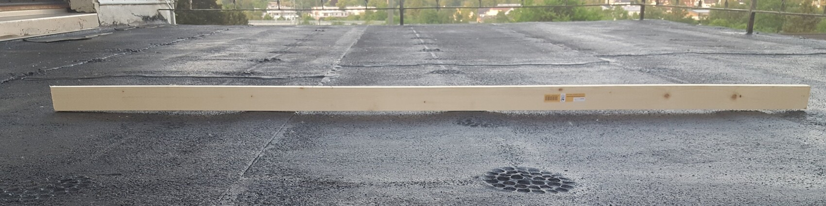

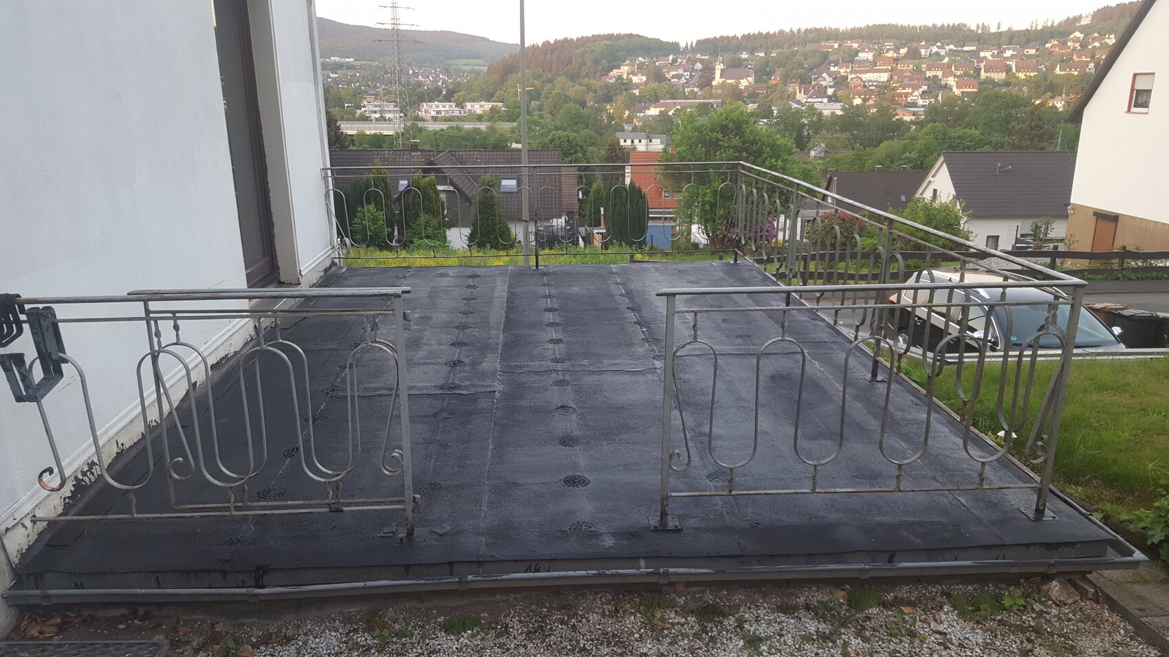

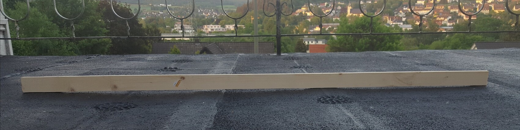

14 May 2018 20:57
This is what it looks like
Roof terrace with black waterproofing and wrought iron railing; view of houses on a hillside.
Wood beam resting on a flat roof surface with railing, urban landscape in the background.
Long wooden batten lying across a flat roof surface made of bitumen.

Maybe start by leveling the surface first?
Don’t expect too much from those Ikea things. I had them on the balcony, and by the second year they didn’t look new at all anymore.

15 May 2018 08:14
How do you level something like this without having to replace the entire roof?
