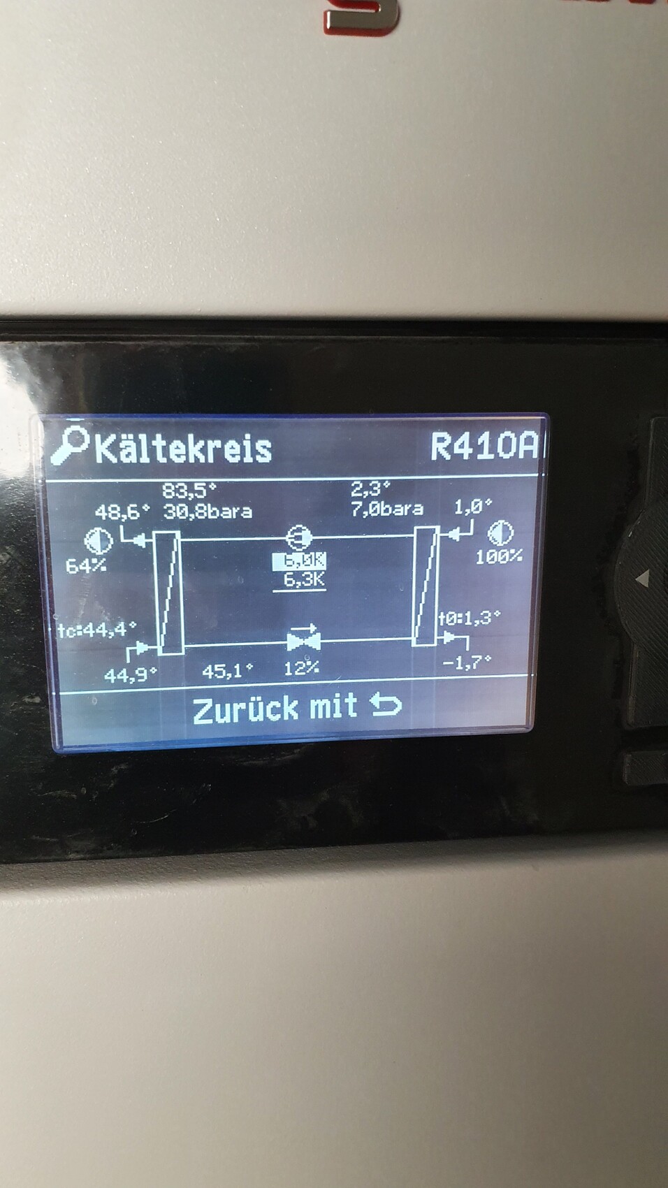

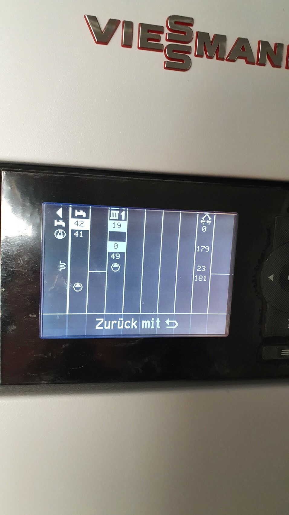

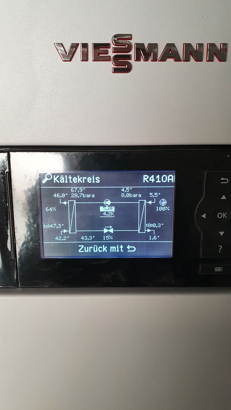

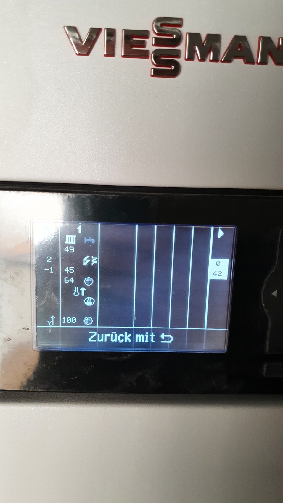

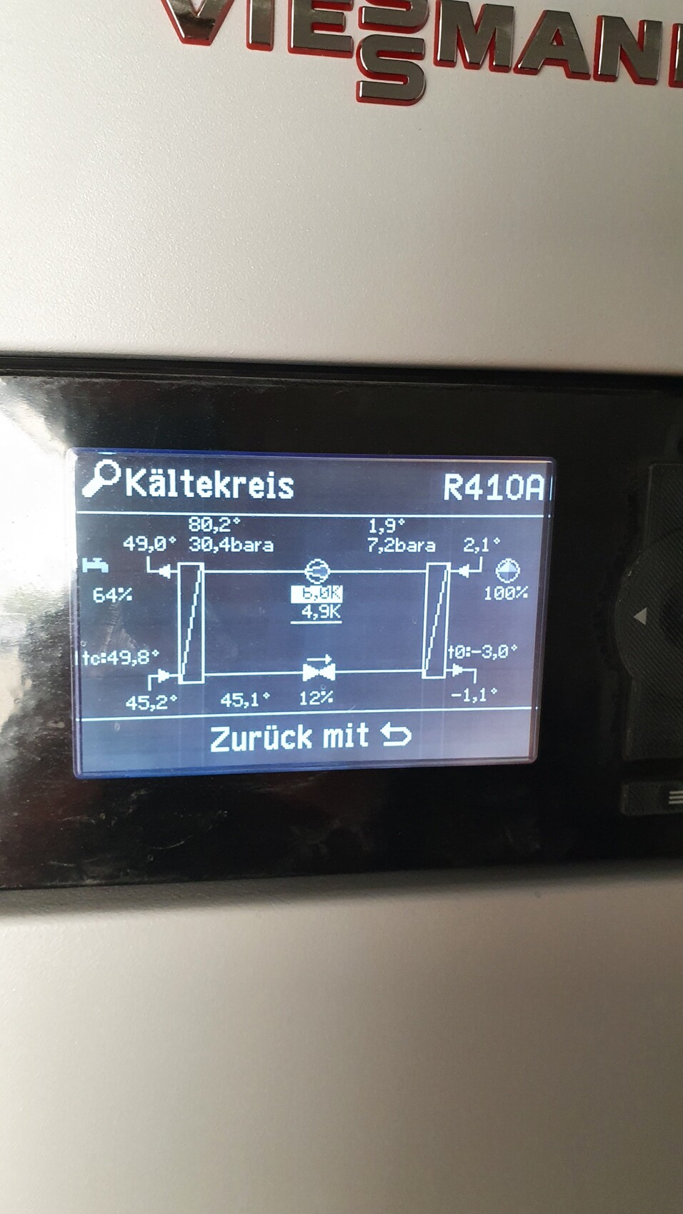

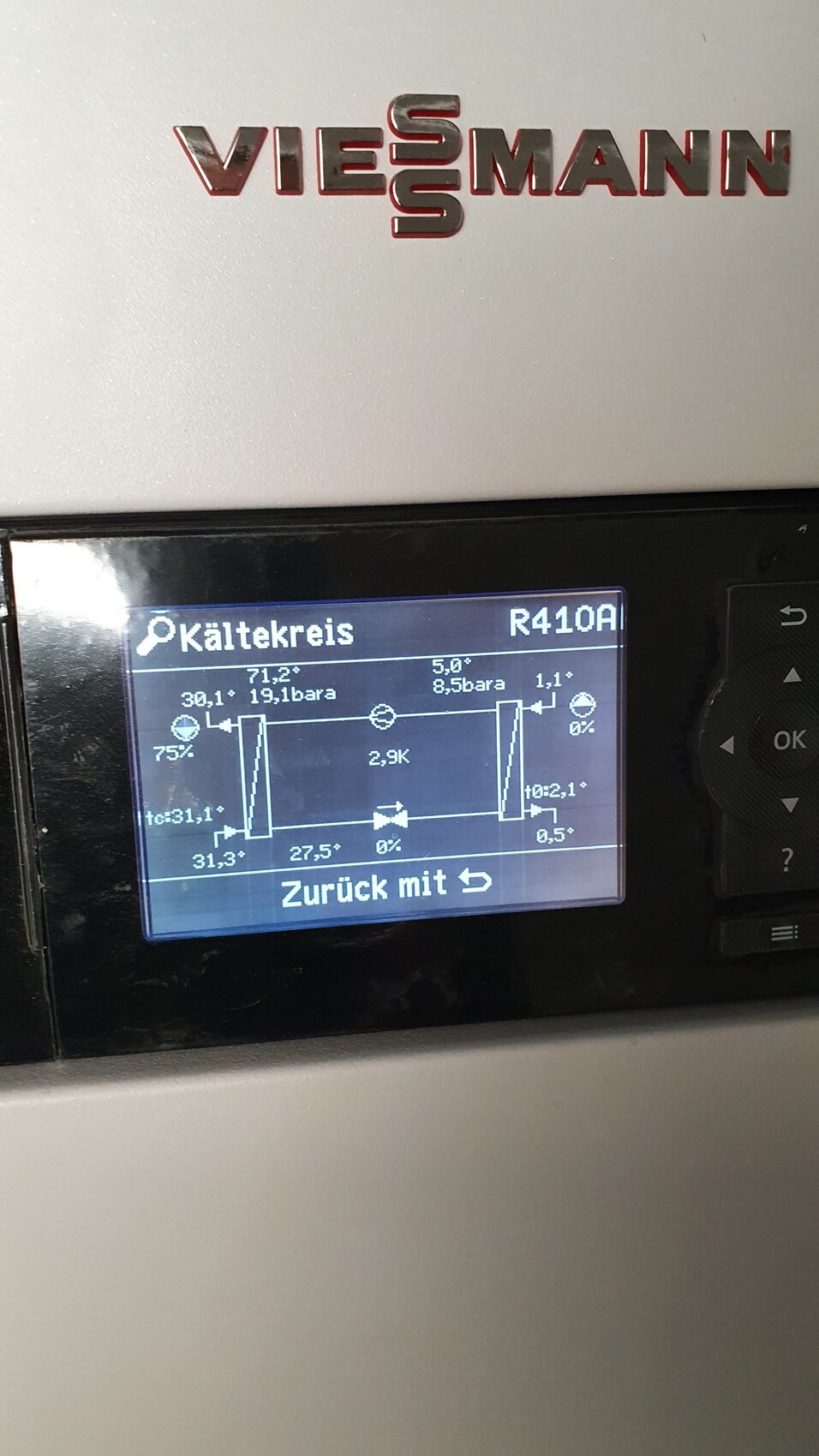

After more than a 2‑hour pause, the system ran briefly for a few minutes. I took some pictures, maybe they help...

The new photos look better already. I assume you only take pictures while the compressor is running, right? Temperature readings during heating system standby are not meaningful.
Stadtvilla19
30 Sep 2020 15:10
Yes, only when it runs. It ran for a maximum of 5 minutes, but as I said, since the cooling has been off, the compressor hasn’t run for over 2 hours now...
