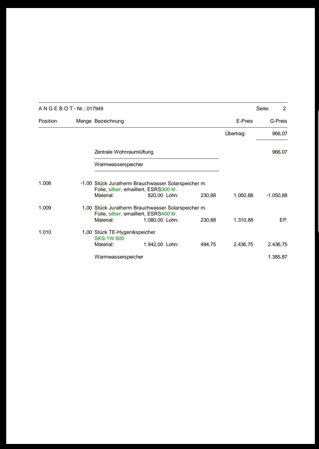

We are currently deciding whether to install a 300L (80 gallons) enamel-coated hot water tank (gas + solar without heating support) or, for an additional cost of about 1700€ gross, a hygienic storage tank in our new build. Since we have a baby, the issue of legionella concerns me a lot. Unfortunately, our customization budget is almost used up, otherwise I would have automatically chosen the hygienic storage tank.
