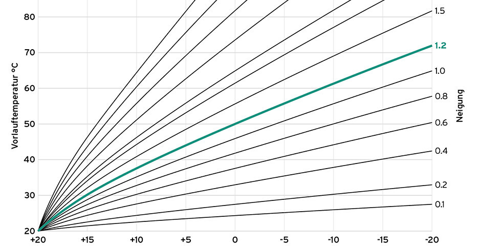

The idea would be either to increase the heating curve from 0.10 to 0.15 to ensure the bathroom reaches 21°C (69.8°F) just to be safe, and then reduce the others again.
Or should I better increase the steepness?
In theory, I would even need to go to 0.15 because the underfloor heating was designed for 30°C (86°F) supply temperature at –12°C (10°F) outside temperature... but theory and practice differ...
Attached is the original Vaillant heating curve.

T_im_Norden12 Jan 2021 09:27I would leave the curve as it is below, and if the bathroom heating is adequate, then reduce the flow.
In addition, record daily consumption and flow temperature in comparison to the outdoor temperature.
It’s not just about the values but also about an efficient heating system.
Watch and wait for now.
