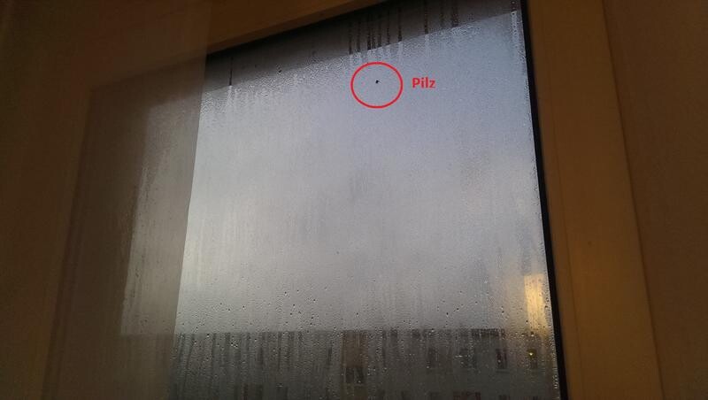

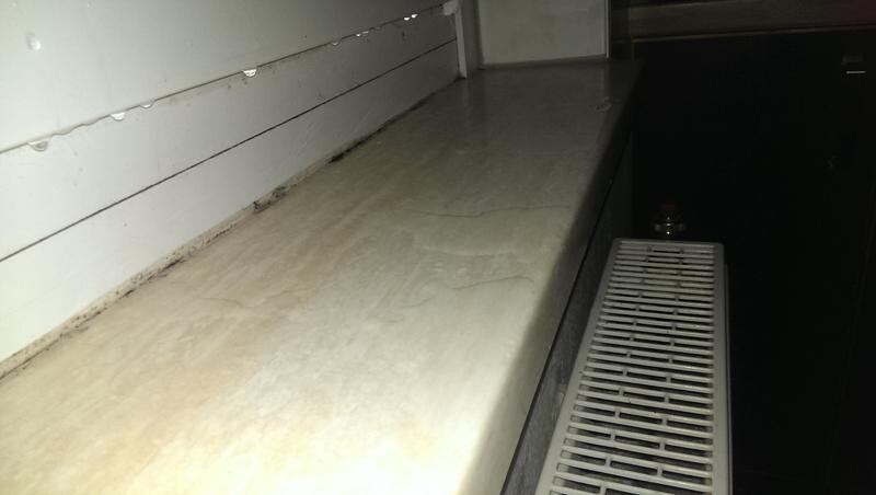

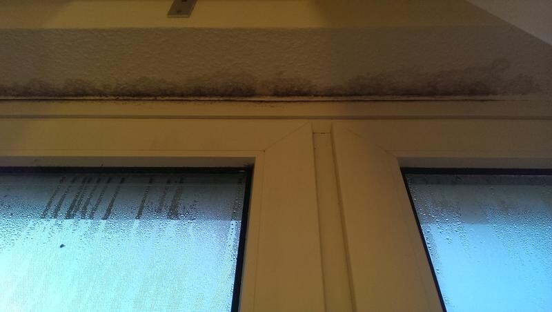

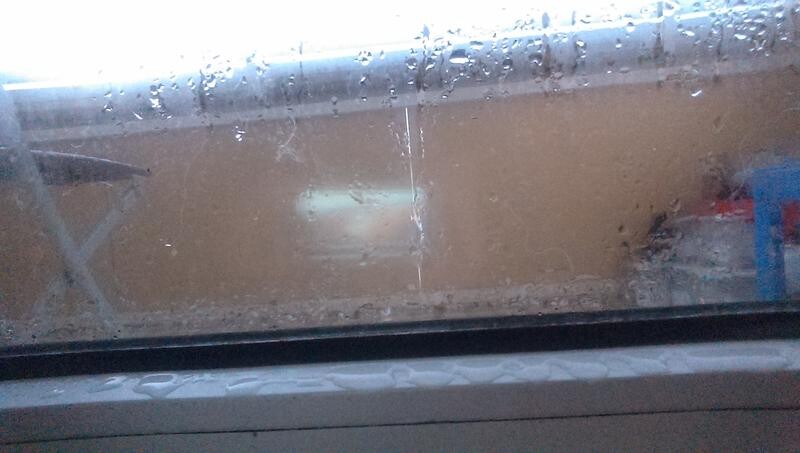

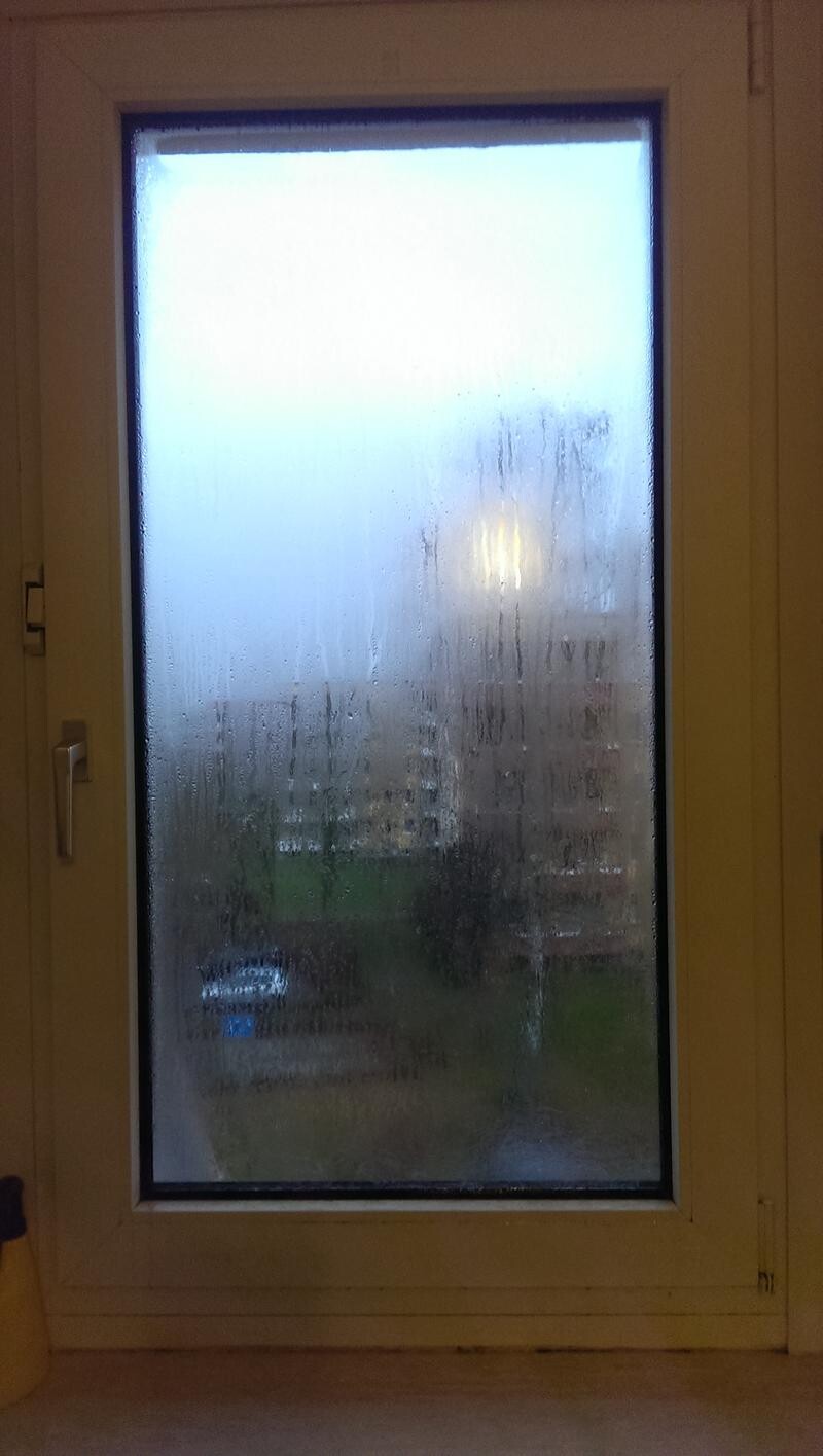

This year the problem has, of course, reappeared. My boyfriend refuses to talk to the landlord because he’s afraid of possible costs for inspections. I can’t do it myself since I’m not on the lease and I don’t really understand the legal side of things (I’m a foreigner studying in Germany). My boyfriend says I should just keep stacking more cloths on every window and on the floor. But I’m running out of those too! Can anyone help me? What else can I do? Is it our fault that the windows look like this? Can the landlord charge us for repair or inspection costs? This morning I took a few photos to illustrate what I’m dealing with every day (really, it looks like this day and night):
Bedroom:
Here you can see how bad the mold problem in the bedroom is, even though we have used special treatments against it:
Kitchen:
Living room balcony door:
We still have one window in the study that stays comparatively dry… Why is that?

If the glass were very cold, that would explain the condensation (according to the dew point chart). In this case, it might turn out that despite heating and ventilation, no improvement can be achieved. If room temperature and humidity consistently remain within the normal range, no water should form there.
If it does, the building component is probably faulty. If the glass has a temperature typical for such a window, it is more likely due to heating or ventilation.
The question is, what is a normal interior temperature for window panes? I would argue that 12–13°C (54–55°F) is not normal. According to the dew point chart, that would be the temperature the glass would need to have for condensation to occur at 21°C (70°F) room temperature and 60% humidity.
In short: if both the humidity and room temperature are kept within reasonable levels for living spaces and do not deviate from them, then neither mold nor condensation should occur. As a tenant, you should not be required to keep humidity below 40% or constantly heat to 25°C (77°F) just to prevent mold caused by leaky windows or cracked facades.
A pane completely dry while the one right next to it is Niagara? At 21-26°C (70-79°F) room temperature? Something doesn’t add up...
