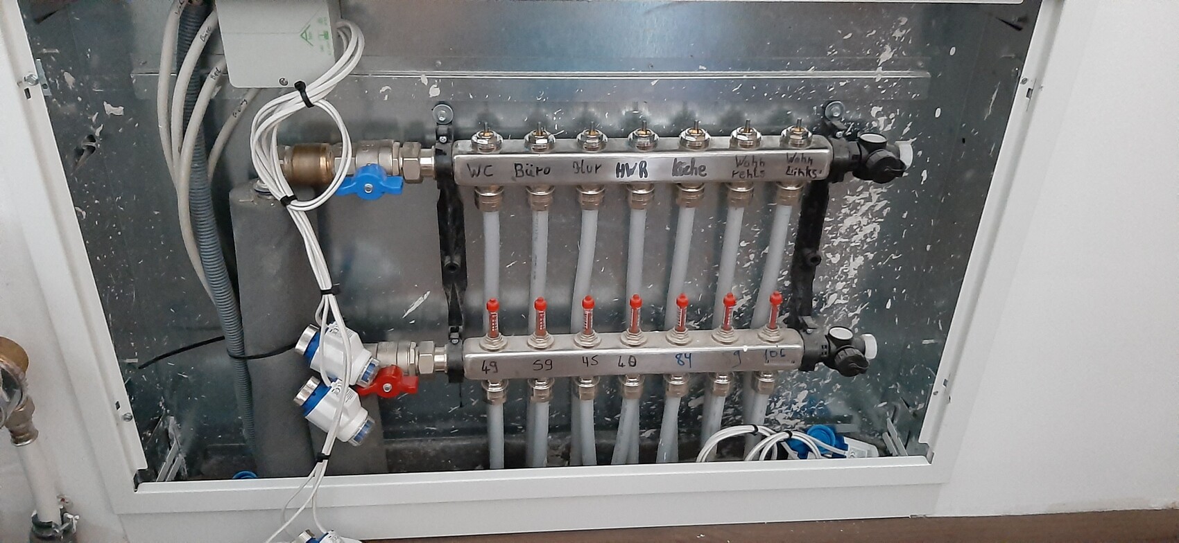

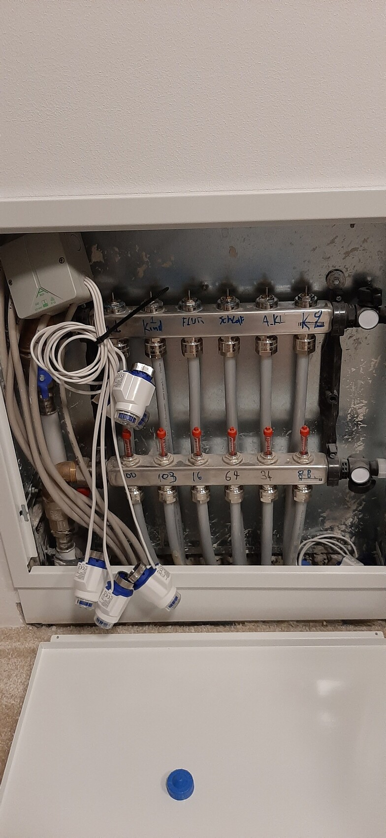

Hello. We have the feeling that the underfloor heating is running in one room of our new build. The room isn’t really hot, but the air feels like it does in winter when the heating is on. The floor is also not as cold as in the other rooms. Our room temperature sensors (RTS) are not installed yet. So far, only the thermostats themselves are fitted, but the covers for adjusting them are still missing. The electrician unfortunately delivered the wrong ones here. I have already turned the controller to the left with a screwdriver. However, I could keep doing this indefinitely. I can’t tell when it reaches zero. If I go too far, it goes back to 6. There has been a slight improvement in the room air quality, but the heating could still be running there. I should be able to check at the manifold boxes whether and in which circuit there is movement, right? But how? All the manifold valves are set to automatic. If the heating is firing, it could actually be heating. I seem to remember that ELCO customer service set the heating to activate only below an outside temperature of 18°C (64°F). Thinking about it, isn’t that quite high for a new build? If the outside temperature is 18°C (64°F) for 1 or 2 days, I shouldn’t really notice anything inside, right? What do you think?

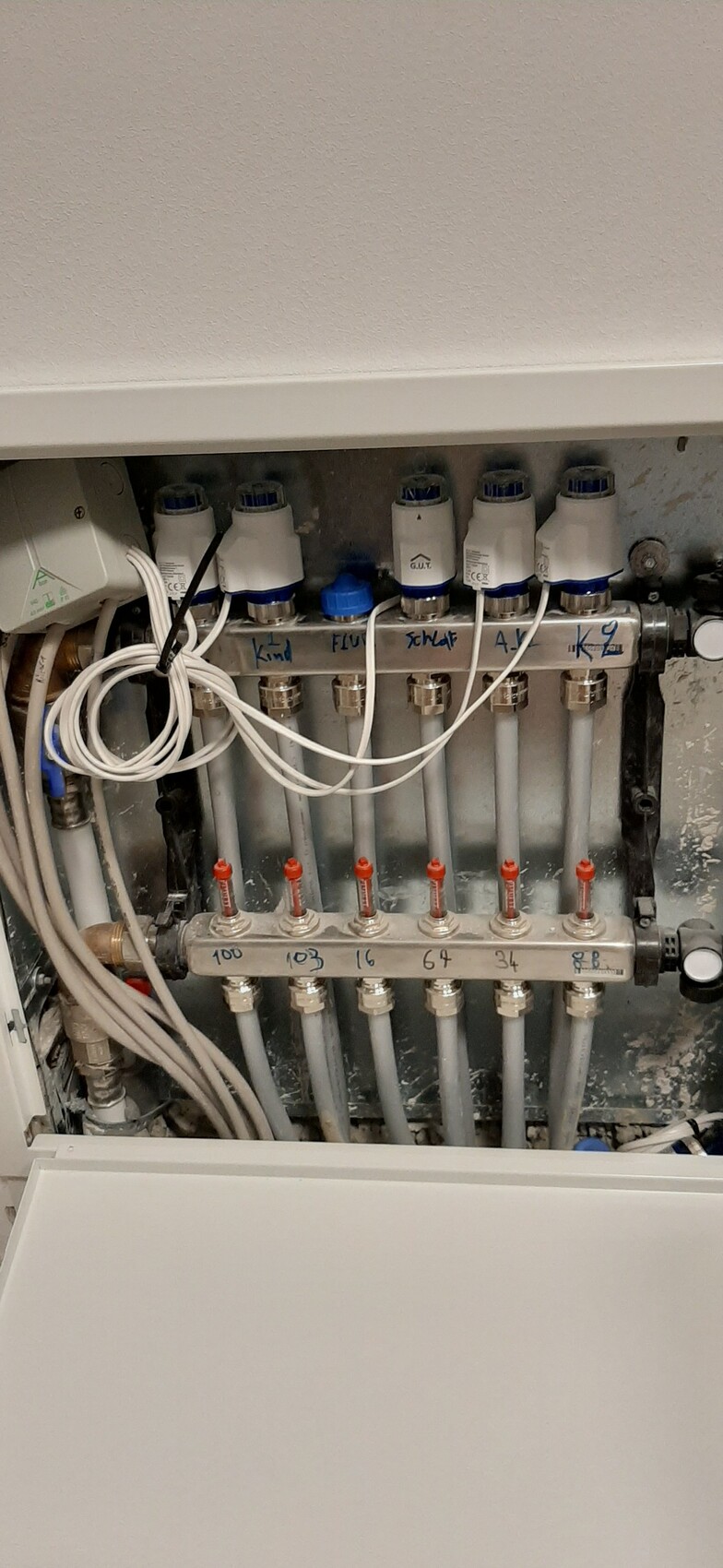

Image 5 shows the overflow valve. During the heating season, you should close it at the latest and open all ERR valves so that the heat reaches the screed.

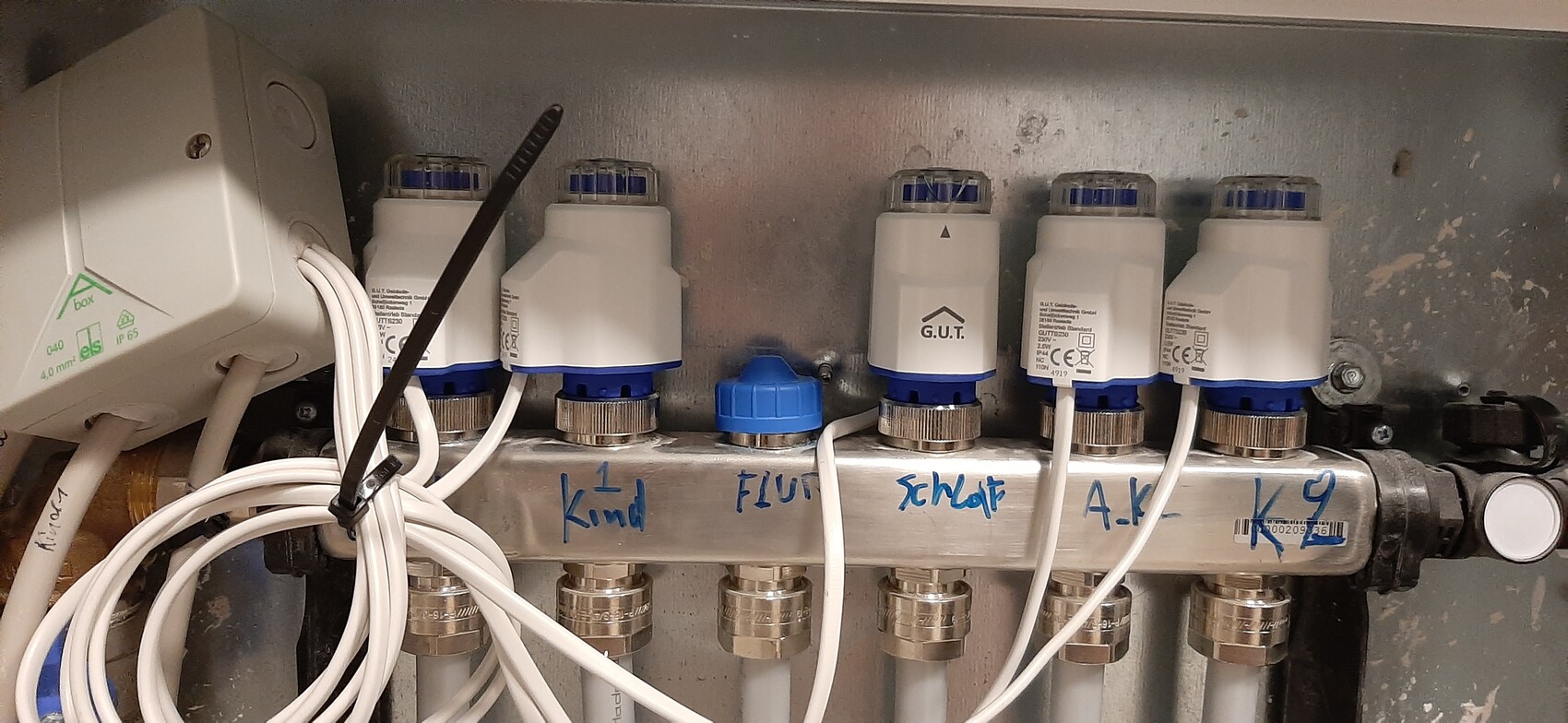

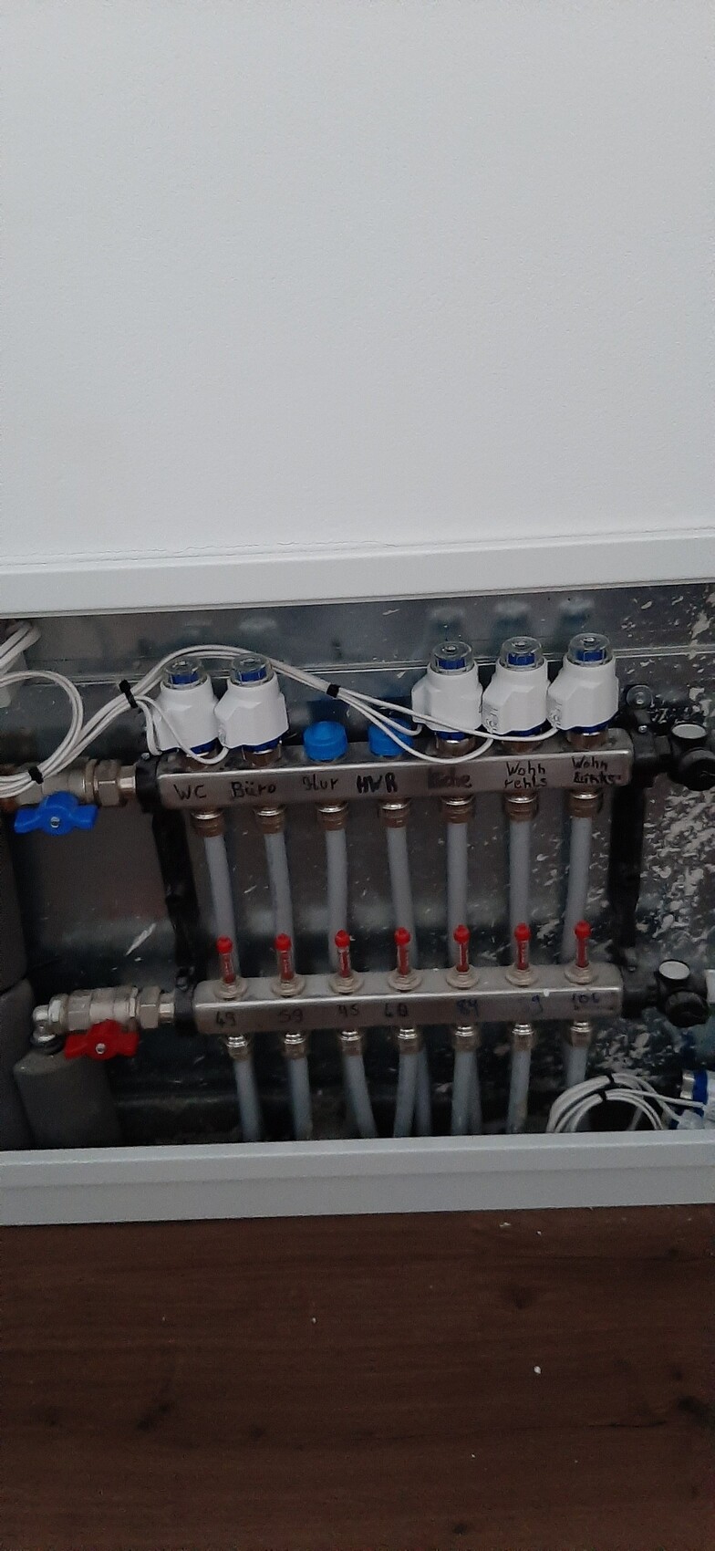

The actuators have been removed. I can shut off the distribution box on the ground floor separately at the electrical panel. These used to be warm but are now cold. Unfortunately, this is not possible on the upper floor. There, I also removed the actuators. Do I still need to disconnect them as well?
Heizungs-Verteiler mit sechs Zuleitungen, Absperrventilen, Kabelbündeln und nummerierten Anschlüssen

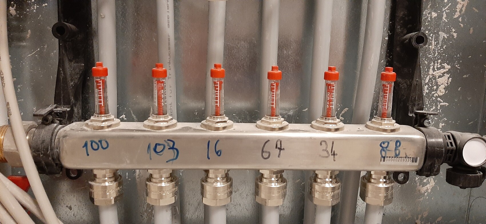

Sechs Absperrventile mit roten Griffen an einer Metallverteilungsleiste, nummeriert (100,103,16,64,34,88)
Gasverteiler mit mehreren Reglerköpfen, blauen Deckeln, Schläuchen und Kabeln im Metallgehäuse.
Heizungs-Verteiler mit mehreren Rohren, Ventilen, Kabeln und Messsensoren im Schrank.

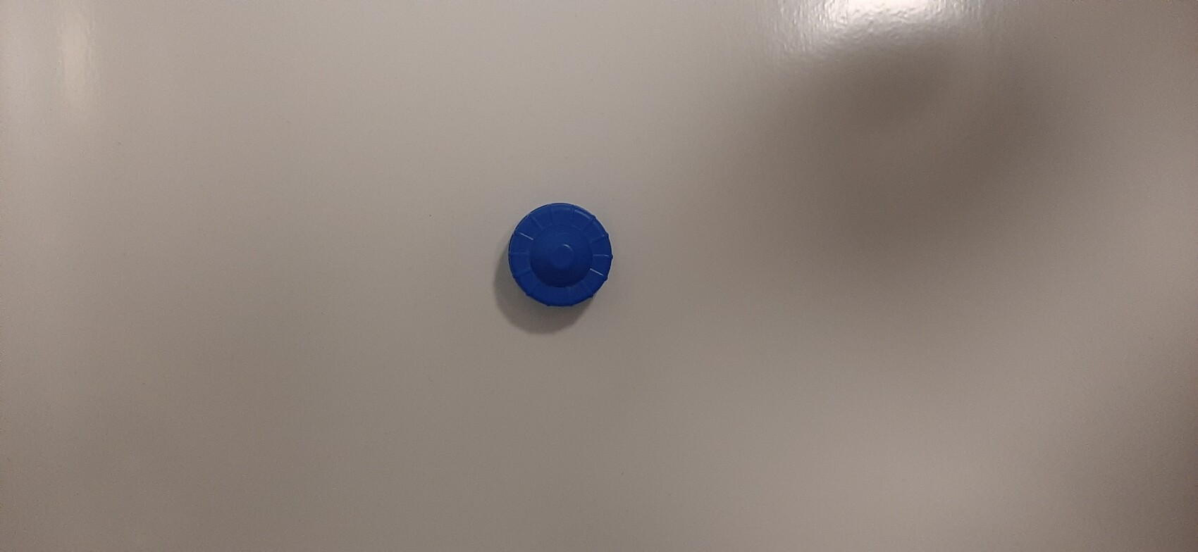

Kleiner blauer Plastikdeckel liegt auf einer glatten hellgrauen Oberfläche.
Verteilerbalken der Heizungsanlage mit rot und blau markierten Absperrventilen und Kabeln.
Verteiler für Wasser mit mehreren Absperrventilen, Kennzeichnungen und Kabeln in einem Metallgehäuse

You don’t have to disconnect it; you can simply adjust the corresponding room controller to ensure no current flows.
