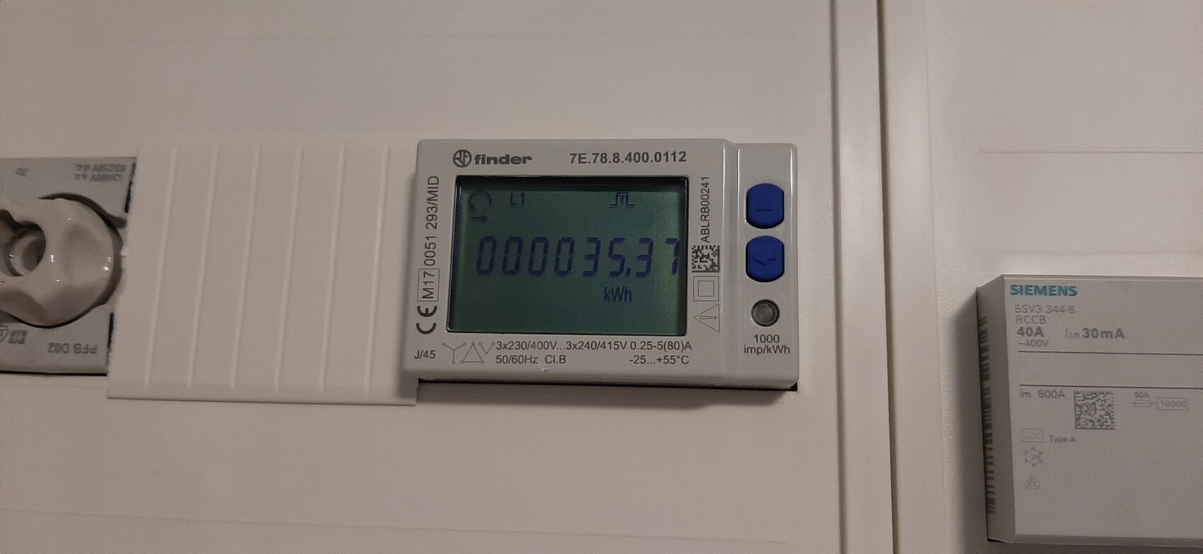

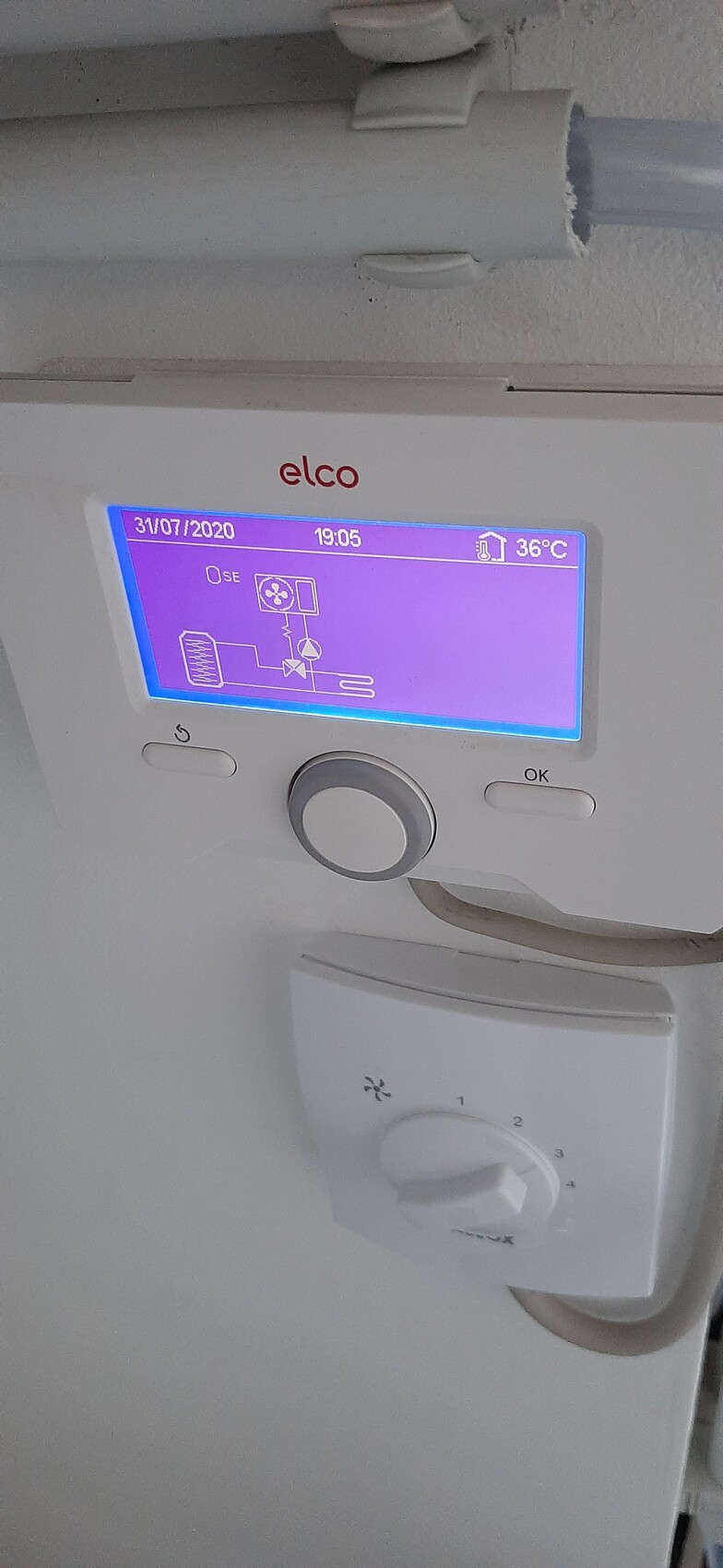

Here is the current status regarding electricity consumption.

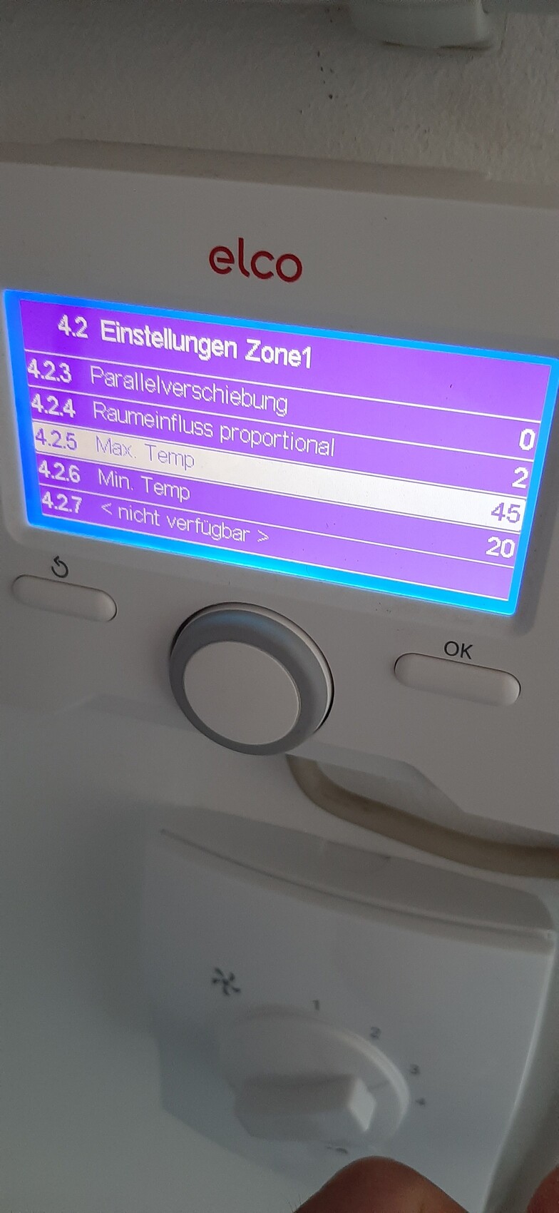

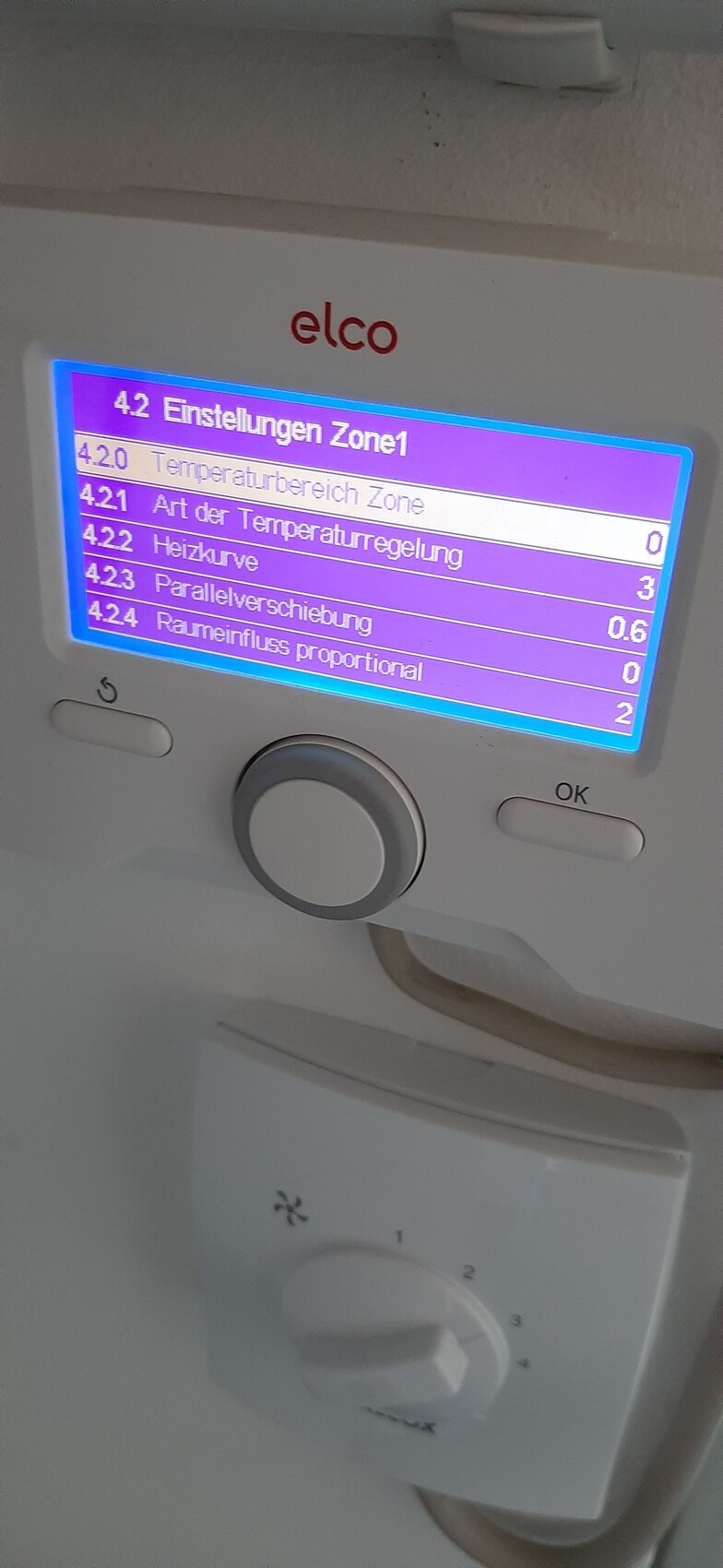

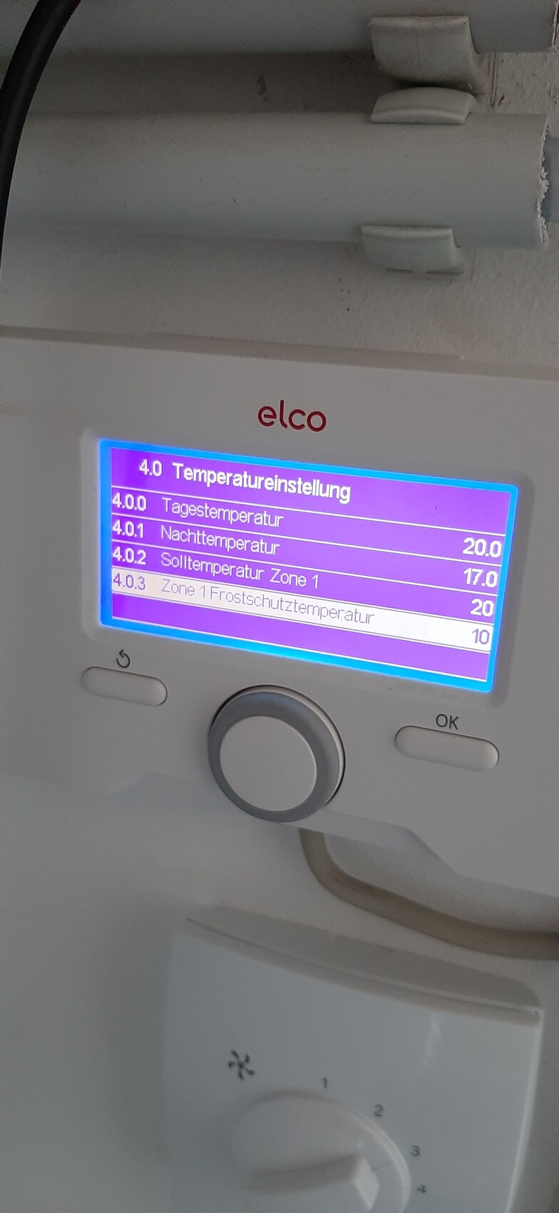

Also attached are some pictures from the heating specialist area. I couldn’t adjust the heating settings as I expected. For example, at 0°C (32°F) the temperature is 28°C (82°F), and at -10°C (14°F) it is 32°C (90°F). However, I could only set the supply temperature within the minimum and maximum limits of 20°C to 45°C (68°F to 113°F). I have now set 32°C (90°F) as the maximum in all zones. How can I be sure that this temperature isn’t already being used at 0°C (32°F)?
What is the purpose of the three zones anyway? This isn’t clear from the manual.
What do you think about the GREEN mode? It avoids using the electric heating element.
The heating curve is set to 0.6, and can be adjusted between 0.2 and 1.0. What setting would you recommend?
The type of temperature control is 3 out of 4. What does that mean exactly?
Digital electricity meter on the wall with blue keypad; display shows 000035.37 kWh

Elco thermostat with blue display: Zone 1 settings (temperature control, heating curve).
Elco temperature controller: Display with Zone 1 settings and max/min temperature.

Mycraft24 Jul 2020 09:13
Tx-25 schrieb:
The heating curve is set to 0.6. It can be adjusted from 0.2 up to 1.0. What should I set it to?
Set it to 0.2.
If that turns out to be too low during winter, increase it to 0.4 (or even higher if the system cannot reach the required temperatures).
Tx-25 schrieb:
Who tells me it doesn’t already operate at 0 degrees?
That’s what the heating curve is for. It prevents the temperatures from rising above what the curve specifies. You could theoretically set it to 100°C (212°F) — which obviously you wouldn’t do, and this is a very simple example; in reality, it’s more complex — but if the heating curve states the temperatures should not exceed 45°C (113°F), then they won’t go beyond that.

If your electricity meter has recorded the total electricity consumption for the 8 weeks of operation, the heating system’s coefficient of performance is good.
With 35.37 kW, you would have produced approximately 270 kW of heat.

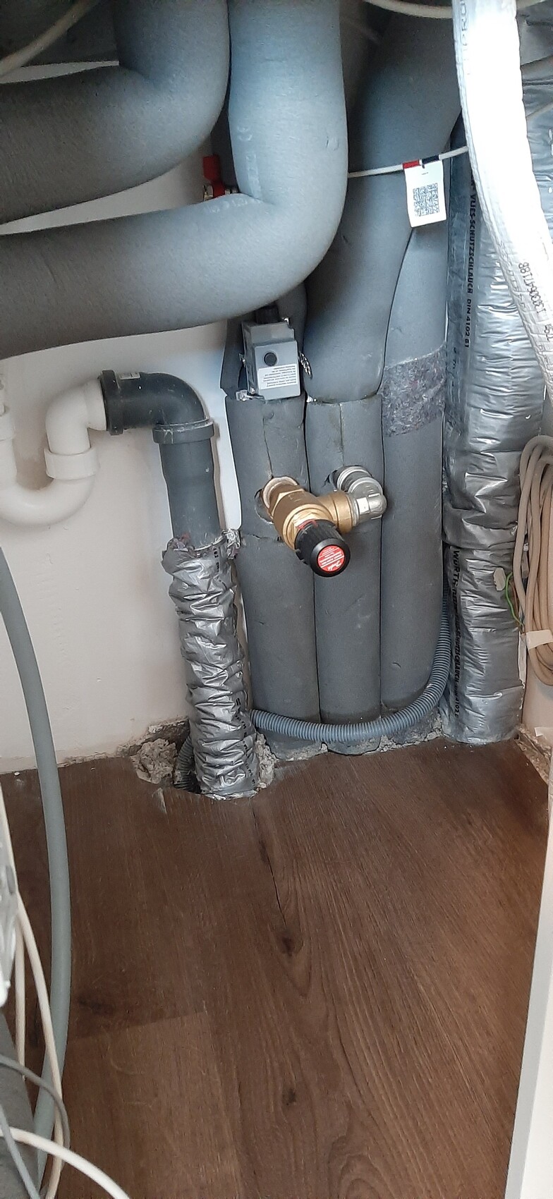

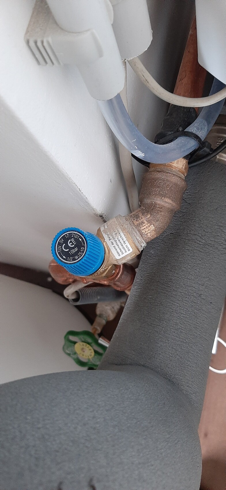

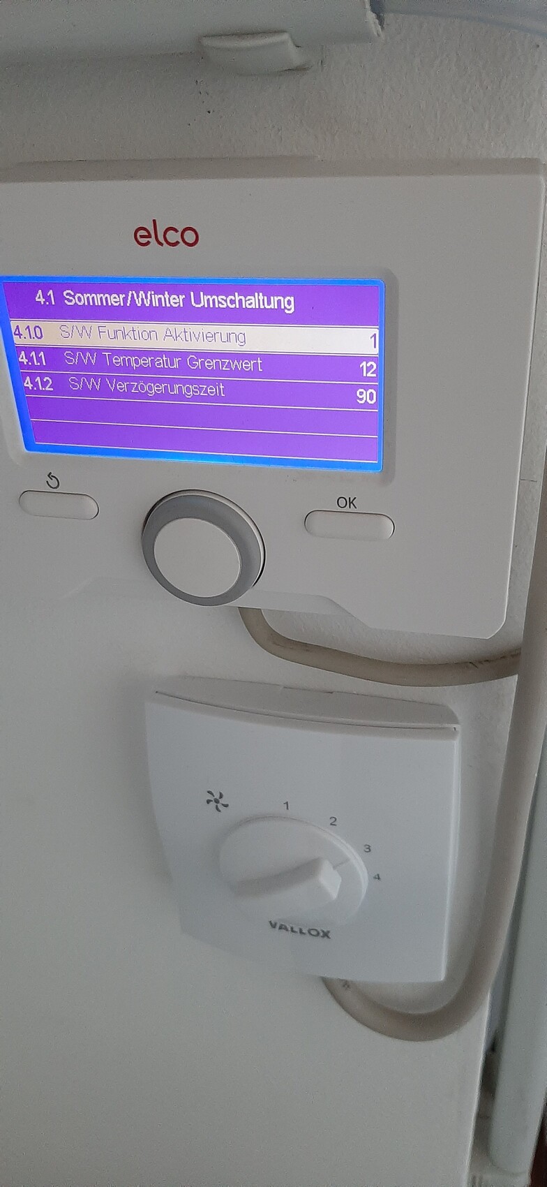

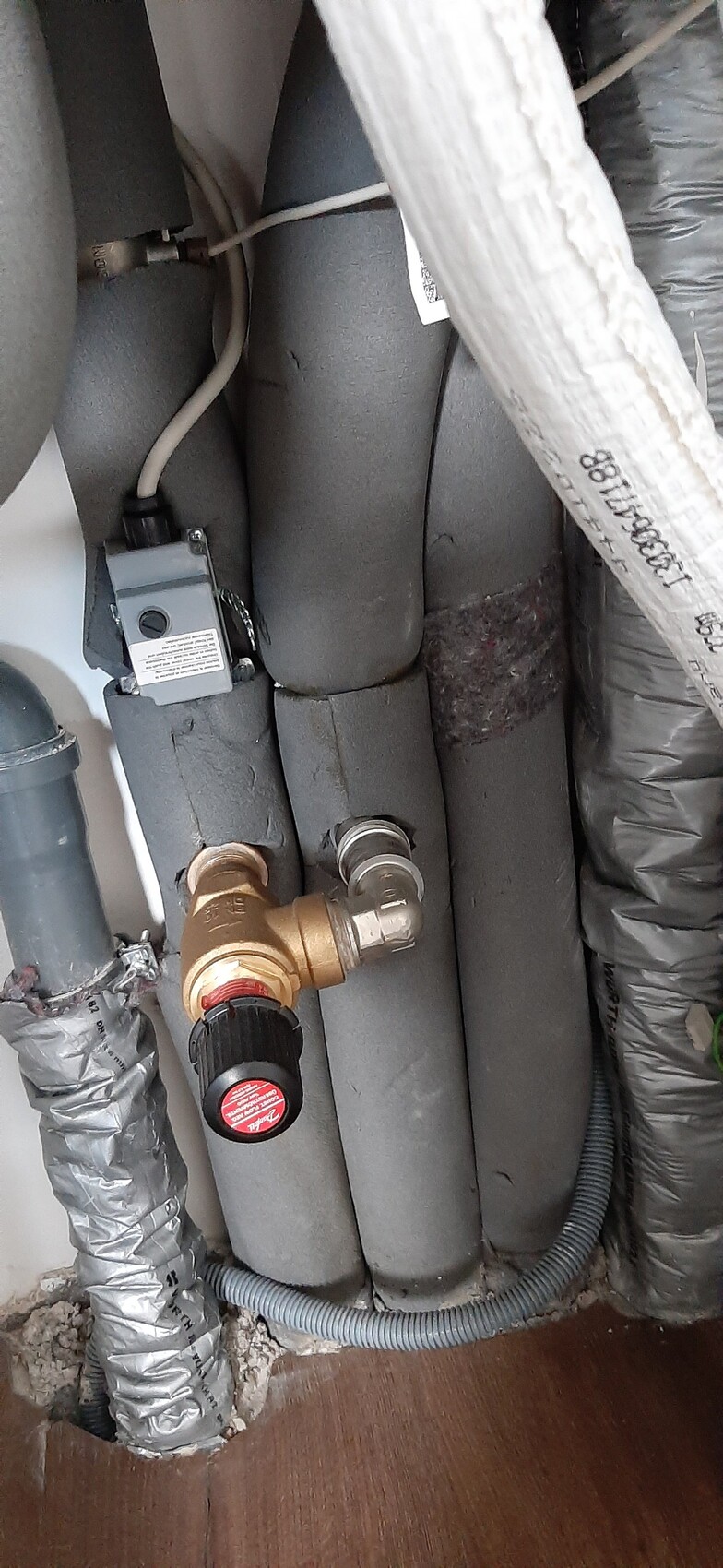

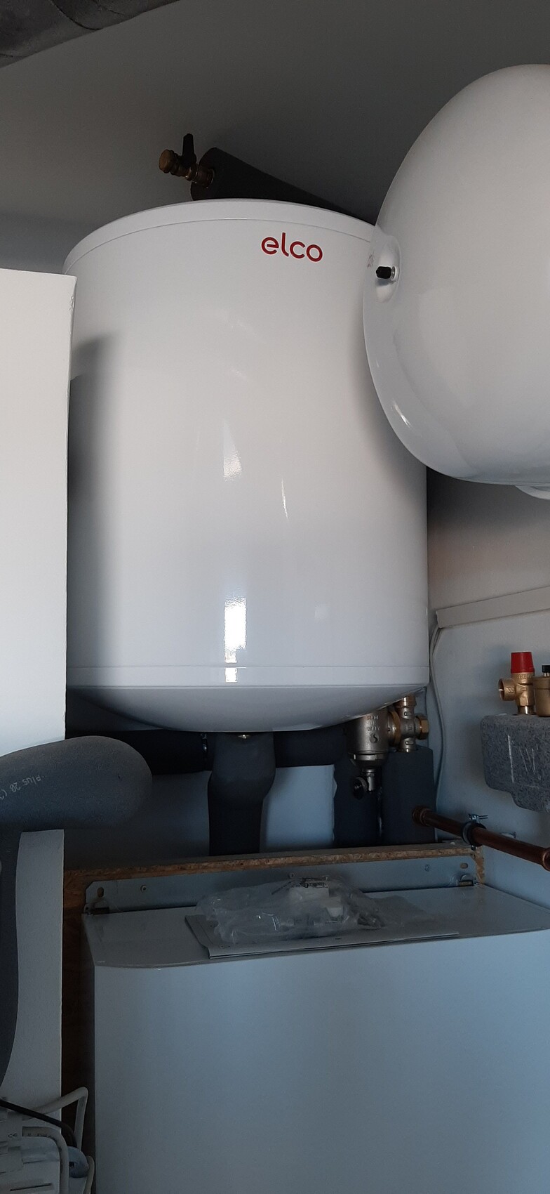

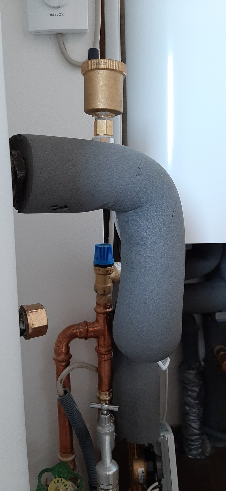

1 Aug 2020 08:55
Here are some more pictures.
Heating system with insulated gray pipe, copper pipes, valves, and control components.
Base structure: insulated pipes, shut-off valve, PVC siphon, flexible pipe, wooden floor.
Copper pipe with pressure regulator and blue adjustment knob in a plumbing system
White Elco water heater with pipes in the heating room.
Brass valve with black knob and red label on insulated heating/water pipes in the basement
Elco heating control with display showing summer/winter switch and adjustment knob.
