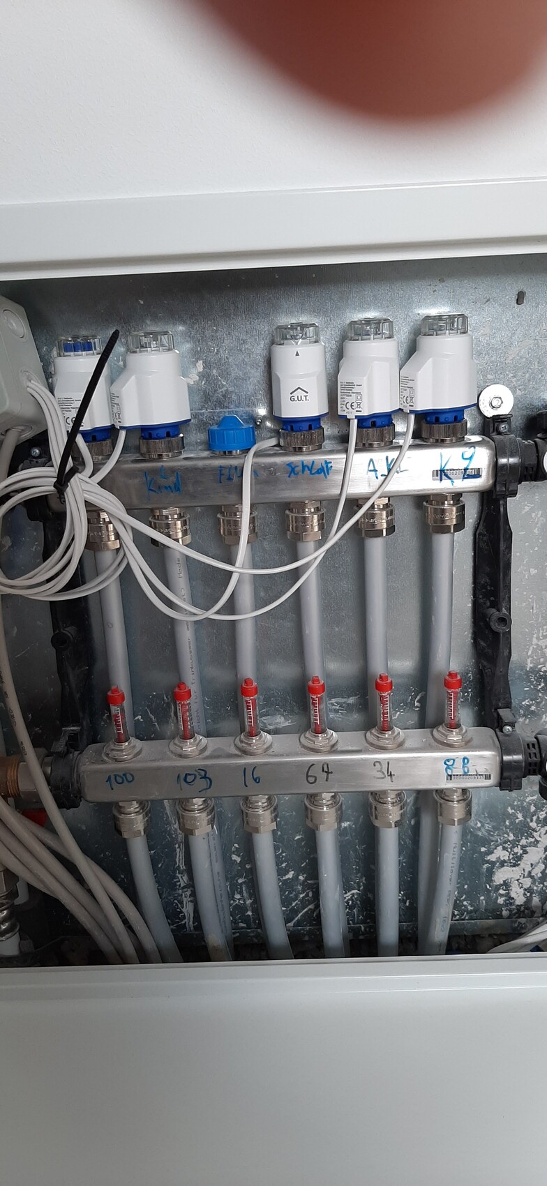

Oh, and something else just came to mind. I had two heat meters installed in our system: one in the underfloor heating circuit and one in the domestic hot water circuit. Both show flow volumes. That means the underfloor heating must be running somewhere, right? The installation on the underfloor heating circuit took place only after the hydraulic balancing. During that process, I was also shown how to set the controllers on the manifold when operating through the ERR.
Here are the pictures of the distributor box upstairs. This also relates to the bathroom upstairs. The float is positioned differently from the others. What does this mean? I would say the pipe is also slightly warmer than the others. According to the heating system, however, it is currently 21°C (70°F) outside.
Regarding the flow temperature, I can't find a display. I can adjust it on the heat pump, but only by a bar scale of about ±7°C (±12.6°F). The actual temperature itself is not shown to me. Shouldn't there be a display on the pipes?
