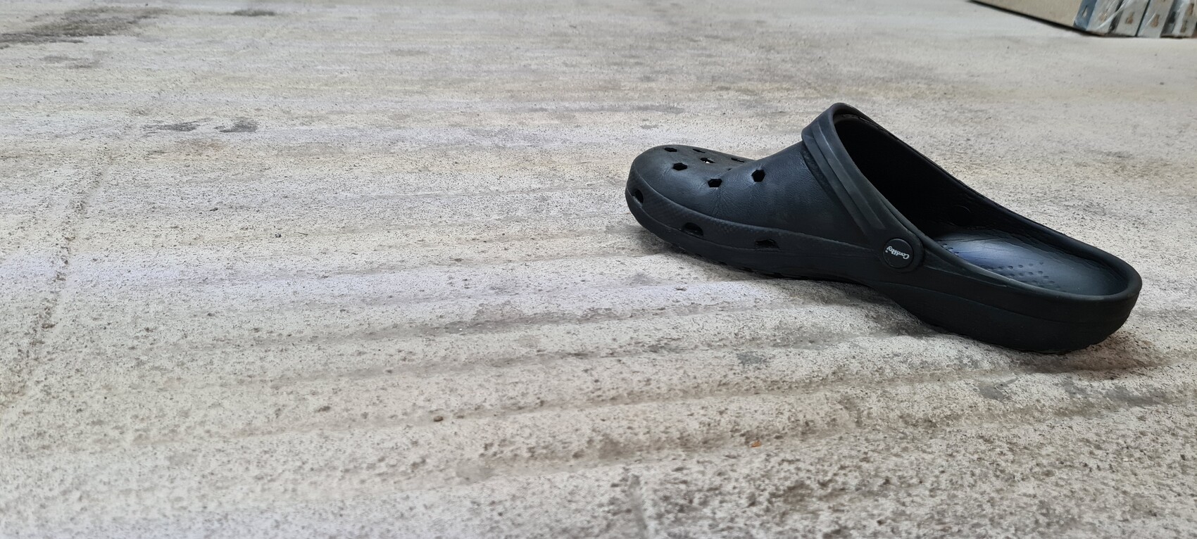

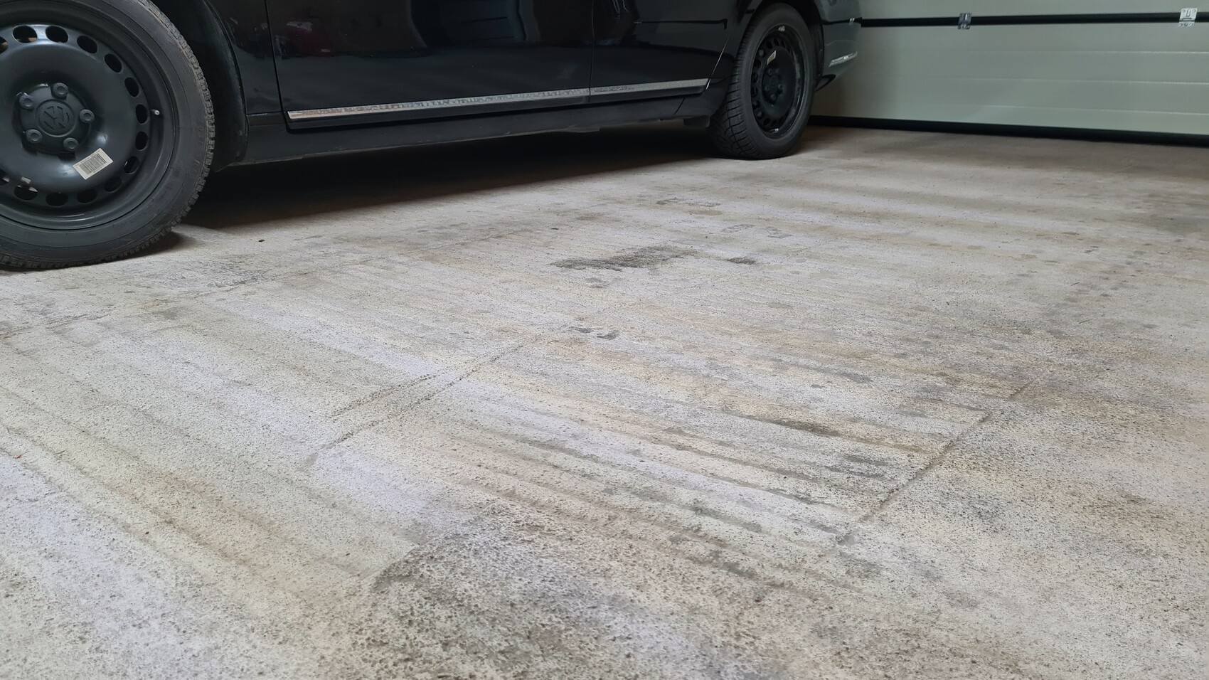

regu123
13 Apr 2022 22:20
Here are the requested photos
A single black Crocs shoe lying flat on rough concrete floor.
Black car in a garage, underside with wheel visible, concrete floor with stains.
gutentag14 Apr 2022 08:07
The only thing I can think of is self-leveling screed or leveling compound. Or does the garage have a slope?
Otherwise, some people tile the garage.

Thank you for your reply. I am concerned that leveling compound would not support a car jack, motorcycle stand, or axle stands. Or do you see it differently?
What could I put on top of the leveling compound to make it more durable? PVC covering?
Tiles are unfortunately not an option for financial and aesthetic reasons. By the way, the garage is 54 square meters (581 square feet).
rick201814 Apr 2022 09:31
I would not recommend a completely smooth surface. When it is wet, it becomes slippery.
Self-leveling compound, industrial floor coating is best applied with aggregate to prevent slipping.
