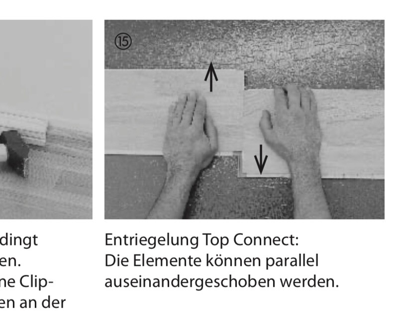

I found this during a Google search… (as of the end of the installation instructions)
Both hands slide wooden parts parallel to each other to unlock the Top Connect.

Thank you, yes, I found that on Haro as well. Unfortunately, it doesn’t explain how to remove this type of finished parquet flooring without damaging it. Sliding the pieces apart sideways is no longer possible...

I assume you need to fold up the entire row at once (for long sections, it’s best to do this with two people). After that, slide apart the individual boards of that row.

I guess you have to fold up the entire row at once (for long distances, it’s best to do it with two people). After that, slide the individual boards of that row apart.
Correct. That works.

No problem. It slides out very smoothly with Haro.
