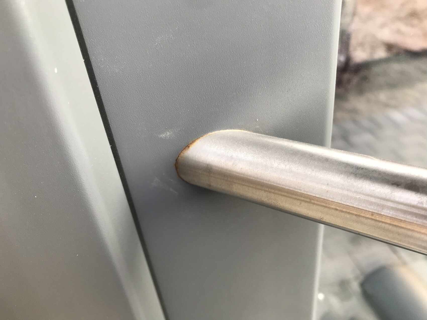

ᐅ How to remove surface rust from a stainless steel door handle?

blaupumaWhat material is the gray area made of, where the handle is attached? Is the handle mounted on top there, or is it continuous?
The corrosion can have several causes. It looks like crevice corrosion, meaning the design with the gap prevents the protective oxide layer from forming due to insufficient oxygen, so even stainless steels can corrode there. Humidity in the air is enough for this to happen.
If the pipe rests on the gray area, it could also be that the material was contaminated during processing, for example by tools that had already been used on rusting steel.
In any case, the handle should be removed and the corrosion eliminated by grinding/polishing, then the area should be passivated if possible. This can be done either with stainless steel pickling paste (expensive and toxic) or with cola/lemon juice (no joke).
Afterward, keep the area as clean as possible. If it was only contamination, it should remain rust-free in the future. If it is truly crevice corrosion, then occasionally treating the spot sparingly with a maintenance oil may be necessary to remove the medium required for corrosion (moisture).
