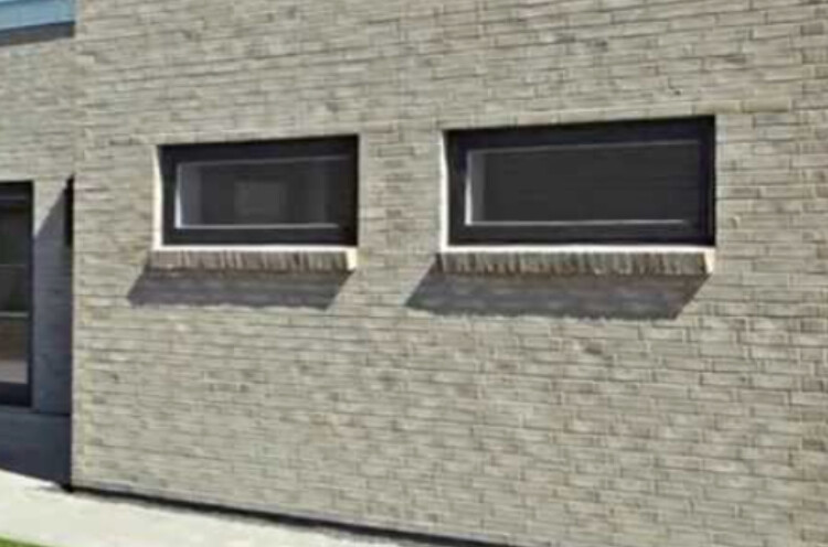

Hello, we are getting horizontal lintels (the opposite of soldier lintels). Does anyone know of any good methods besides prefabricated lintels?
My builder wants to use galvanized angle irons. I keep hearing that lintels tend to crack.
Thanks to all.
Two small, narrow windows in a light brick wall
