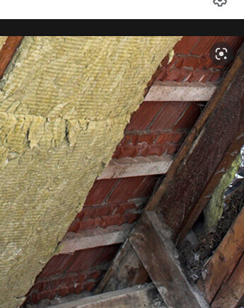

We have an old pitched roof without insulation. The space up there is intended only for tenant storage. The top floor ceiling, meaning the floor of the attic, will of course be insulated as required.
My question is: Should I just leave it as it is; should I install a boarding between the rafters; or maybe just tack in an underlay membrane?
I would prefer to avoid strong drafts up there.
Does anyone have helpful tips?
Roof structure with yellow insulation between wooden beams and brick wall

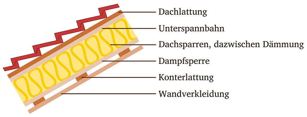

As a landlord, you should be more concerned than just having an underlay membrane to prevent drafts. Most of the energy is lost through the roof, so it needs to be done thoroughly and correctly. Even if the ceiling of the top floor is already insulated. Anything less I don’t consider future-proof, especially regarding energy consumption requirements. Right now, on your attic floor, the outside temperature equals the inside temperature. Especially in older buildings, I would use every possible measure to retain as much heat as possible INSIDE the building.
Cross-section of the roof structure with insulation, vapor barrier, underlay membrane, roof battens, and wall cladding.
