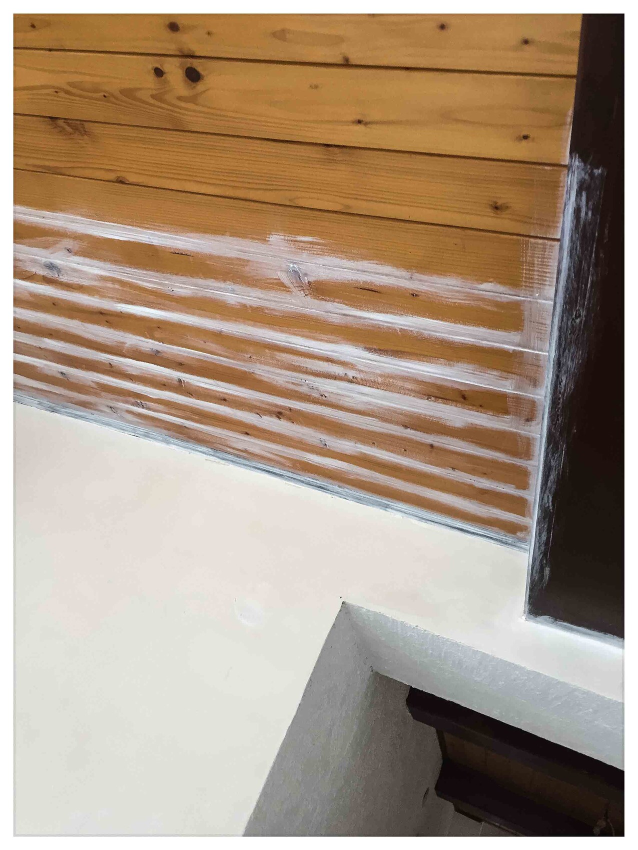

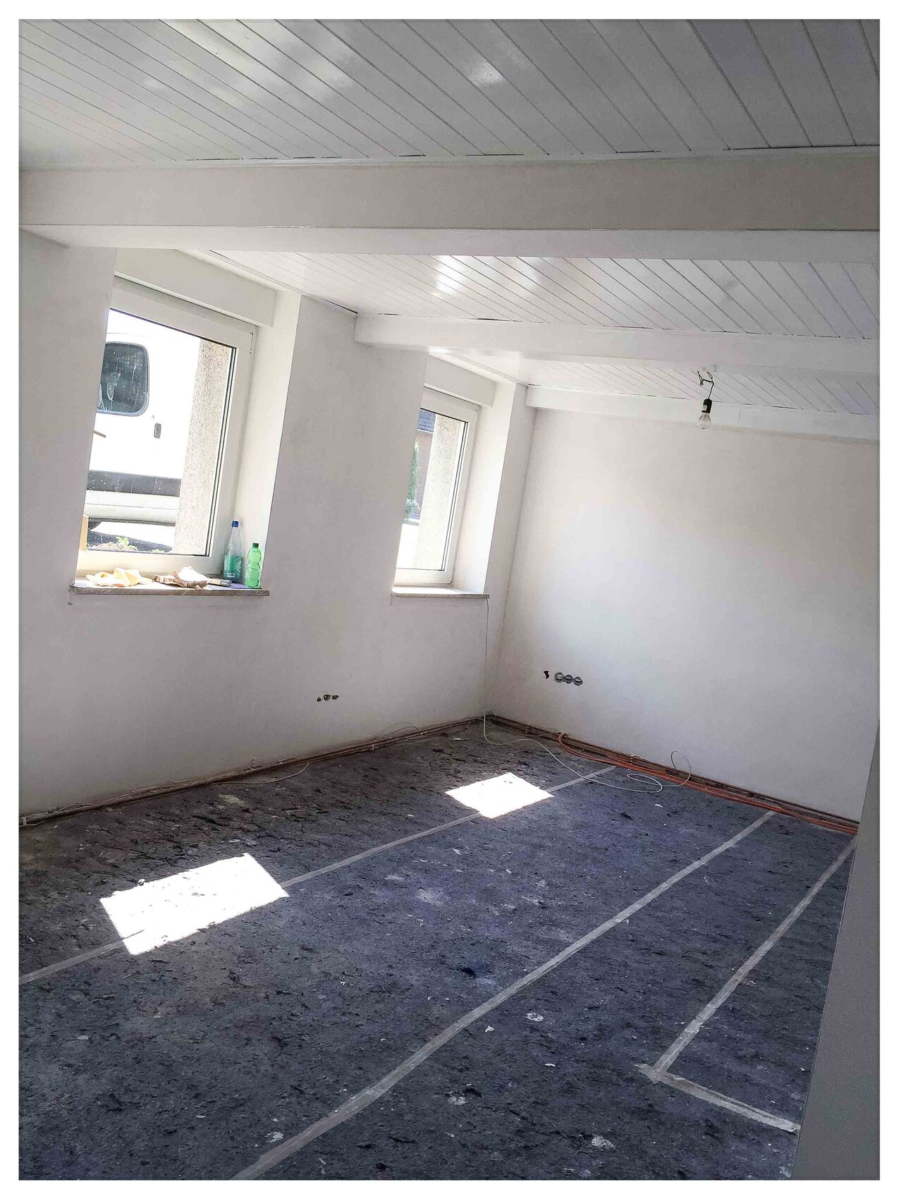

I didn’t sand beforehand but did apply a primer. I worked section by section; rolling in strips wouldn’t have worked because the paint dried quite quickly, leaving little room for corrections. First, I painted the groove with a flat brush for about 5 strips, then primed the strips with a short, smooth synthetic roller; this reduced unwanted drip marks.
For the final coats, I followed the same process but applied two coats, working in opposite directions each time. Some areas could have used a third coat, but I gave up by then. After weeks of removing wallpaper and what felt like endless painting, I’m now hiding a few imperfections with lighting tricks.

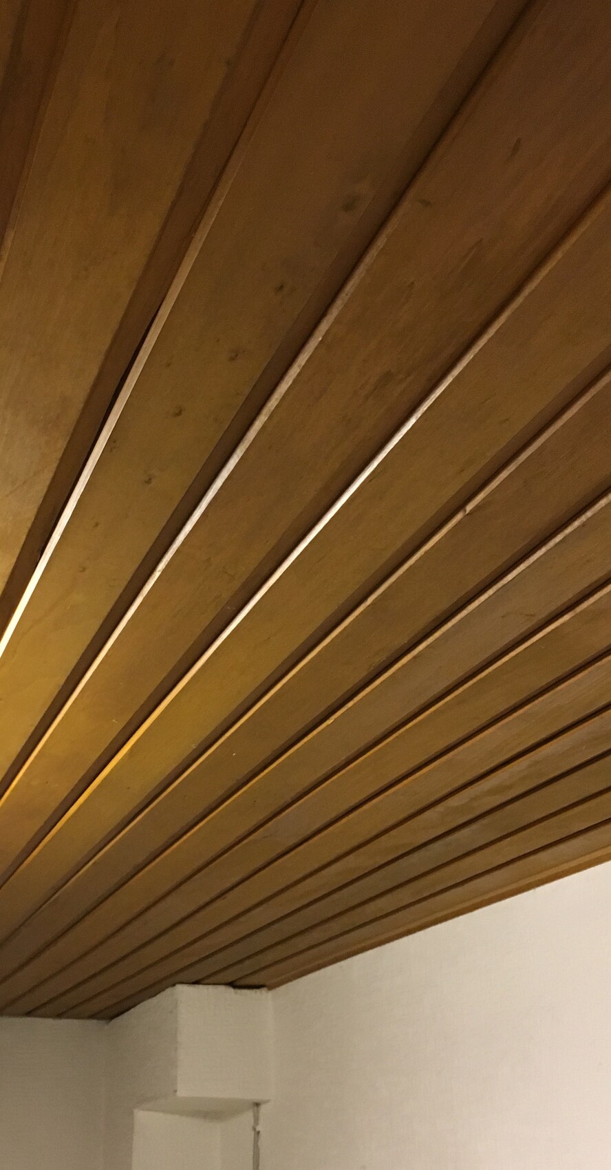

I want to paint this ceiling white.
How should I proceed?
Sanding
Priming
2 coats?
Or what do you think?
