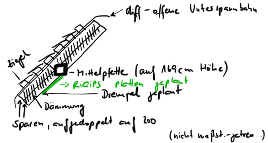

See the sketch ... gypsum boards are now to be installed under the intermediate beam, above the vapor barrier. Since we have already set the profiles for this, we noticed that a panel lifter (borrowed from OBI) can only work at a height of 150cm (59 inches) and above.
So how do we lift the boards with two people – this is really a technical question – so that they fit flush at the back with the knee wall and align properly under the intermediate beam? It needs to fit neatly ...

do you plan to add the knee wall later? If so, I don’t quite understand your issue, because you could simply continue the panels at the bottom without having to be exact to the millimeter. Later, you can build the knee wall in front of it, and you’ll have a neat finish at the bottom.
