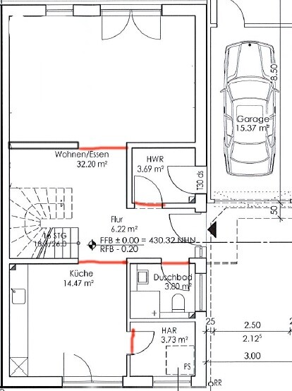

how would you lay the tiles (wood look, 30x120cm (12x48 inches))? Across or along the windows?
The tiler suggests laying them across because of the expansion joints (cement screed), while the floor installer recommends laying them along the windows to avoid glare, which is also common practice with parquet and laminate floors.
The expansion joint in the kitchen and living room could be better concealed by laying the tiles across.
Additionally, the tiler advises a maximum grout offset of 20cm (8 inches) because all tiles are basically slightly uneven.
What do the experts say?

Points to consider:
Point 1: If you lay the tiles perpendicular, the joints will be more visible. This is something to consider depending on what you value.
Point 2: Using an expansion joint would be the most practical solution from a craftsmanship perspective.
Point 3: Regarding aesthetics: the direction of the layout can influence how the space feels. For example, narrow rooms can appear wider.
In smaller residential buildings, you can seal the expansion joint with cork or epoxy resin. We consulted our heating specialist about this, and he did not see any issues with the different heating circuits.
By the way: nice floor plan for a semi-detached house. Did the load-bearing wall between the hallway and the living area have to be there, or was that your preference?

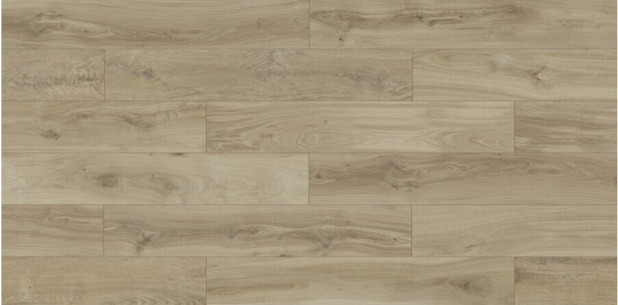

What do the experts say? I can’t really contribute as I haven’t made this decision yet, but could you share what type of tile it is? I really like the look.
Schnigger13 Jul 2022 15:13La Fabbrica Il Cerreto, color Chardonnay.
