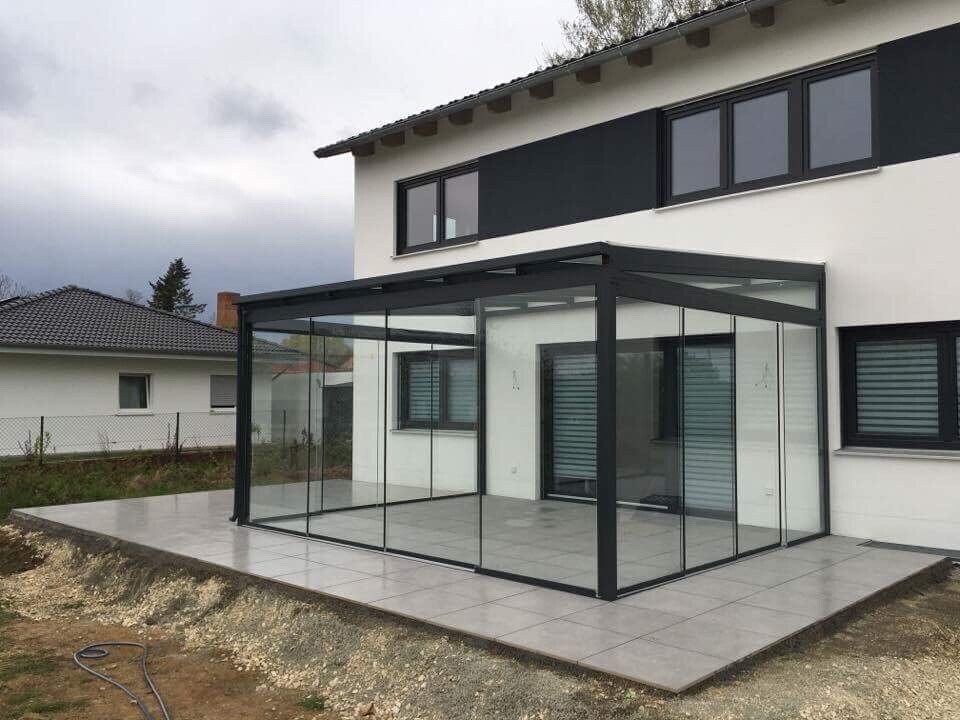

After discarding the idea of pedestals due to many negative opinions, the question now is about the best installation method. We are working with 2cm (0.8 inch) porcelain tiles in a 60x60cm (24x24 inch) format. The subbase is currently 40cm (16 inch) compacted 0-32mm (0-1.25 inch) aggregate.
But if you ask 10 people, you get 10 different opinions.
We were offered:
1. Installation in a screeded concrete bed, grouted with a flexible joint sealant. Advantage: no weed growth, easy maintenance. According to a landscaper’s experience, there is a risk the tiles might shift or loosen in frost conditions.
2. On a gravel bed: the cheapest option, but likely to have long-term problems with ants and weed growth. Cannot be cleaned by mopping.
3. Gravel bed with flexible joint sealant: as above but without the disadvantages. According to another landscaper, this is not common practice. The joint would not hold.
4. Bonded to a concrete slab: the most expensive option, very difficult to modify or renew later. Hardly feasible now, since the subbase is already too high and the terrace roof is already installed.
What are your experiences?

daniels8727 Jun 2017 08:29We have now installed the slabs in a single-grade concrete mix, with permeable joints.
