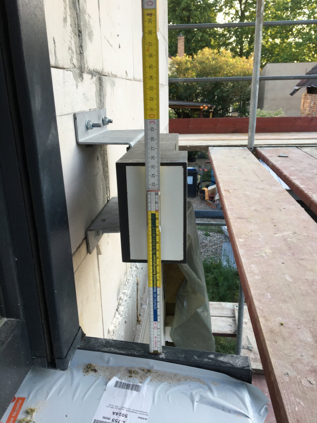

11 Mar 2023 08:10
Exterior wall with wall bracket and vertically tensioned tape measure at a construction site.
We had a similar situation; try searching for Dosteba load-bearing brackets, for example. This way, you get an anchoring point in the insulated facade system (EIFS) at the window reveal. But be careful, these items are not exactly cheap. We installed 4 pieces on each of 2 windows, but it’s money well spent for safety!
