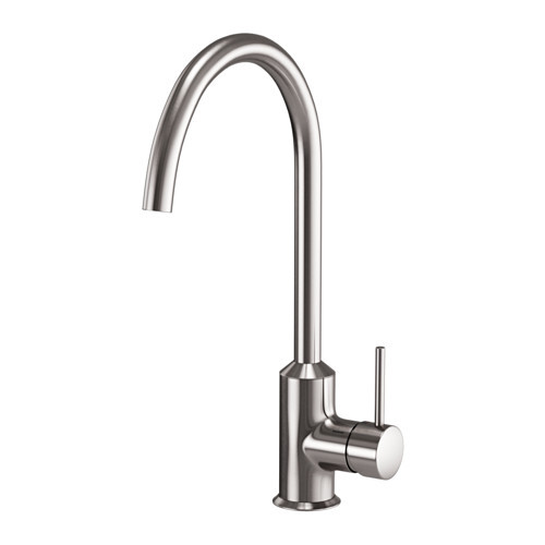

assamerer20 Jun 2010 12:04Hi
Why not the "Ringskär" then?
It has a different handle but also a long spout and no pull-out spray.
Includes a 10-year warranty. More details in the warranty brochure.
Mixer tap with an aerator to reduce water flow while maintaining pressure, saving water and energy.
The cartridge with hard ceramic seals/discs withstands high friction during temperature adjustment.
The high faucet is convenient for washing large pots, etc.
Installation must comply with local building and plumbing regulations. Please seek professional advice if in doubt.
Mounted through a 35 mm (1.4 inch) hole in a countertop or sink up to 50 mm (2 inches) thick.
Tool for easy installation of the mixer tap included.
Aerator rated at 8 liters/minute (2.1 gallons/minute) – saves energy and water.
Includes hoses with 3/8" fittings. Hose length: 35 cm (14 inches).
The mixer tap is suitable for pressure systems. Tested for water pressure up to 16 bar (1600 kPa). Recommended operating pressure: 1.0–5.0 bar (100 kPa – 500 kPa).
The swivel spout is set for 360° rotation but can be adjusted to 90° or 120°.
Care instructions
Do not use steel wool, abrasive powders, or sharp tools that could scratch the stainless steel surface.
Clean with a soft, damp cloth (water and mild dish soap or detergent solution).
Wipe dry with a soft cloth.
