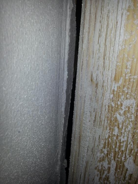

Expanding foam could be an option, but is that the right application and does it provide a lasting solution?
Is it not possible to plaster the 26 cm (10 inches) depth afterwards where there is a 1–2 cm (0.4–0.8 inches) large gap?
Thank you, Jörg

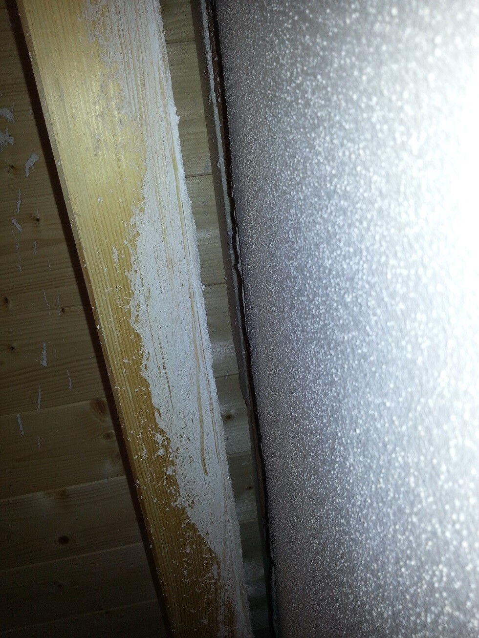

I have now attached clear photos again :-)
The gap is 2 cm (1 inch) wide on one side and about 4-5 cm (2-2 inches) wide on the side shown in the picture
Wood frame in shell construction with insulation and building material surfaces on the interior

Hello, what are you using to insulate the other rafter bays? I would use the same material, for example, glass wool. Then, of course, apply a vapor barrier with a loop and the necessary adhesive from a tube to seal it to the wall. You should be able to bridge the 2-4cm (1-1.5 inches) gap with the substructure that you use to hang your ceiling.
Regards, Achim
