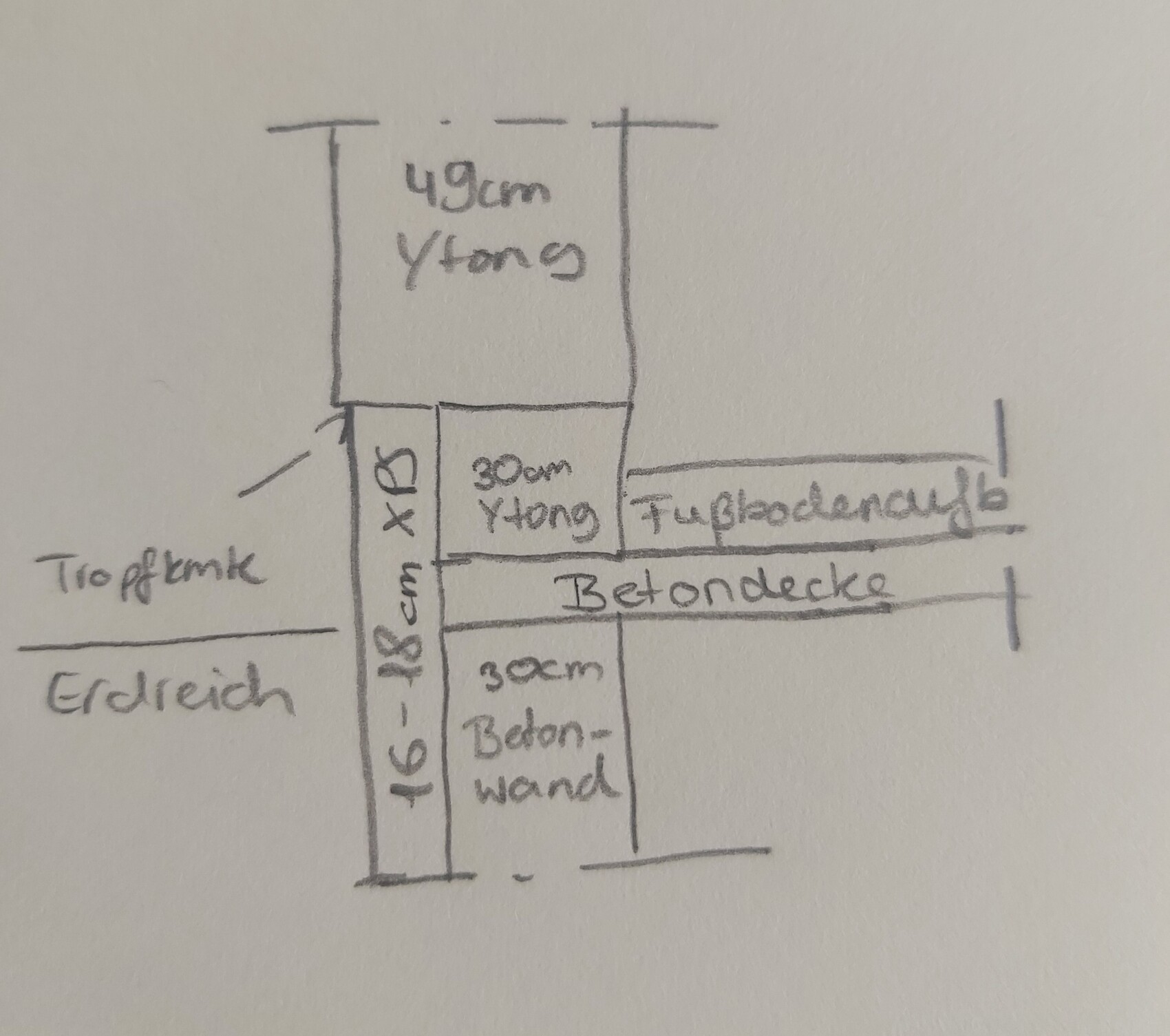

That’s a good start! What does the architect/site manager say?
Attached is a sketch that seems more logical to me:
Hand-drawn building sketch: soil on the left, concrete slab, floor structure; cm dimensions (49, 30, 38).

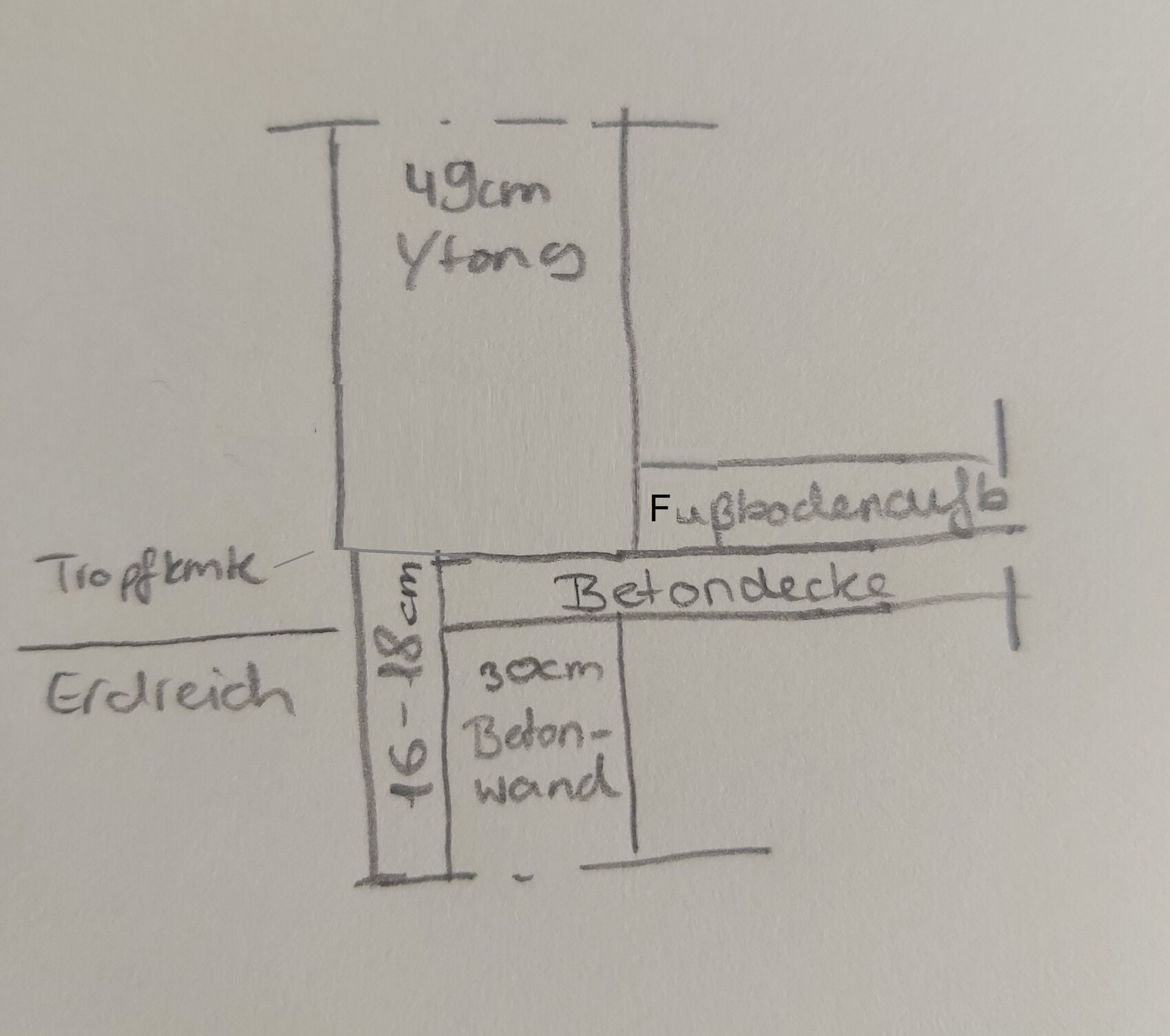

annab377
21 Aug 2020 10:56
The structural engineer’s office is still on vacation for about two more weeks. I have just been thinking about it myself and wanted to hear your opinions.
Thanks @vanny2705 for your drawing. What are the advantages of the smaller Ytong block? Why not like this?
Hand-drawn sketch of a building: ground floor, concrete ceiling, vertical wall; 49 cm (19 inches) wide.
