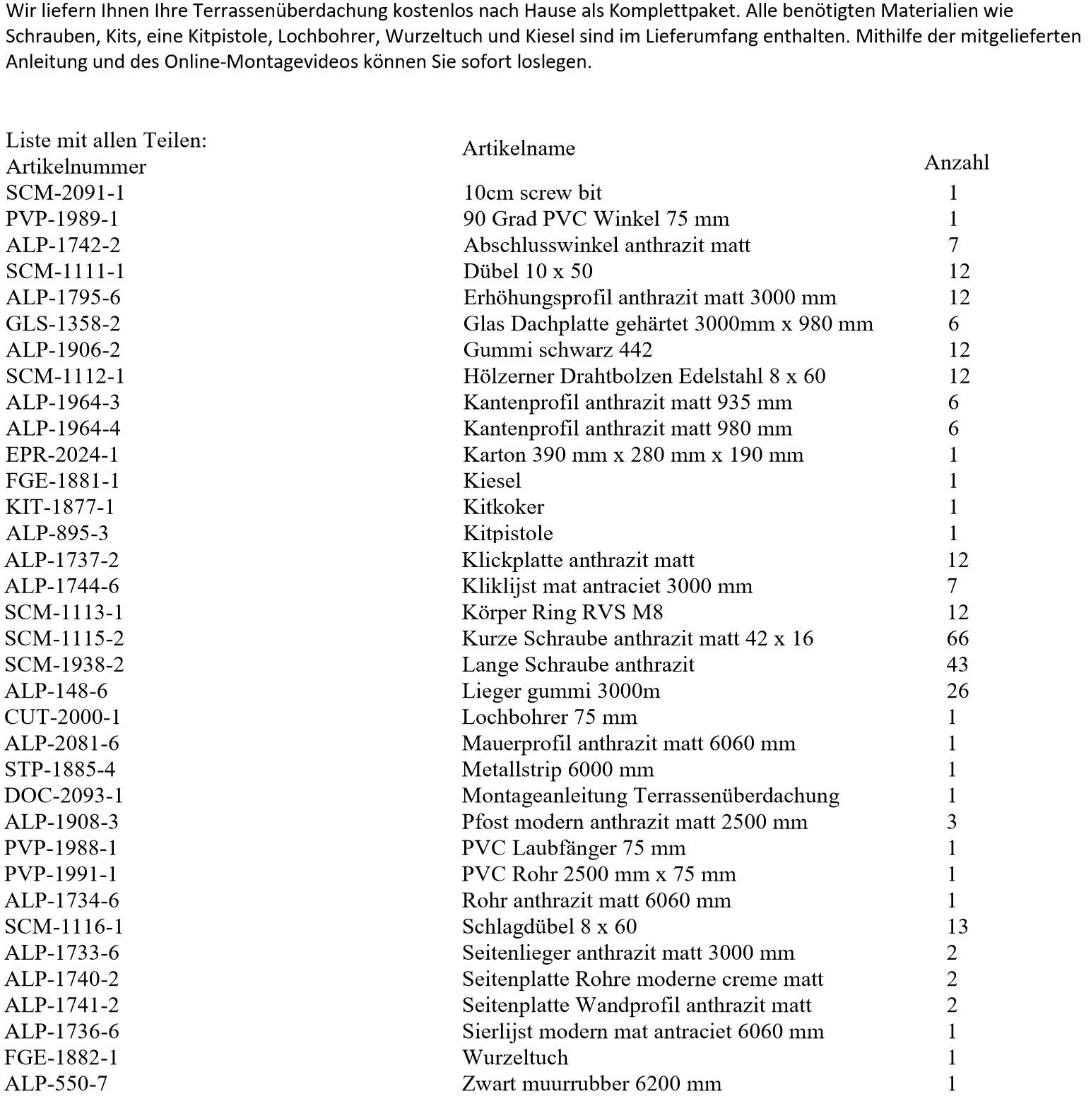

According to the delivery list, I will receive 12 stainless steel wire bolts, 8 x 60mm (0.3 x 2.4 inches).

I ordered a 6x3m (20x10 ft) aluminum frame canopy with glass from the Netherlands.
To save costs, I will have to do the installation myself.

Hmm... maybe they really are enough? Additionally, there are 3 posts...
The parts (see delivery picture) will only be delivered next week.

"The screws included, which you receive from us, are sufficient to fix the wall profile."
I am still quite skeptical whether this is really true. Are such short screws really enough? *scratching head*
