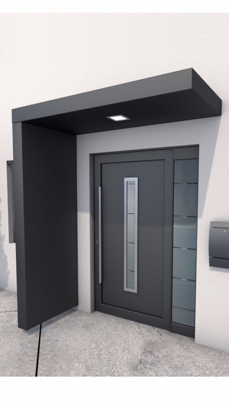

Hello everyone.
Since we won’t have a brick entrance area, we have been looking for suitable canopies for the front door.
We especially like the integrated lighting and built-in mailbox for the overall look.
Because the lower part of our house will be clad with facing bricks, I gave some thought today to how to mount the canopy.
According to the assembly instructions, it should be firmly attached with 12 mm (1/2 inch) anchors.
Can a brick veneer wall support this? Or will I have to worry about snow or other loads?
The canopy is 2.5 m (8 ft 2 in) long and approximately 1 m (3 ft 3 in) deep. Depending on the conditions, it could hold quite a bit of snow. I don’t even know how heavy the canopy itself is yet.
I would really appreciate any practical experience or advice.

hampshire5 May 2019 09:45If the side wall, as shown in the picture, does not rest on the ground, it will definitely be too heavy.
If it were my house, I would anchor the fastening all the way into the wall, not just into the brickwork.
hampshire5 May 2019 10:30The main challenge is wind load. If the side panel can also be anchored into the ground, that is already half the battle.
