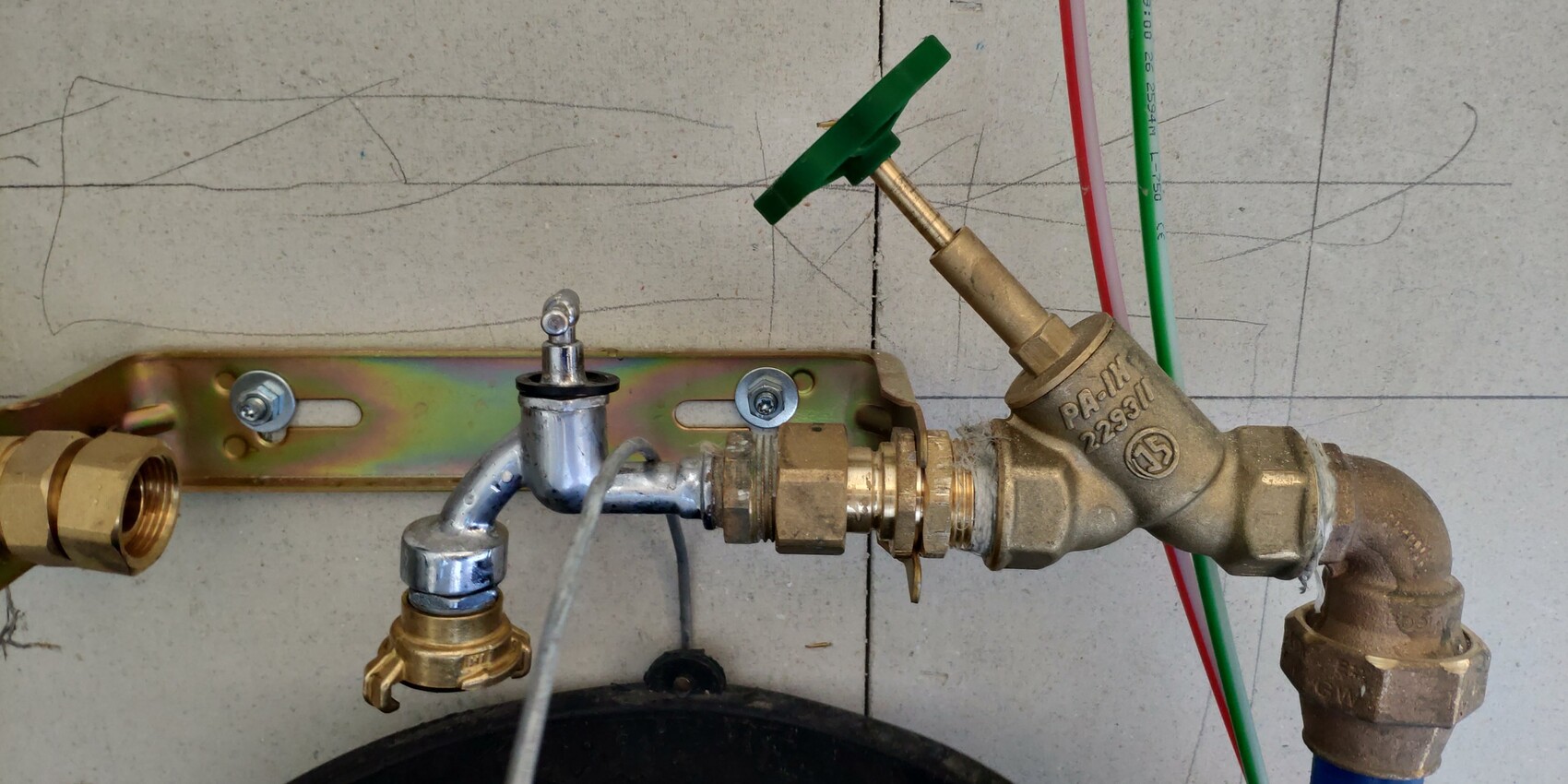

I have a somewhat urgent question. Our screed is scheduled to be poured on Friday. The main water line from the street enters the technical room, connected at the bracket but without a meter yet. Just behind the main shut-off valve, there is a tap installed.
The screed contractor connected the silo mixer to this tap. Both valves are fully open, but not enough water is coming through. The silo mixer requires 2000 liters per hour (530 gallons per hour).

Caspar202030 Jul 2018 12:06KingSong schrieb:
Connected to the bracket but without a meter yet. A water tap is installed just after the main shut-off valve.Normally, the water meter goes into the bracket. What is there now? Is the water tap still before the bracket? Could you please take a photo?
