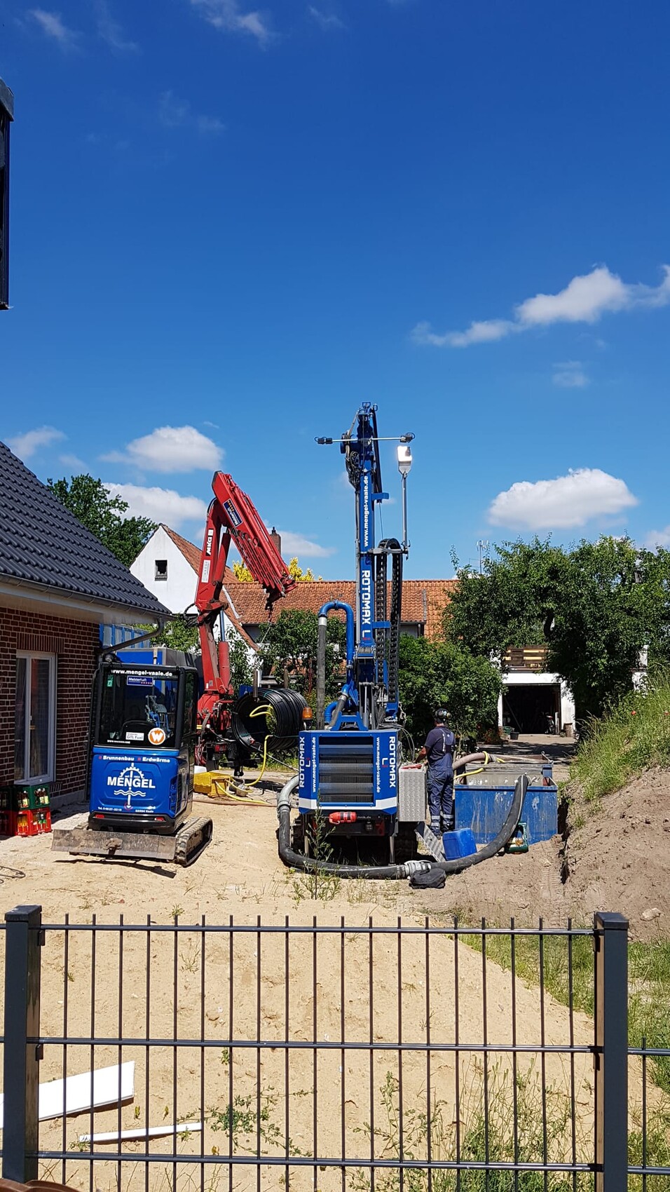

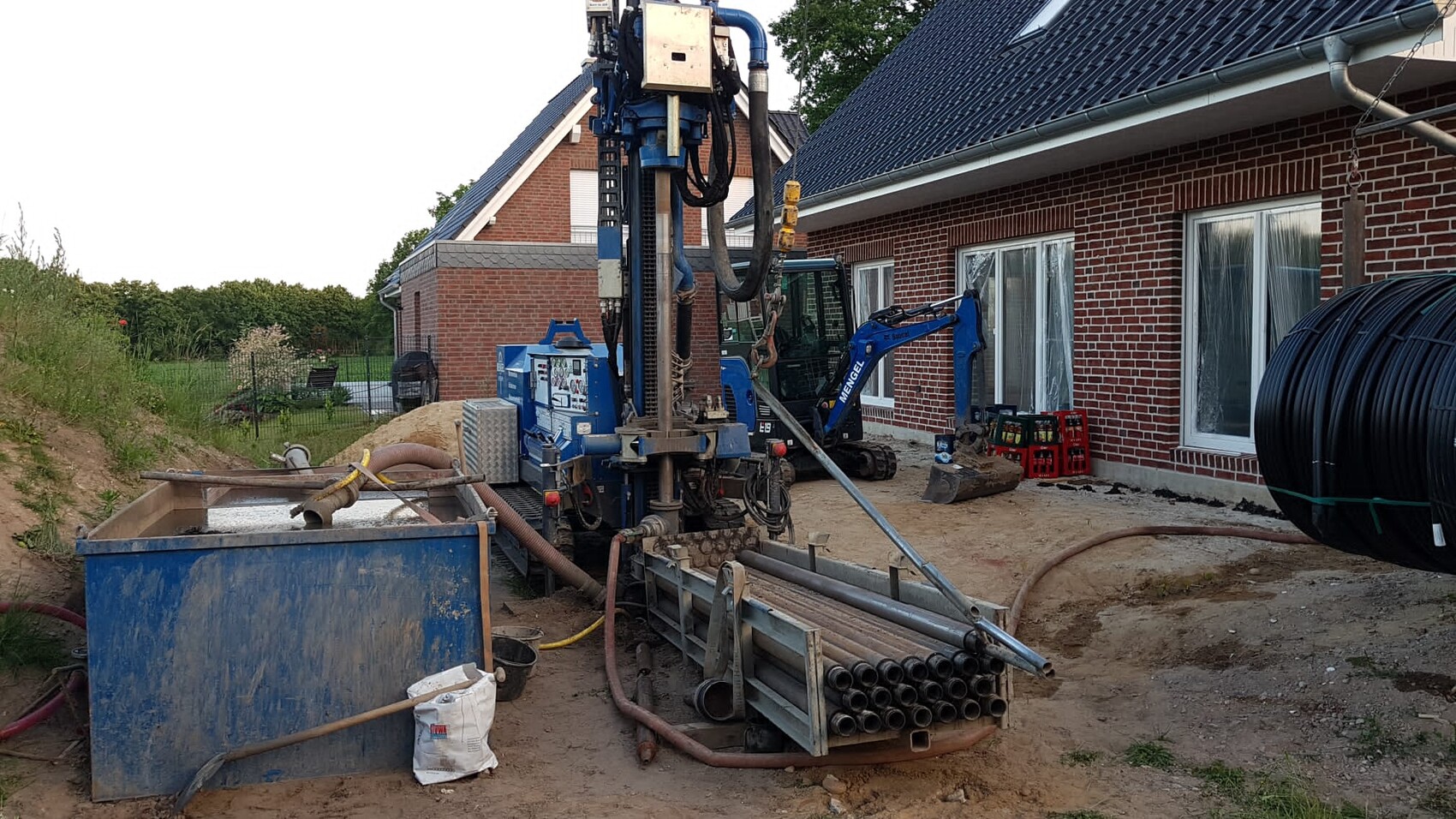

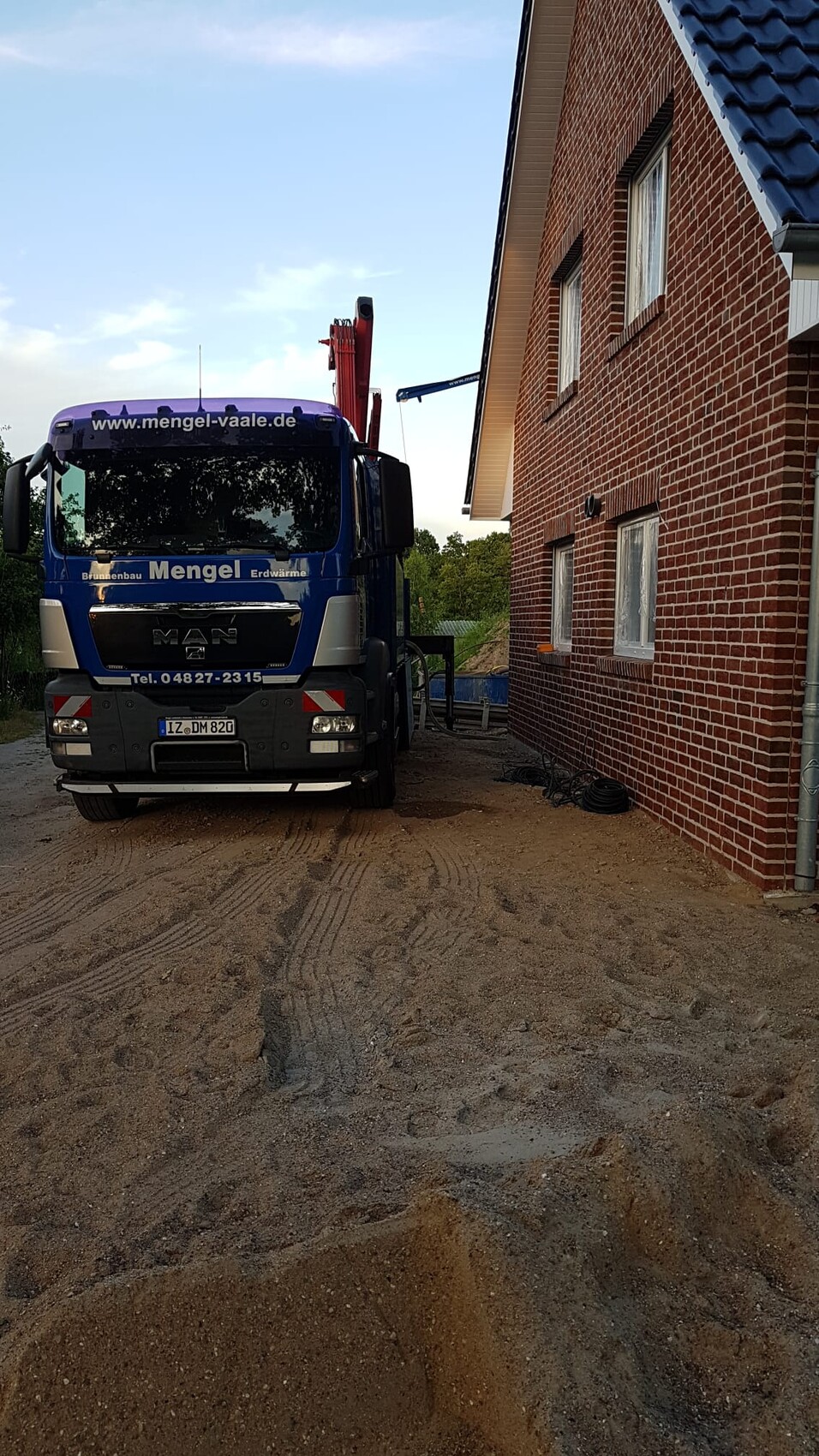

WilderSueden1 Aug 2022 14:56The drill hole itself requires almost no space. It’s just a pipe buried underground that leads to the utility room.
However, you do need space for the drilling operation. The equipment is large: drilling rig, wheel loader, truck with containers for the drilling mud…
Here is a picture: https://www.hausbau-forum.de/threads/haus-bilderthread-zeigt-her-eure-hausbilder.14011/post-578884
And yes, the flowers in the front garden probably won’t survive.

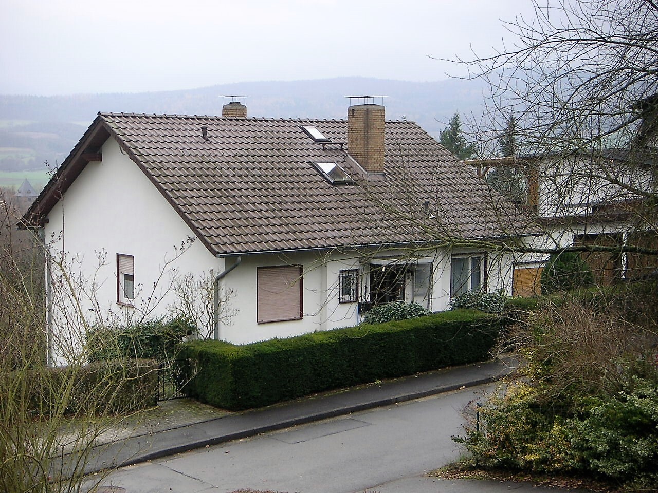

At the moment, I only have this picture, which shows the front garden from one side.
At the other end of the street-facing property, there is a garage forecourt for two vehicles, which offers a bit more room for maneuvering.
I think the main thing to consider is the machine that actually does the drilling because it needs to be positioned exactly where the hole is supposed to be.
Most of the other stuff (waste and so on) can probably be arranged cleverly somewhere without completely blocking the narrow street.
WilderSueden1 Aug 2022 15:36You can certainly create space by partially or fully closing off the street. However, if you do this in the front yard, a section of the hedge will have to be removed. This is probably less work than tearing up the driveway pavement.
Where is your utility room located? Ideally, drilling should be done as close to the utility room as possible. After all, you still need a trench leading to the utility room and a core drilling.
