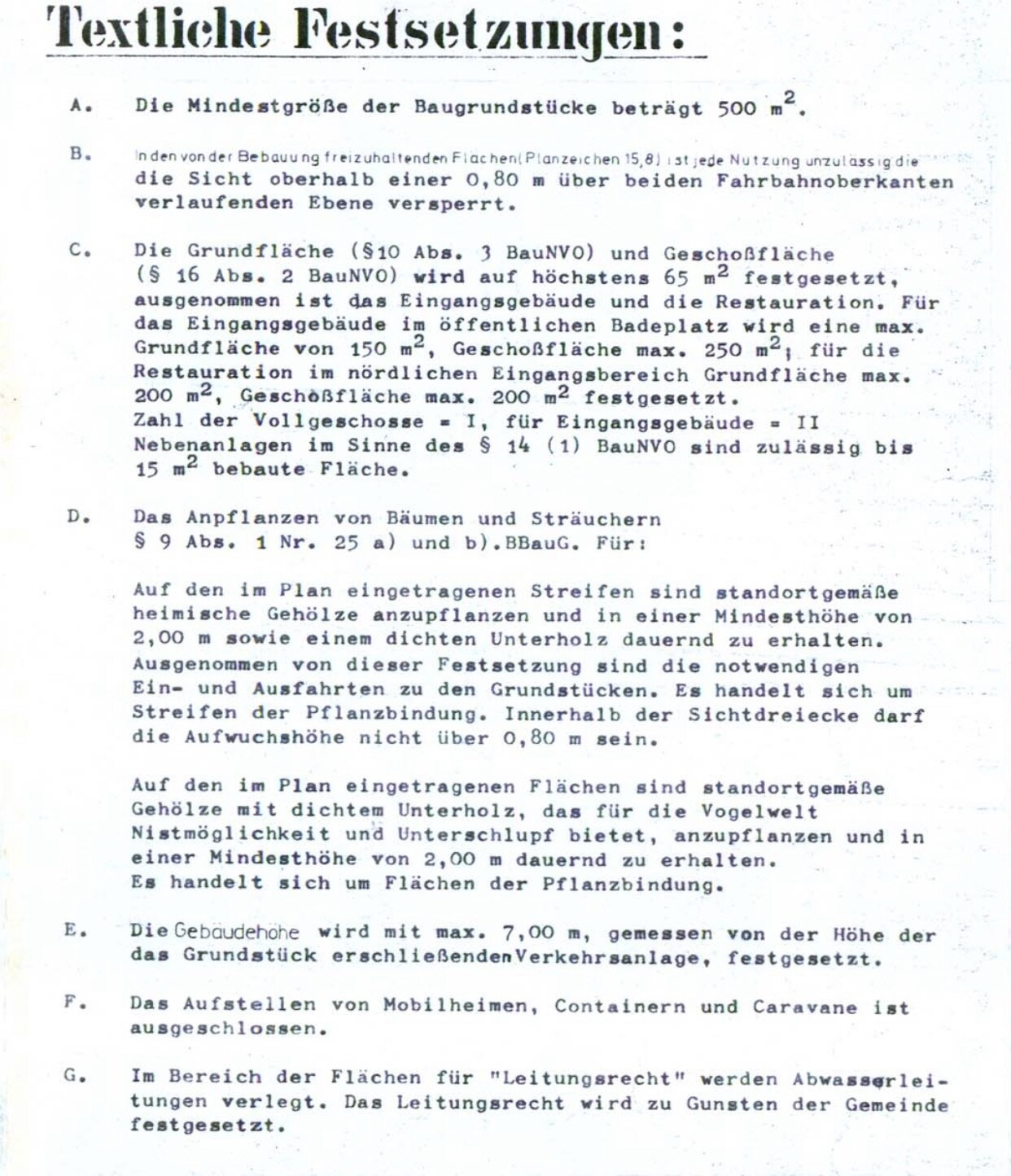

Development plan provisions:
Myrna_Loy22 Jan 2022 11:52The question is, assuming there are no other regulations, whether it would be allowed to place a two-story 7 m (23 ft) high cube with a footprint of 5 x 6 m (16 x 20 ft). 🙂

The area is a recreational zone, therefore a special use zone. Exactly, and within this special use zone, you can fulfill your residential building request.

The question would be, if there are no further regulations, whether it would be allowed to place a 7 m (23 feet) high, two-story cube measuring 5 x 6 m (16 x 20 feet). 🙂 Myrna_Loy schrieb:
Edit.
According to the written specifications, the maximum footprint and floor area is 65 sq m (700 sq ft). This means that the basement and attic heights must be built as non-living space, which is why the ceiling height is 2.15 m (7 feet). Oh, okay, now I understand.
Unfortunately, there isn’t much information available online.
I only found two articles about single-story construction with limited floor area; in one case, they managed to create living space in the attic by using a set-back story.
Is there a list that specifies what can be done in rooms with a ceiling height below 2.19 m (7 feet 2 inches), such as a boiler room, hobby room, or something similar?
Myrna_Loy22 Jan 2022 16:21In Section 2 of the Model Building Code (MBO), habitable rooms are defined as rooms intended or suitable for the permanent presence of people.
Non-habitable rooms, on the other hand, include storage, utility, sanitary, and other rooms with secondary functions, as well as corridors and stairwells.
