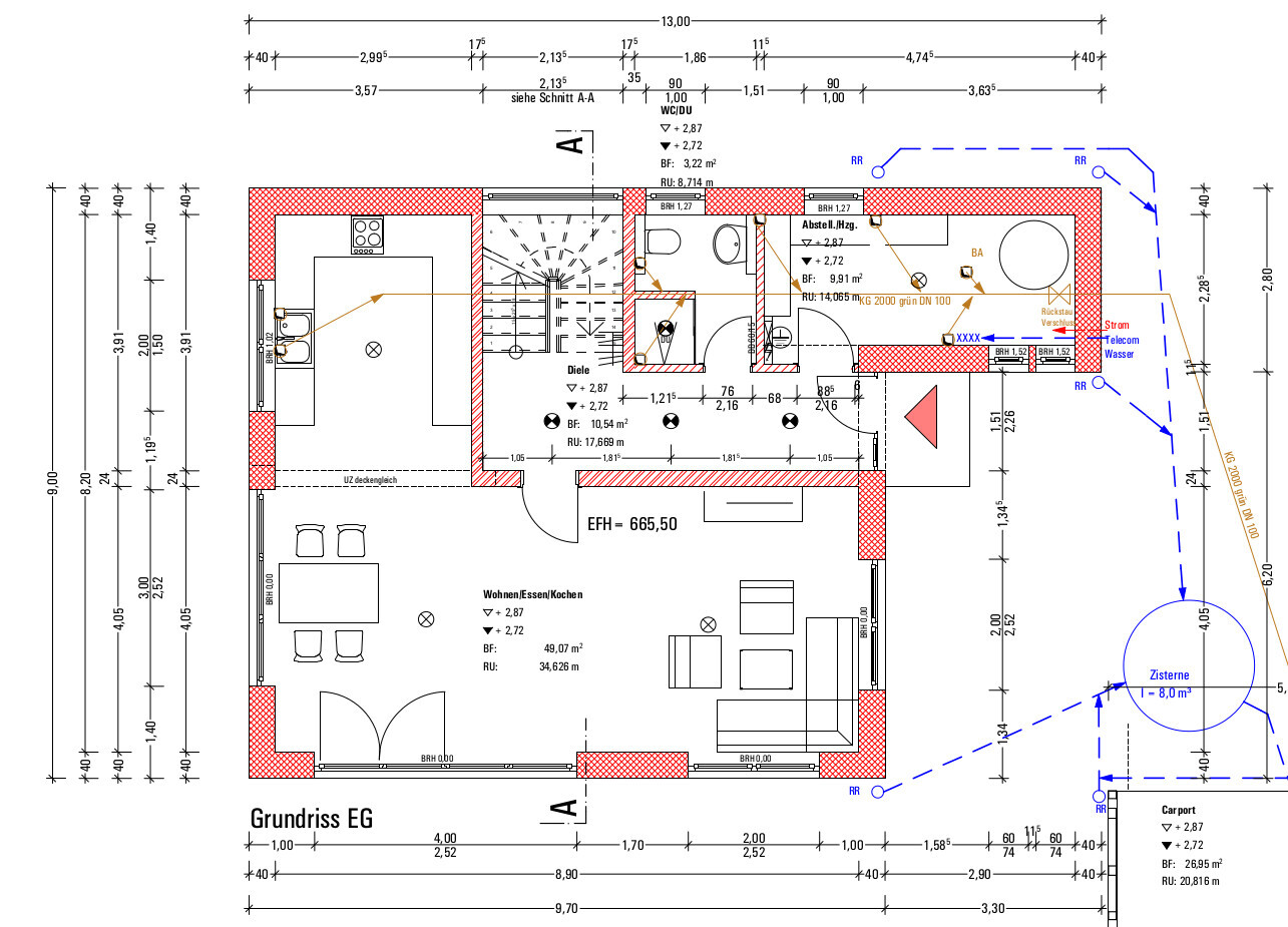

Please show the construction plan. The bricks are 42.5cm (17 inches), so why is the construction plan showing 40cm (16 inches)? How is anyone supposed to verify that?
You should check the dimension chains.

Here is the excerpt for the ground floor. The construction description also states 40cm (16 inches), so everything is consistent within itself. It just doesn’t match the bricks.
Grundriss EG: Küche, Wohnen, Bad, Treppenhaus und Außenzugänge.
