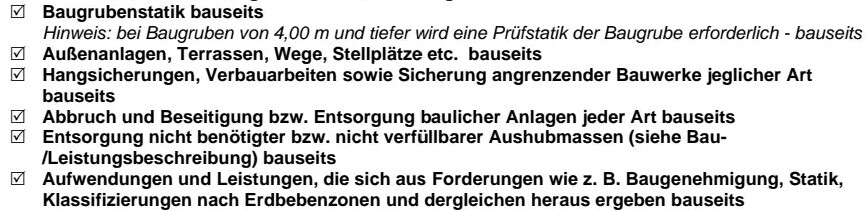

19 Jun 2023 17:48
hanghaus2023 schrieb:
It says "basement according to plan." What exactly does the plan say about the basement?
It’s almost irrelevant, considering how many checkmarks in the offer suggest that it’s included… while in reality it’s only part of the offer.
Checklist for excavation structural analysis and on-site services (demolition, disposal, slope stabilization)
